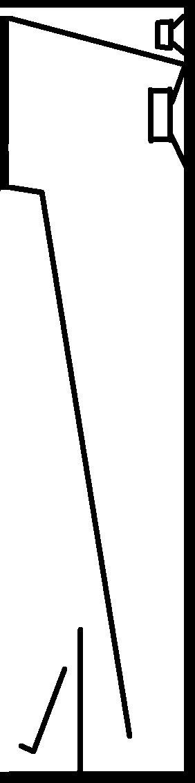

Anyhow, I sketched up the enclosure on paper, and as I don't own a scanner I drew a crude MSpaint mockup of the detailed drawing. Measures are 282mm deep, 1130mm tall and 306mm wide. Front baffle is 24mm ply, everything else 18mm ply. The small floaty bit is the amplifier cover, 8mm ply. Line lenght is approximately 130cm on woofer, 26cm on full range. Both have 1:10 taper.

At all the various measurements xrk971 has published for TC9FD it don't seems a problem for that driver to be front mounted to have nice response, but okay don't know if a front mounted bass drivers frame with close spacing to TC9FD could disturb the performance.
It's not usually the end of the world with full range drivers, as they are somewhat directional. However, I'd guess there will be about 1-2db more wiggle in the frequency response if not flush mounted, and a subjective reduction in image clarity. DIY audio is all about hot rodding and tweaks for best performance, and it all adds up. 🙂

I am making some careful measurements of response of TC9FD and other drivers in a short tapered TL and will try adding a flush mount rebate and felt to see if the 1-2dB wiggle can be reduced. The TL definitely flattens the impedance peak - but that is at fs near 130Hz, more than an octave below where I would XO as a FAST. However, the midrange does seem very open.
Cool. It will be interesting to see your results. 1-2db is only a guesstimate, based on past experience.
Where flush mounting really makes a huge difference is dome tweeters, and I haven't goofed with them for many years.
As the OP intends to use PLLXO, it doesn't matter that much, but any sort of Z peak one octave below a passive crossover high pass will entirely screw it up.

I will post more info later but the short story with the TC9FD: do not rebate and flush mount. The way it is designed it is flatter and smoother when surface mounted. A real time saver for DIY builds with this driver. Kind of silly but I will have to un-rebate the bezel and go back to surface mount.
That info could be a real time saver. If I don't achieve any real benefits with flush mounting the TC9FD, I might as well leave the cork since I'm having such a damned time acquiring it. There is also the problem with the woofer having the surface-mountable frame with only 1mm depth at the edge, whilst the TC9 has 3mm frame depth. Also my friend would prefer the natural wood finish instead of the cork as it "looks too much like an office notice board" 😀

FYI, these are 10:1 taper ratio TQWTs; 1:10 would be a conic [horn] expansion.
