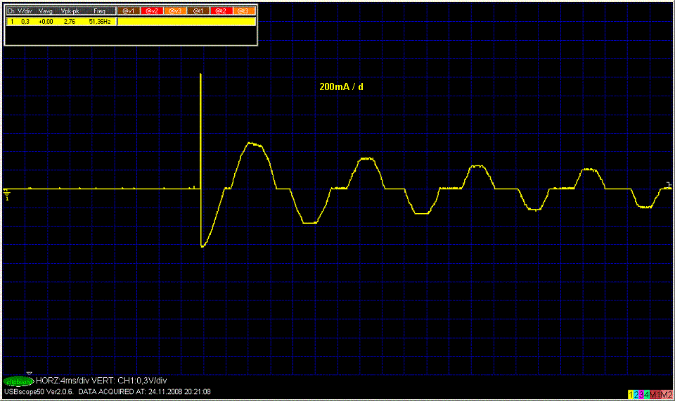

Accidentally, measured initial primary current surge of Talema 15VA toroid 2 x 18V, with PSU and nominal load connected.
