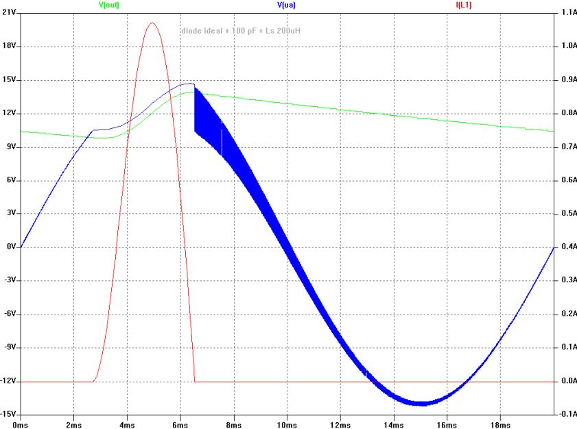

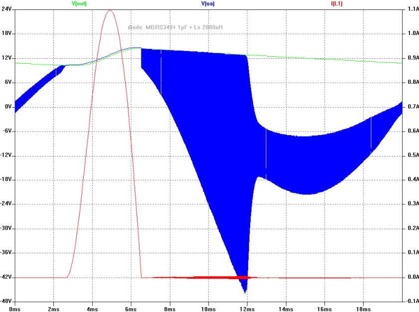

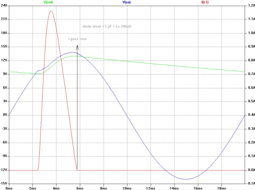

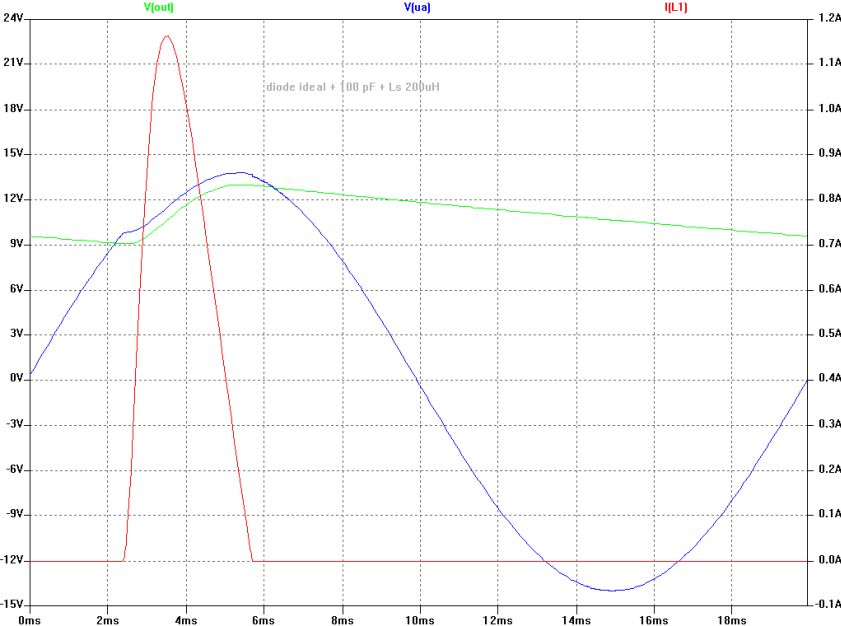

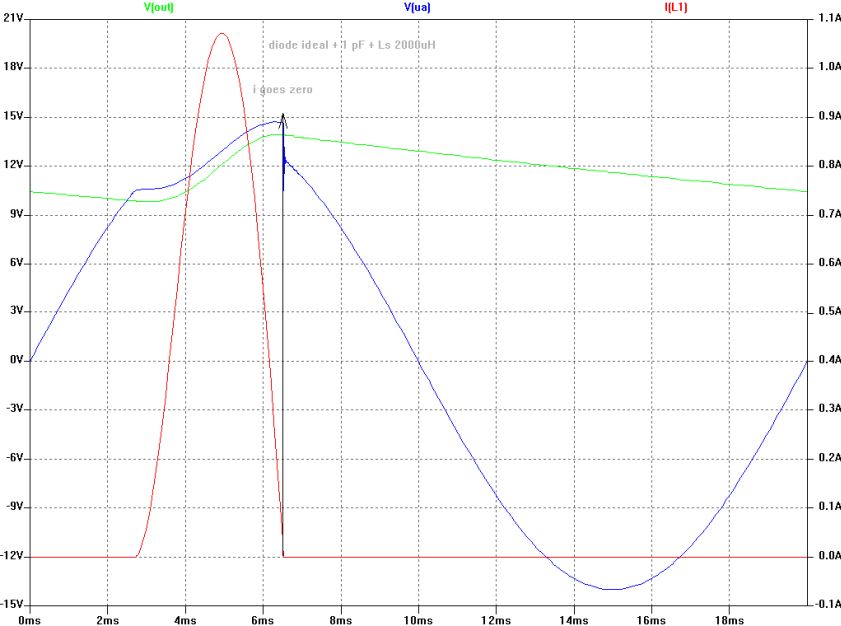

The "excitation signal" is coming from a sudden revers-VOLTAGE
over the diode when in case of a big leakage-inductance (Ls) the diode-current goes zero.
This voltage-jump charges the capacity in the diode. This charged capacitor then starts to "play" with Ls : hf is there!
But from what came this revers-voltage jump?
If a Ls is present the current through the diode lags after the mainvoltage. When current goes to zero the voltage on the anode goes down to the mainvoltage.
Do of this current-lagging the mainvoltage is now already much smaller so the anode steps down:
this is the excitation signal!

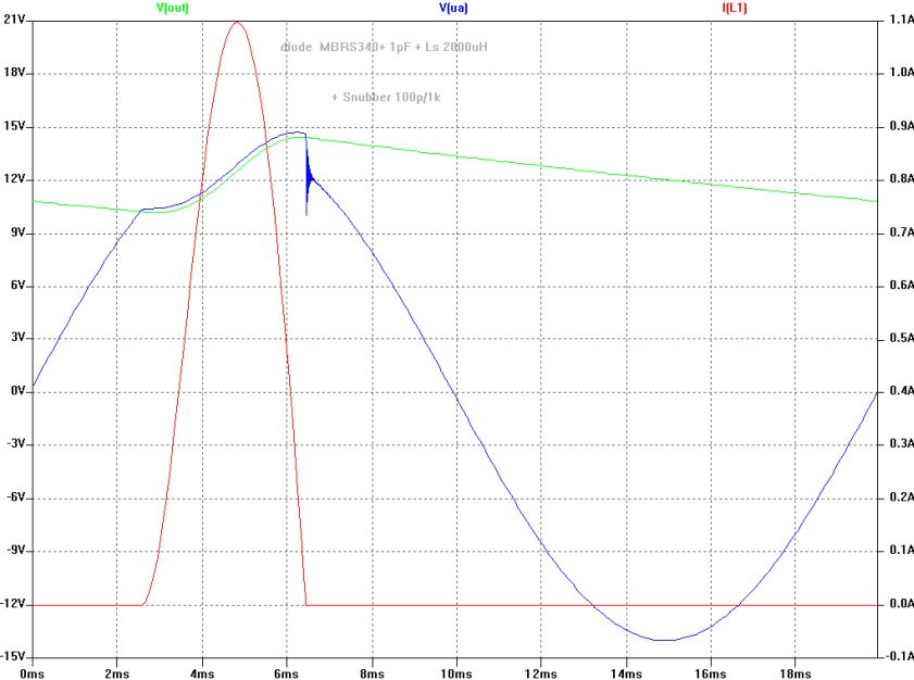

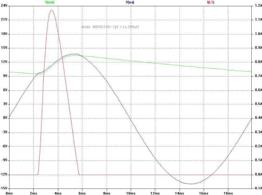

For better clarity I have done some simulations.
I use only the ideal-diode or a On-Schottky from LtSpice.
I think You will agree that in both no revers-current will appear .
Because big attachments are forbidden I must sent some posts.

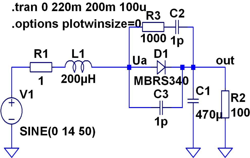

Here you can see the circuit.
These things can hardly be propery simulated because it's very hard to model transformer distributed capacitance and inductance and diode reverse recovery phenomena.
In practice, leakage inductances are somewhat smaller than 2mH, particularly when reflected into the low voltage secondary side, and diode current falling slopes are usually too small to cause enough reverse current to require a faster diode. Remember that reverse recovery behaviour is entirely dependent on the magnitude of the current falling slope.
Don't trust simulations, build some test circuits and chech with oscilloscope instead. Real circuits are just not going to work like simulatons.

Eva,
I agree one should be careful interpreting the simulation results. When I did simulations on this I was mainly interested in the qualitative behaviour, that is, whether such a phenomenon could be provoked at all in a simulation, since it was claimed to exist in reality.
The problem with measuring this is that it seems difficult to measure. I tried using straightforward methods and a plain scope only in this thread

I have no immediate comment to your sims, but I don't think they agree quite with what I got. I don't have any Spice up and running for the moment, so I cannot check what I get with your component values, but your results surprise me.

I replicated heinz sims with similar results. As they seemed real strange I built and measured some real-world circuits:
1000uF 40v filtering cap with 100R load, MBR340, SF4007TFK, MBR160, MR854 diodes at choice.
tranny n. 1:
15VAC appr. 20VA toroid, secondary leakage inductance 0.16mH
Not any sort of oscillation visible on normal 100MHZ scope.
tranny n. 2: black horse of the test 😀 double insulated 2x18VAC 14VA pcb-mount potted E-core?? transformer with Whopping 20mH of leakage inductance. Had to measure twice on lcr bridge to believe.
~100khz oscillation visible at diode turn-off, max amplitude around 10 volts! for 2 cycles. attenuates quicly after couple of cycles.
(even measured third tranny, small 10VA 12VAC AC-AC adapter, 1.7mH leakage)
In all tests all diodes showed similar waveforms exept MBR160 wich burned short-circuit. 😀 Maybe killed it with inductive kickback.
Its also good to notice freq and current of these oscillation in spice. 330khz with 1mA peak inductor current doesnt sound so bad anymore, not much of danger from inductive coupling at these current levels.
