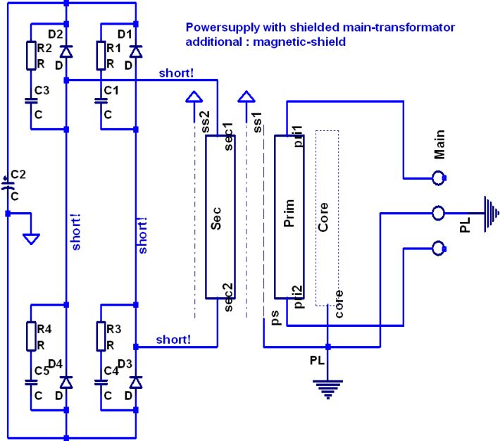

I was pushed by praxis to this problem some years earlier.
I had to design a 400VA current-amp which had to deliver beside 120A RMS also 60mA (in 5 ranges).When the amp put out 60mA I find on the signal riding mainfrequency-spikes. The reason for this we know now and also what to do.
This was some work because the amp was powered by 3 phases and used therefore 12 diodes ,I used the same as Eva mentions!
But this helps not enough : now the spikes on outputsignal get smaller but was`d still visible even I tried a lot!
My chief in this time found at least a (expensive) solution which does its job perfekt : we changed the big maintrans to a shielded one.
Even when I for test cut out my snubber the output stays clean!
Why arent the snubber not successful (enough)?
Well remember the "exciting-signal" is despite damping still present!
But with complete screening it don`t get far!
I must admit that the amp has a floating powersupply which is threrefore very delicate.
(I used a "normal" voltage-poweramplfier but the output was grounded over a resistor and the "ex"-ground of the powersupply is now a current-output)
Since then I know what I had to do when I order a maintrans for sensitive setups. In my drawing one can see how a really good maintrans should built of.
Of course such high outlay is not always needful!

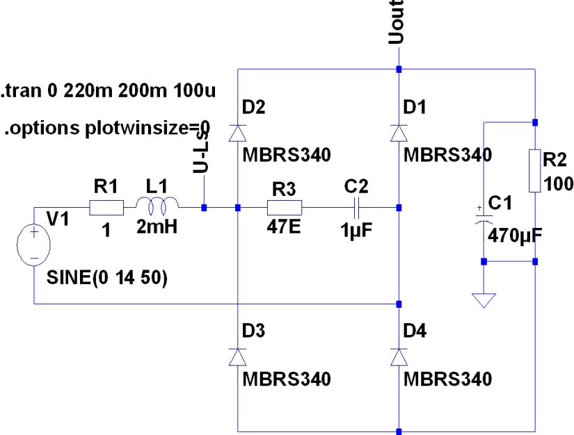

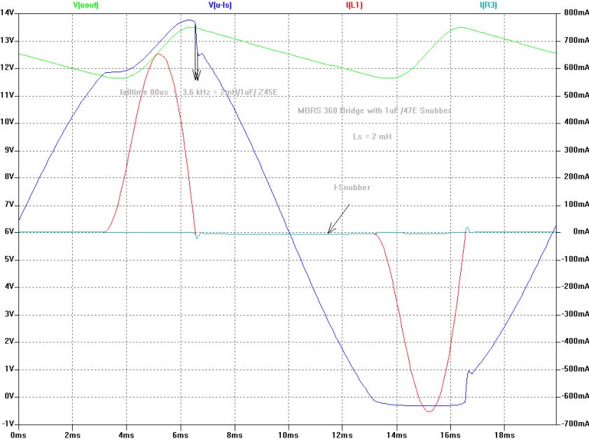

Looks good, go on!
I take now a bridge and try to reduce the aruptness of the "exciting-signal" without too much losses.
It seems to work so that no shielding should be necessary.
Ls is the same 2mH and swing together with 1uF from snubber.
Fres is about 3.6 kHz = 80us falltime.
Resulting Z is about 45E. Damping therefore
with R-snubber = 47E.
Here is the circuit.
