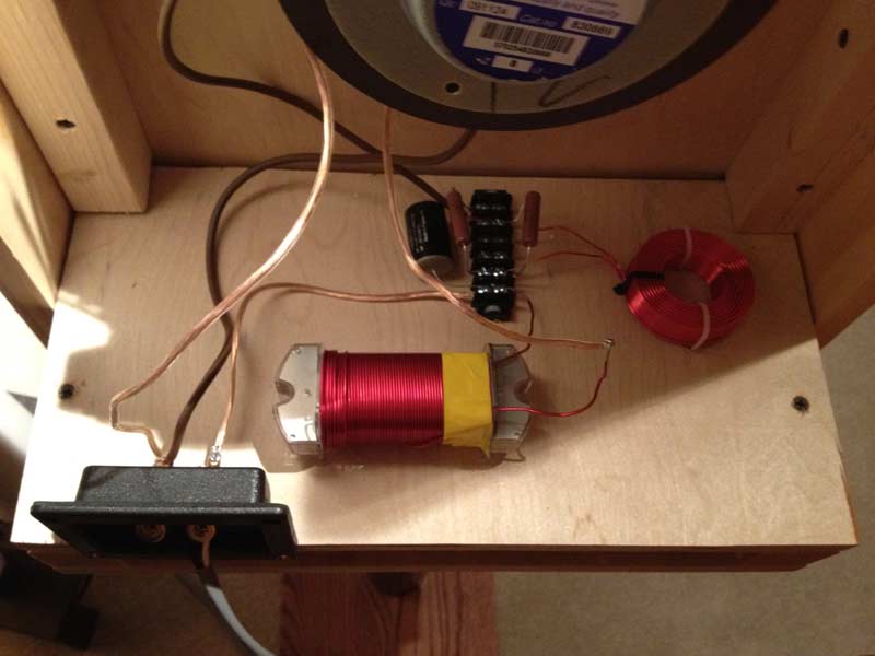

I continue to be really happy with the way my speakers sound (Thanks again John). I have yet to solder everything point to point and was pondering the final layout of the crossover when I notice the leads of the iron core inductor buzzing with vibration. I also happened to also read an article regarding passive crossovers and more specifically behavior of inductors and soaking them (the coils) in varnish to hold the wire in place and eliminate any buzzing and or vibration. Does anyone have any experience or comments with doing this? 🙂

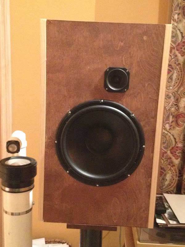

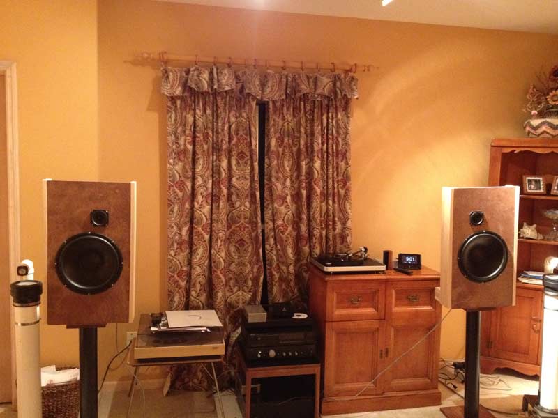

Pics of the newly completed Manzanitas:

I've finished my manzanitas now. I unwound a .80 mh coil to about .40 and ran it in series with the 2.00 mh. Used a 15 ohm resistor with this and it tames the harshness I was hearing ( could be my tinitis ). So only a change in the tweet inductor.
Listened and enjoyed them last night along with some red wine. Marvelous to have some real bass in the house. Also the open and airy nature of an OB. Also clear sound at higher levels. I've got them abput 3' off the wall and 4' from the side walls - placement does matter with these. I made some stands out of mdf so they are at a good height.
There is a part of the midrange that is subdued but I only notice this on some very familiar recordings. I think this could be fixed pretty easily. I might try adding a second tweet in series with the first and roll the highs off it with a 68 uf electrolytic across it. Would locate it just above the first one on the baffle. This would fill in the mids some I think. The tweets are so cheap it could'nt hurt to try.
