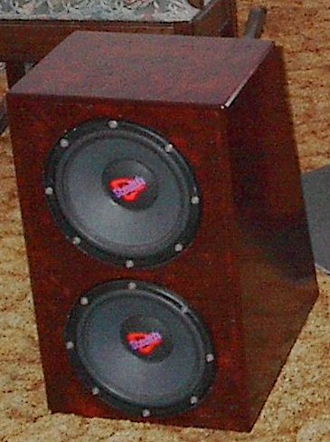

This is a ridiculously bad photo but...It's a dual 10" sub that I built a couple years ago. It is 3/4" plywood with 1/2" OSB on the outside. I painted it black then sanded it ( black stayed in the crevices and pits). I then gave it a coat of a mixture of clear gloss solvent based urethane, red oil paint and black oil paint. I got a kind of "candy apple" look.
A neat finish, quite different.
