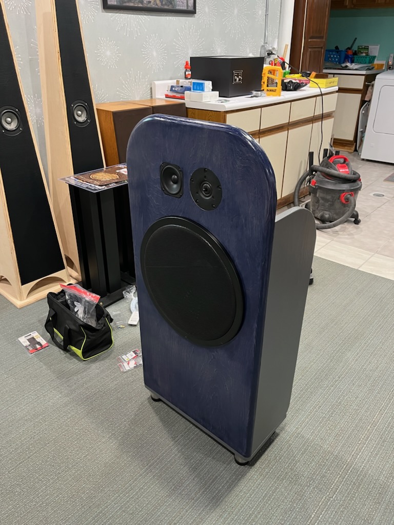

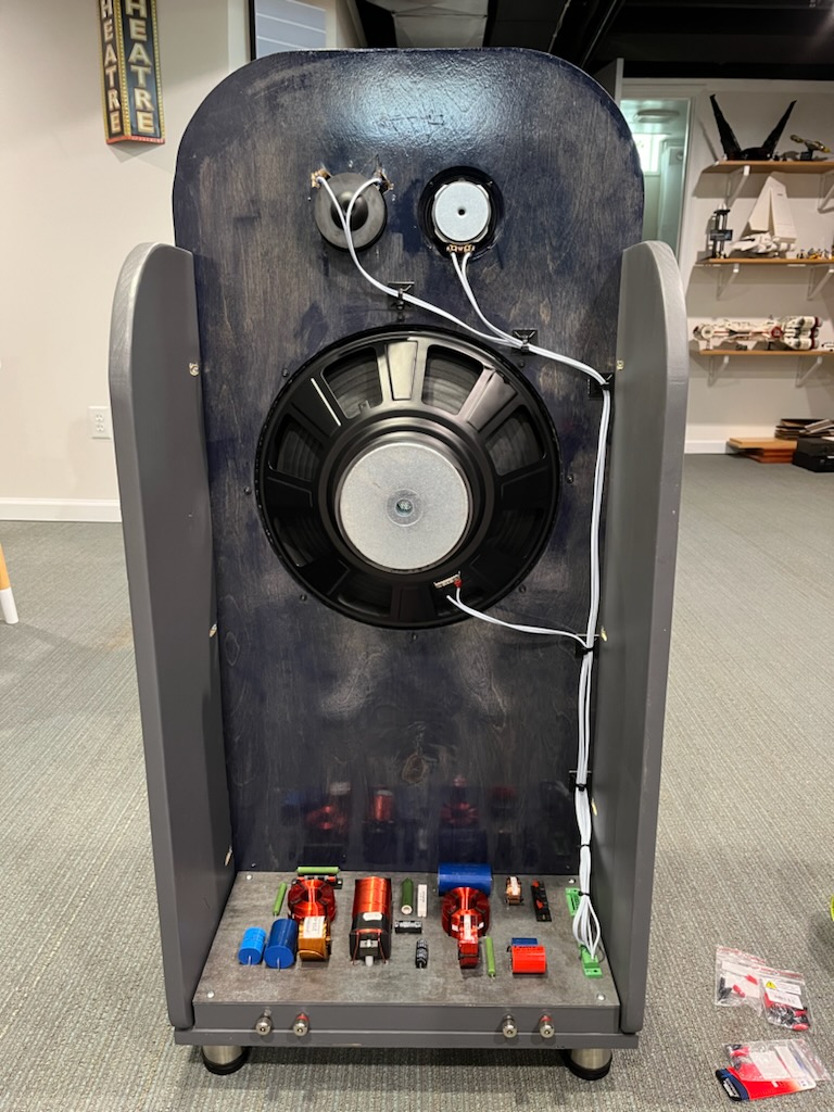

Here's mine. I built it with (hopefully) dual crossovers so I can pick the regular 2-way Ultra build or use Jogunast's 3-way as desired. I used speaker push terminals to allow for super easy resistor changes. And yes, both crossovers share the 18mH inductor. While one side of the crossover is in use, the other side remains open on both the grounds and the speaker terminals so it (I assume) won't affect the active side. I'm guessing since my frame was designed with the 3-way in mind (and the 18mH inductor instead of the 20), it'll end up with more midbass than the Mazanita Ultras. It is breaking in now, maybe 10-12 hours on it at this point. With just a few min of listening and no specific room placement you can already tell there is a detailed center image with depth. Listening from around the corner, they sound stunning though, Frank Sinatra sounded closer to a person than other speakers I own, and some of them cost several times what these cost. It's kind of amazing what comes out of those 3.5" vifas, and missing the box hehe.
Wow, it really looks good.Here's mine. I built it with (hopefully) dual crossovers so I can pick the regular 2-way Ultra build or use Jogunast's 3-way as desired. I used speaker push terminals to allow for super easy resistor changes. And yes, both crossovers share the 18mH inductor. While one side of the crossover is in use, the other side remains open on both the grounds and the speaker terminals so it (I assume) won't affect the active side. I'm guessing since my frame was designed with the 3-way in mind (and the 18mH inductor instead of the 20), it'll end up with more midbass than the Mazanita Ultras. It is breaking in now, maybe 10-12 hours on it at this point. With just a few min of listening and no specific room placement you can already tell there is a detailed center image with depth. Listening from around the corner, they sound stunning though, Frank Sinatra sounded closer to a person than other speakers I own, and some of them cost several times what these cost. It's kind of amazing what comes out of those 3.5" vifas, and missing the box hehe.
I'm curious how they sound after break-in and with proper placement.

Hey everyone. So I started listening to the speakers last night, as 2-ways, but the midrange/vifa is SOO forward sounding, it is quite unbalanced, like something is wrong. I am using the standard Ultra crossover schematic values. I did try increasing the 15ohm to 18 with no appreciable change. I'm pretty sure from reading on here that is not how it is supposed to sound so I am wondering if there is any chance the 3-way crossover is interfering with the 2-way? Basically Jogunast's 3-way from post 2757 on page 138 is sharing the big woofer inductor so both crossovers are connected via the positive terminal from the amp at all times. On the unused side, the grounds are disconnected and the speaker terminals are disconnected, as in open circuit/un-terminated. I assumed under those conditions, the unused crossover side would be non-interfering.
I don't want to pull the crossover boards out and unsolder the 3 way positive side yet so I am asking for thoughts first.
The Vifa mellows as it gets some hours on it. The same happens to the woofer, too, although to a lesser degree.
Make sure the speakers are 3 or 4 feet away from the wall, too. Then just give them some time.
I can confirm, a run makes a difference.The Vifa mellows as it gets some hours on it. The same happens to the woofer, too, although to a lesser degree.

Show us two schematics, both including all components, one as connected for two-way, one as for three-way.
Then we can see and eliminate any crosstalk problems.
I'm working on this - got to draw it out and just been too busy. Will try to upload some pics this weekend of the two schematics.
