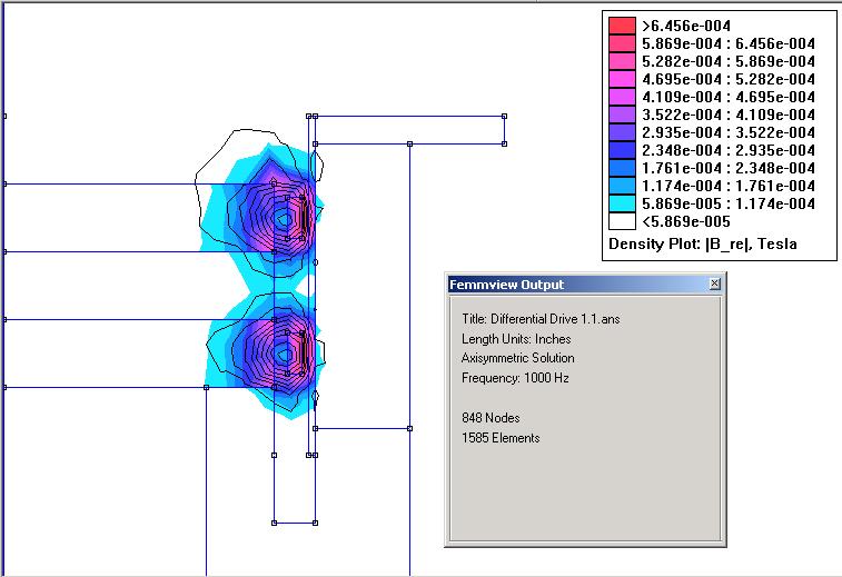

There's a good chance I'm the thick one and totally misunderstanding what you're saying, but I think I'm hearing you say that, essentially, a single Faraday sleeve outside the VC should significantly reduce flux modulation in the pole. That's the point I'm arguing against. 🙂
I hope a picture is worth 1k words.
Same DD motor @ 1kHz with a single Faraday sleeve outside the VC. Notice that the VC field lines do penetrate into the pole in this case, whereas they didn't in the inner Faraday sleeve scenario.
capslock said:
What am I missing?
I think what you are missing is, for perfect coupling the faraday ring and the voice coil should have exactly the same diameter, which can't be unless they are intertwined🙂. Whether the faraday ring sleeve is inside or outside of the coil, coil and faraday ring may see the same flux change, and the flux change will cause an induced current on the sleeve. But this induced current on the ring generates a field on the overall cross section area of its, which is different then the cross section area of the voice coil. I haven't set done and did any calculations, but I think the larger the difference between the cross section areas of the ring and the coil the less coupling they will have. Math can prove me wrong though 🙂
I think what Bill is demonstrating is, when the ring is inside and close to the pole piece, it cancels the flux change inside the pole piece, but not on the top and bottom plates that effectively. When the ring is outside the coil and close to top and bottom plates it cancels the flux change inside the top and bottom plates but not that effectively the change on the pole piece. Since pole piece has more iron than top and bottom pieces, it might be the first choice to place the ring close to it. In Bill's simulations, a ring outside the coil is still beneficial if you compare it to the case with no ring.
BTW, I am confused to which one is which 🙂 I think in the below one the ring is close to the pole piece and inside the coils:
http://www.diyaudio.com/forums/attachment.php?s=&postid=717939&stamp=1126030738
And on this one I think the middle version is the one that has faraday ring on the outside of the coil. Or I got the geometry or wrong 🙂
http://www.diyaudio.com/forums/attachment.php?s=&postid=706194&stamp=1124390327
Sorry, it's not very clear in my FEMM screenshots, but the left border of each sim is the motor centerline, (axisymetric problem) so you're moving outward as you move right. 🙂
