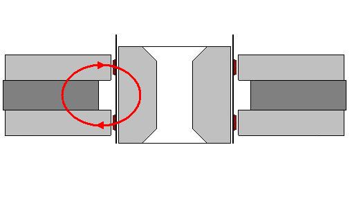

Yes, that's my simplified drawing of an underhung application of Differential Drive, but JBL more commonly uses a long-excursion variation--picture the same thing, just overhung.

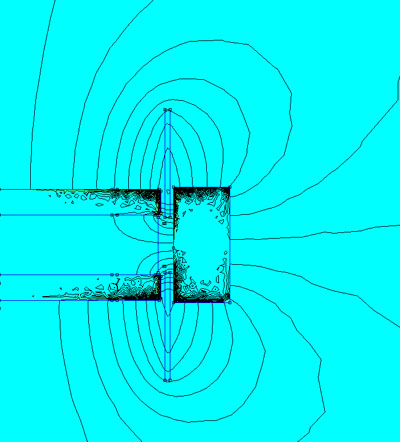

Well, we were talking about modifying an existing magnet structure, so it's not really possible to do that for this case... However, I just ran a quick model (I couldn't find my results from the last time I did it), and there still is inductance - it is not totally eliminated. The inductance is perfectly symmetrical, though (but not necessarily flat, although it was pretty flat in my case). This is just for a theoretical case, though. If you added an aluminum frame that was not symmetric, you would loose your nice Le vs x curve.

Bill F. said:I hadn't gotten around to modeling DD, but just looking at it, I'd thought the inductance of the counter-wound VCs would cancel--but I guess not.
I don't claim to be a magnetics expert. In fact it confuses the hell out of me. However, I believe this is a matter of mutual inductance. A high mutual inductance means that a current in one coil will induce a proportional current in the other coil (proportional to the turns ratio that is). The coils in the JBL motor are pretty far apart and if you're saturating the pole piece, there is a lot of flux that is not following the steel circuit...hence the mutual inductance is not that high. Putting the coils physically closer will get you a higher mutual inductance. Compare the JBL motor to a transformer, for instance. The coils are (usually) interleaved and the iron isn't saturated, so you'll get a much higher mutual inductance in the transformer.

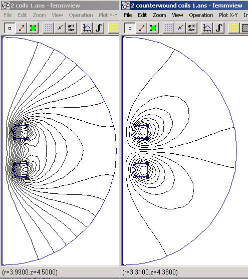

I don't think the coil interaction is raising inductance in this case. Rather, since the opposite fields repel each other, I'd expect them to reduce total inductance, as illustrated in the attached two FEMM plots (air-core single turns, first with current flowing in the same direction, then opposing).
Right. Sorry if I wasn't clear. The amount of cancellation depends on the mutual inductance. A high mutual inductance means a higher degree of cancellation (lower net inductance). The JBL motor has lower mutual inductance than a motor with the compensating coil close to the voice coil. Hence it will have a higher inductance.
Ah, yes. Sorry I misunderstood you, John (H).
John (S), I'm curious about your DD model. The stray flux does appear similar to the free air coils. Did you compare the coils' inductance in free air to their inductance with the magnetic return circuit in place? I would hazard a guess the two readings might be quite close.

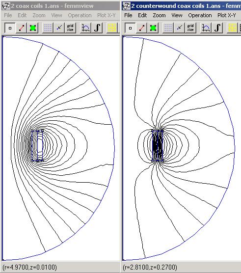

If you've got time to burn, how about simulating two interleaved coils. I'm just curious to see how that compares--what kind of cancellation you get.

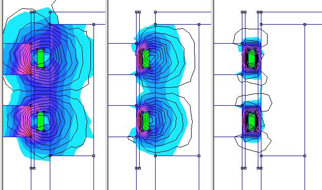

I was just playing around with a DD sim with varying levels of Faraday treatment, and I thought I'd share a nice visual illustration of how full-length faraday rings shield the ferromagnetic motor parts from alternating VC fields.
The sim is an 4" dia. underhung differential-drive motor with a NdFeB magnet in the pole. Yoke is 1006 steel, and Faraday rings are 1/20" thick copper. Counterwound single-turn copper VCs carry 10A @ 1kHz.
From left to right: No Faraday rings; ring inside VC; rings inside and outside VC.

I just tried that and one coil on the air core is around 3.6 vs 5.3 for the magnet assembly, so the inductance does go up with some steel in there. Those numbers aren't actually the inductances, but would be directly proportional to inductance.
John,
Wouldn't interleaving coils wired with opposite polarity kill your BL? It would kind of defeat the purpose...

that is quite amazing....that's for illustrating that
WOW Bill F....excellent work on DD-Faraday simulation.
Your simulation opens the question on selecting a DD drive motor over a radial motor as used in Aura for an underhung design. A radial motor with Faraday rings always looked superior for modest Xmax speakers, and your simulation seems to support this. High efficiency and high detail are more important to me than Xmax.
