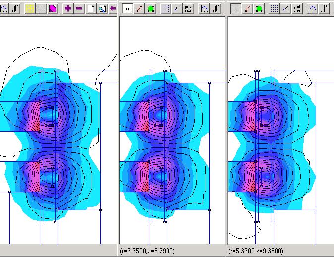

Bill, was this FEMM?
With the field this nicely shielded, why would you still want to use DD? The main point of DD is to avoid modulation of iron magnetization, isn't it?

Bill F. said:The sim is an 4" dia. underhung differential-drive motor with a NdFeB magnet in the pole. Yoke is 1006 steel, and Faraday rings are 1/20" thick copper. Counterwound single-turn copper VCs carry 10A @ 1kHz.
Correctamundo.
Faraday rings' sheilding effectivness drops with frequency, so I still like the idea of DD or a compensating coil for their low-frequency behavior, though I'm sure some might debate their audible benefits at low frequency.
how about trying this at 100Hz or even 10Hz. As I recall Birt was advocating compensation coils over Faraday rings for woofers because they work better at low frequencies. The DD solution, since it is basically a compensating coil, may be relatively more attractive for a woofer than is indicated in your simulation at 1kHz.
Apart from any bandwidth gained from lower Le, yes, I believe that if the counter-wound VCs offer any audible improvement, it would be midbass and down, where Faraday rings become less effective sheilds, as illustrated below. (Same motor and Faraday treatment as before, but now at 100Hz.) The Faraday rings are practically out of the picture at this freq.

Bill F. said:
Correctamundo.
