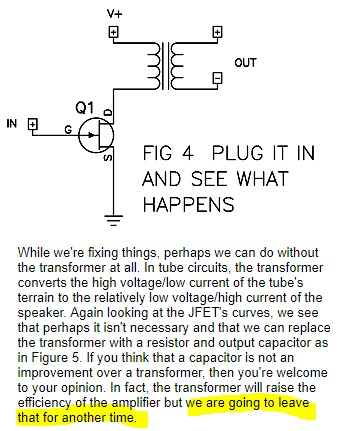

A question for Nelson: if you were to build a simple 1w amp witj Lu1014 j-fet, what would you do? I am thinking of something extremely simple, just for fun, something along the lines of Zen V8, but without the cascode, and maybe with a lightbulb 🙂
Will it work, or will it Pop? 😀

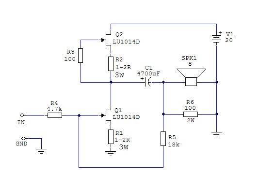

..simple 1w amp witj Lu1014 j-fet,...
Here you are:
Q1 amplifies voltage and current (common Source mode) and Q2 is a CCS.
R5/R4 ratio sets the gain and R4 sets the Zin - don't use much higher value (up to 10k max) or you'll lose good treble. Of course, you signal/music source should be able to drive that Zin.
R6 keeps coupling cap C1 tied to GND when there is no speaker connected (to avoid panic about output DC offset).
Setting it right:
We want about 1A through JFETs (set with value of R2, start with 2R2 - lower resistance will give higher current) and about 10V (half of the V1) at the drain of Q1 (set with value of R1, start with 2R2).
If it happens that you have DC offset at input it means that your Q1 has a leaky gate but it's not a big deal, just use coupling cap at input (22u or so).
Don't forget to take good care about heatsinking Q1 and Q2 or, if you can't, lower the V1 to 15V or even 12V - it will still produce 1W at the output. If you have 16R speakers you can lower the current through Q1 and Q2.
PSRR is very good so no extra care has to be taken about power supply, simple CRC will do fine.
Thanks Juma.
Although I must confess that I have a fetish for lightbulbs, so I may be inclined to use one instead of the upper Jfet 🙂
