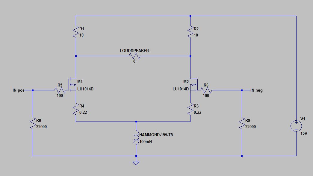

Would this be too big? 😉
looks perfect to put behind a horn tweeter and using output cap as 6db lowpass filter
Hi Michael,
Thank you for the schematic. Its sheer simplicity makes it irresistible 🙂
Instead of the Hammond, I guess one can use an appropriate lightbulb or maybe a Microwave oven transformer ...
Not so much the light bulb. That's a different amp. 🙂

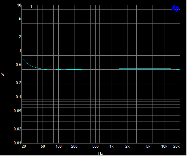

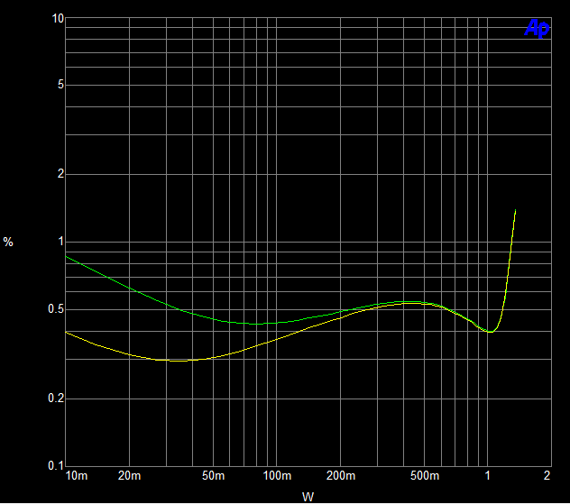

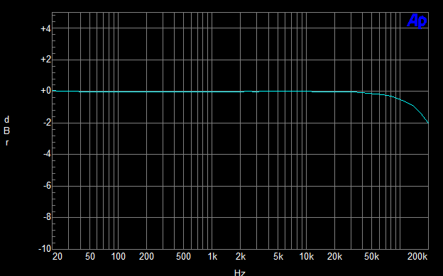

THD vs. Power
The yellow trace is PSU noise filtered. Possibly worth the effort to make a quiet regulated supply, but not strictly necessary. The switcher's fine too.
Actually, not too shabby. 🙂

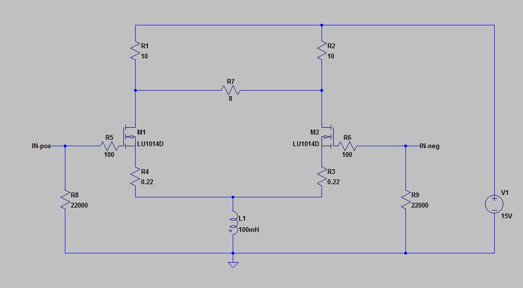

I have used the model posted by kekso22 with success (see post #26 of the thread below).
LD1014 SPiCE models
It is more realistic than the model provided by the manufacturer, epscially for the analogue region.

No. Assuming of course your source is clean of any DC.
Try to understand how it works, instead of copying blindly.
It is not so difficult.
Patrick

I know the self biased common source (short but good explanation in Mr. Rothacher paper). If I´m copying blindy I would not ask the question about the need for input coupling capacitor. I´ll place them on PCB so no problem if source isn´t clean of DC.
Thank you.
JP

If the source is not clean then you should clean it at the source (by cap or servo).
The circuit itself is (should be) Gnd referenced.
IMHO there is no need for an input cap (best cap is no cap).
(Unless you are making a product and want it to be idiot proof.)
And IMHO there is no need for a PCB, which is the whole point for its simplicity.
P2P is just fine, with or without a Vero.
Patrick

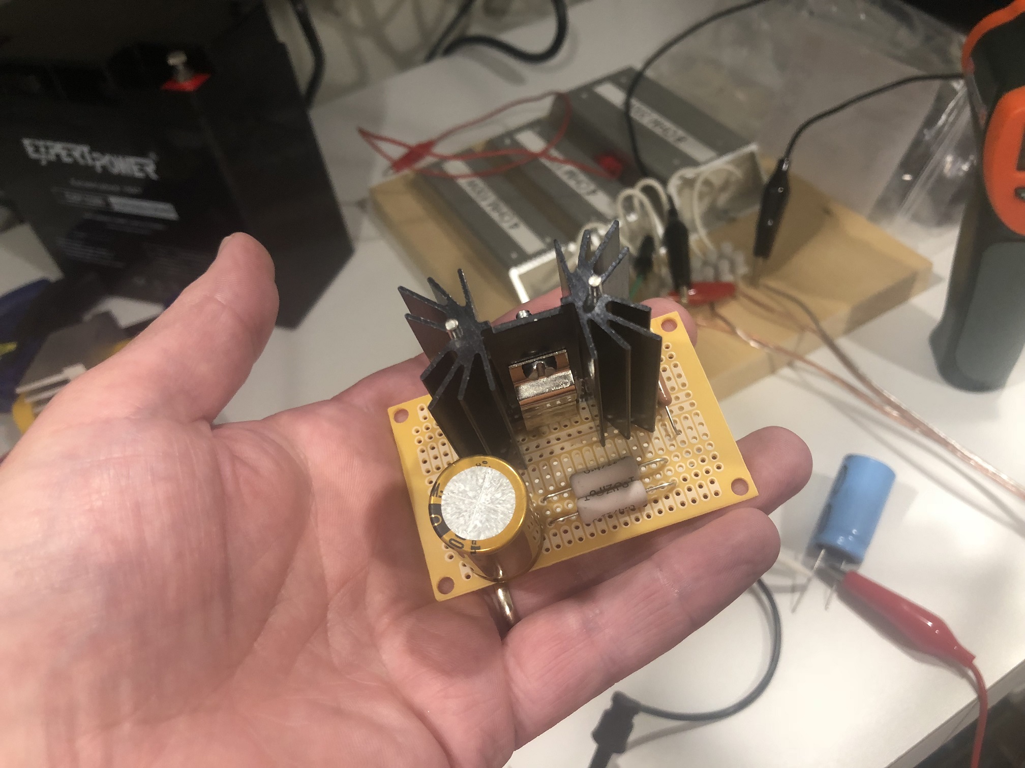

You might consider :
1) Build and test your proposed 120V Switcher (you will need a properly designed PCB for that);
2) maybe a break-off board added to that for the regulator of post #69 to clean off the switcher.
Patrick
Patrick
