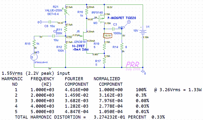

OK, this job is not heavy commercial. What did Mr Pass propose (GIVE us)? In my sim it clips at +6.3V/-5.9V. This is actually 2 Watts! What an over-powered monster! However it is showing 2% THD (and visible flattening). At 4.9V peak 1.5W I sim a fine Sine and 1%THD with falling spectrum. At 4.1V peak, 1W, my sim says 0.8% THD. (My simmed FET is old-old, Pass probably has better parts in sim and in drawers). At 1.64V peak, 0.16W, I sim 0.3%THD, so THD is not falling fast. (Seen the other way, there is no sharp rise of THD, another important aspect.)
6Vpk 2W 2% THD
4.9Vpk 1.5W 1%THD
4.1Vpk 1W 0.8%THD
1.64Vpk 0.16W 0.3%THD
The %THD is not really as important as the distortion shape/spectrum. 0.1% of 13th harmonic will drive you nuts, while 1%-2% of 2nd harmonic will pass un-noticed, or add a slight touch of sugar. But in this simple amp with simple distortions, you can almost pick your "output rating" anywhere from part-Watt to couple-Watt. Since the design goal was "1 watt", the designer merely claims to "meet spec".
It seems reasonable to suspect that, just foolin'-around (with deep experience), Mr Pass hit >1W at <1% and called it "soup".
Now if the customer had *also* specified "0.01%THD", then we would have to reduce drive to the flea-Watt level to make this spec, so the design is probably "failed". (I sim 0.4mW at 0.06%, tho I may be into the sim's numeric noise.)

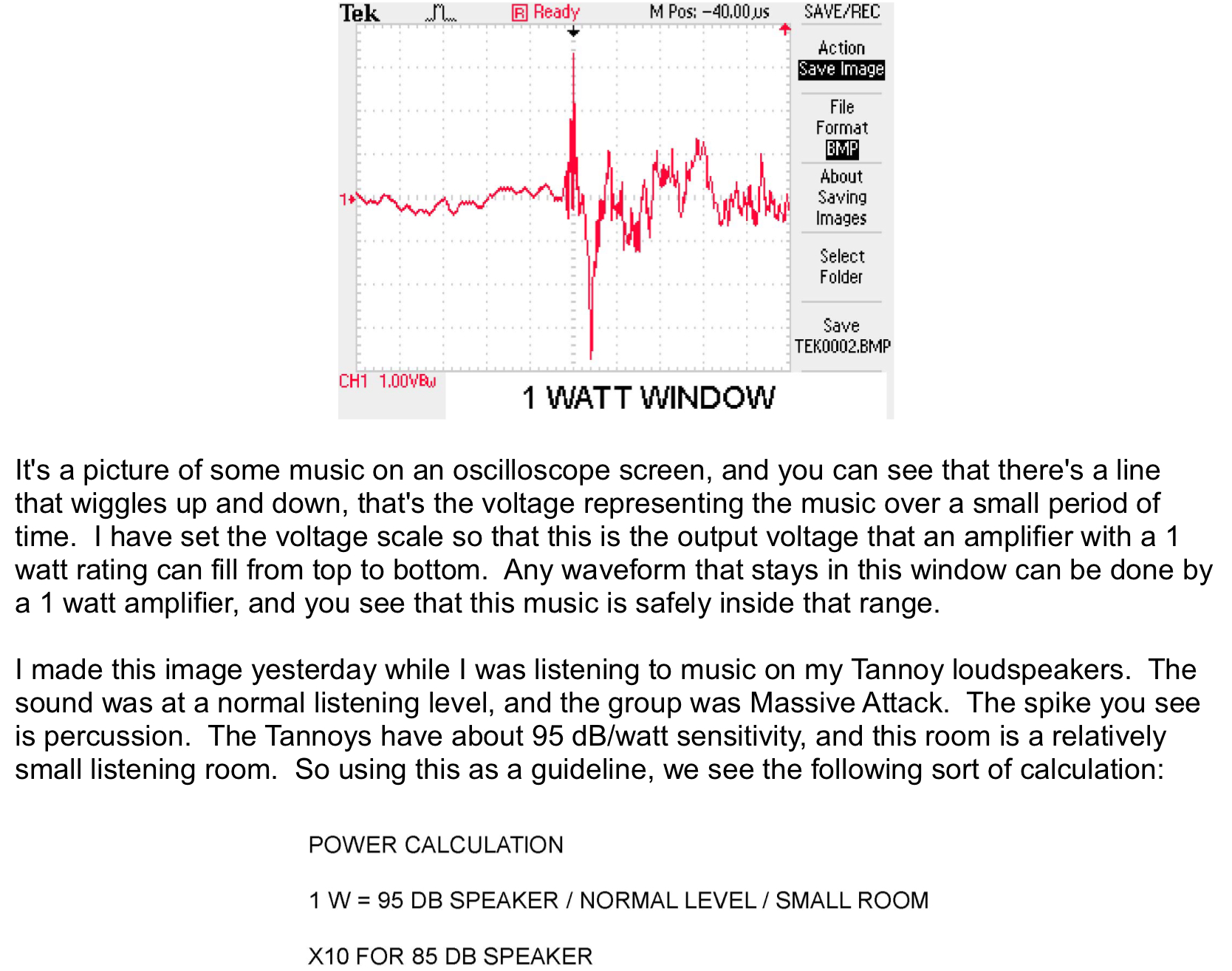

However audio needs are NOT so precise. It isn't like a need to pump 10GPH of water up 100 feet, a clear and easily calculable power-goal with not much user input. Soundhappy posted a link to a plot showing that, for a certain listening situation and event, the electrical needs were a bit shy of ONE WATT. However I know that if I feel funky I will turn the knob 3dB, 6dB, even 10dB. Now the "1 Watt" must be 2W, 4W, even 10W. OTOH I know that in many situations "1 Watt" is really very ample. I have several old 1W kitchen-radios and each will get "as loud as I can stand". Partly because their light speakers are pretty loud in midrange. (Partly because the THD goes up fast and then faster.) I know if I put the 1W Zenith to an A-7, it would be loud over at the neighbor's house also. Much less than 1W is often ample in efficient speakers.
