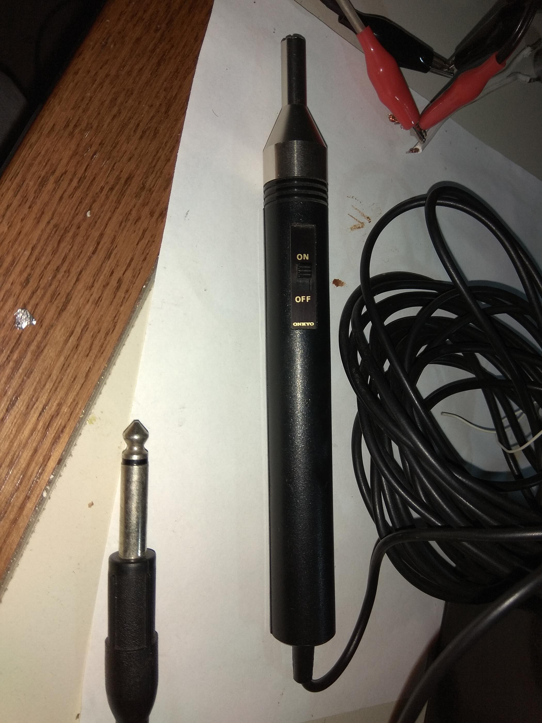

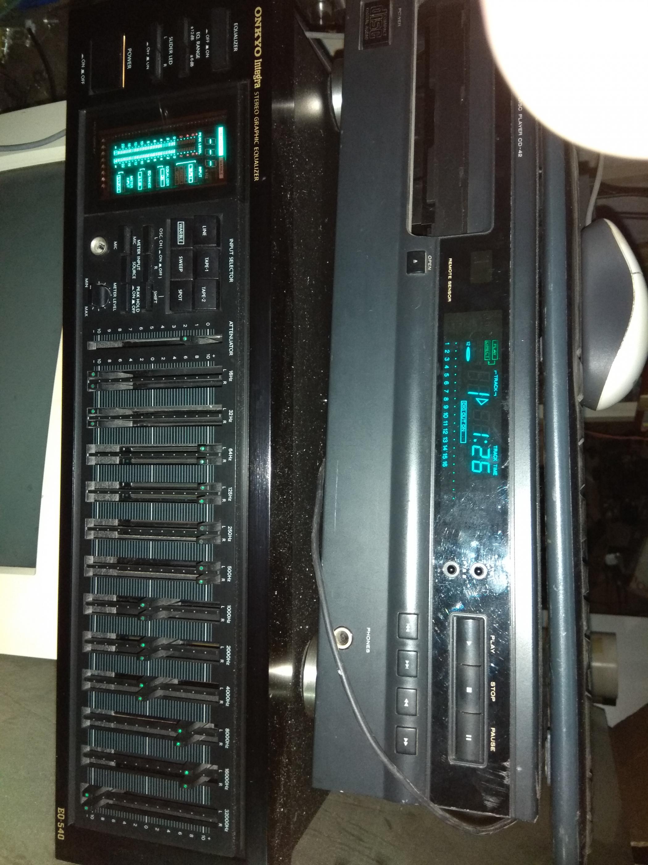

No i haven't any.
I have an Onkyo equalizer with built in audio generator and his own microphone.
I don't know how useful is this.
Not digital way of course.
Looks like it was designed to be used with the Onkyo for setting room EQ. Probably not useful as it doesn’t have a way to get the mic signal to REW software.

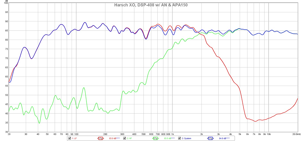

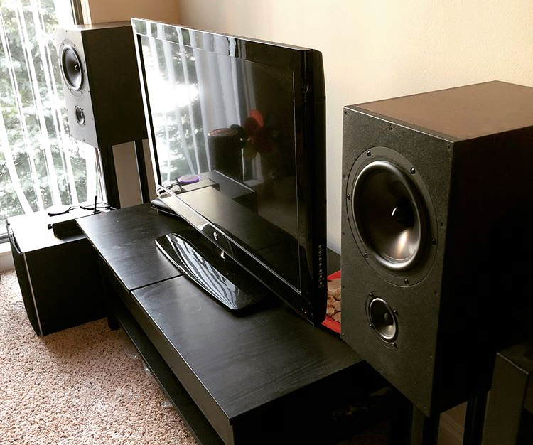

Yes, I used to do this strictly before I learned how to make passive crossovers. I used miniDSP but lately just got the the DSP408 and tested it out on same speaker. Super easy to use. Set filter, set EQ, set delay, set level, set input (1 of 4). Measure and repeat.
Low-Cost PMC-inspired TL Monitor with DC130A and DC28F

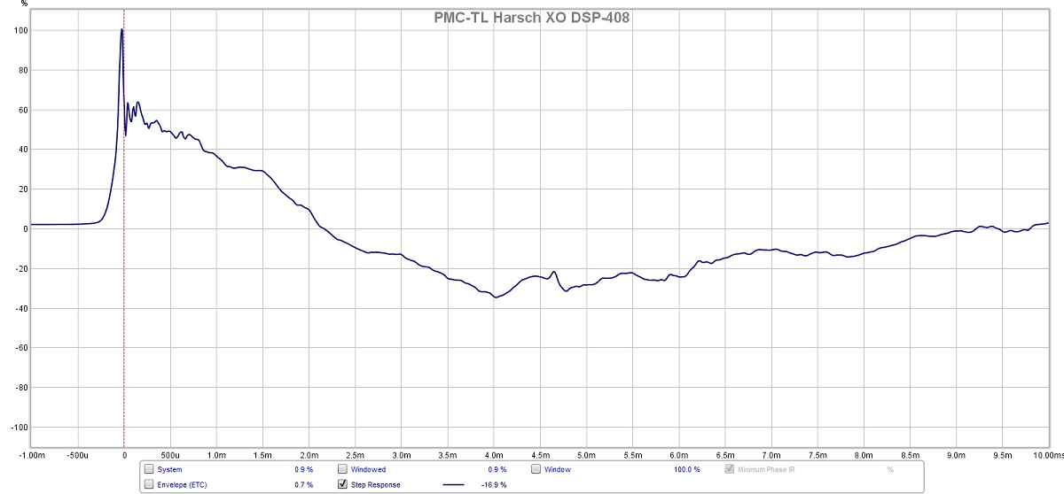

Here is the measurement from a Harsch XO I did a week ago on same speaker but using DSP408 and a Class A amp on woofer and Class AB on tweeter.
This took about 20 minutes to set up from turn on for the first time.
