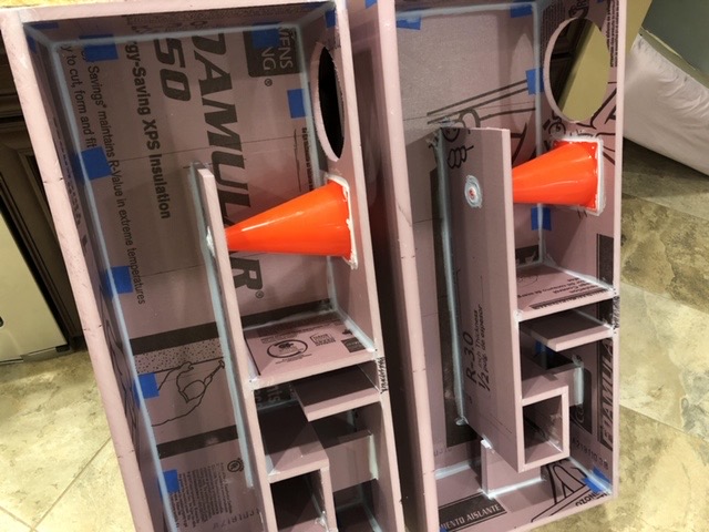

A Karlsonator may be the ideal cabinet because the K-aperture provides two benefits: wide dispersion to combat the beaming from a 12in full range, and the K-aperture applies a high pass shelf that might tame the rising top end that many people feel a need for electronic EQ. We won’t know until we build though. This is a good candidate for XPS foam pathfinder - add the baffle board with 3/16in plywood to anchor the driver. Make the K aperture out of 3/16in ply bonded to 1/2in XPS with non hardening industrial or construction adhesive - latex caulking works. That will dampen vibrations. Interior of cabinet should be lined with eggcrate foam. Exterior front chamber should be lined with melamine sponges.
XPS and ply works very well as a speaker if you have followed Vunce’s 10F/RS225 FAST TL build. It sounds great and no rattles or problems.

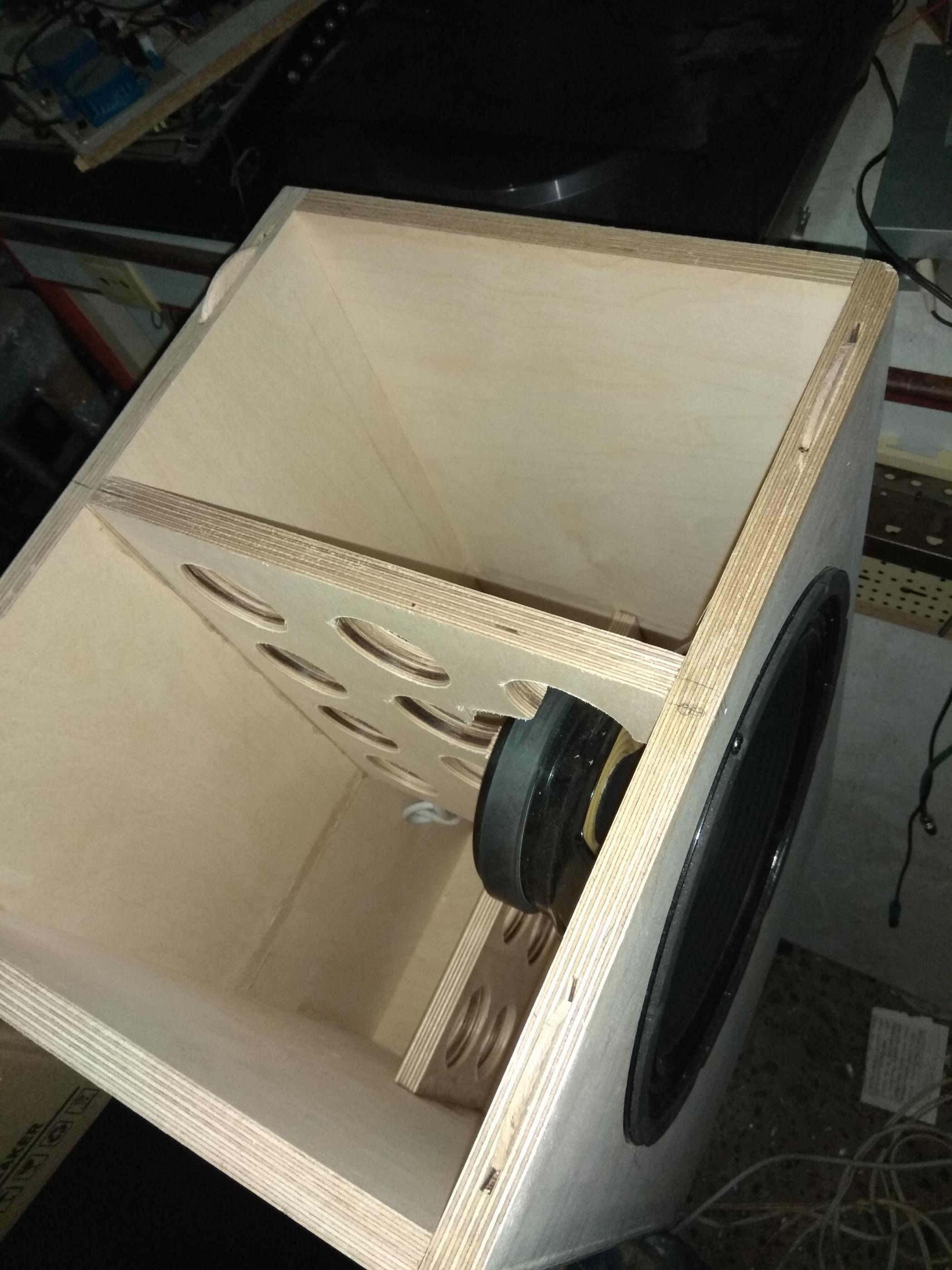

Hi Thimios,
Any number of software can be used to predict a sealed box response. But I will gladly do one for you with effect of baffle width on baffle step etc. please indicate position of driver on baffle face. Need height and width and volume.
Fane speaker cabinet.
Plywood 18mm.

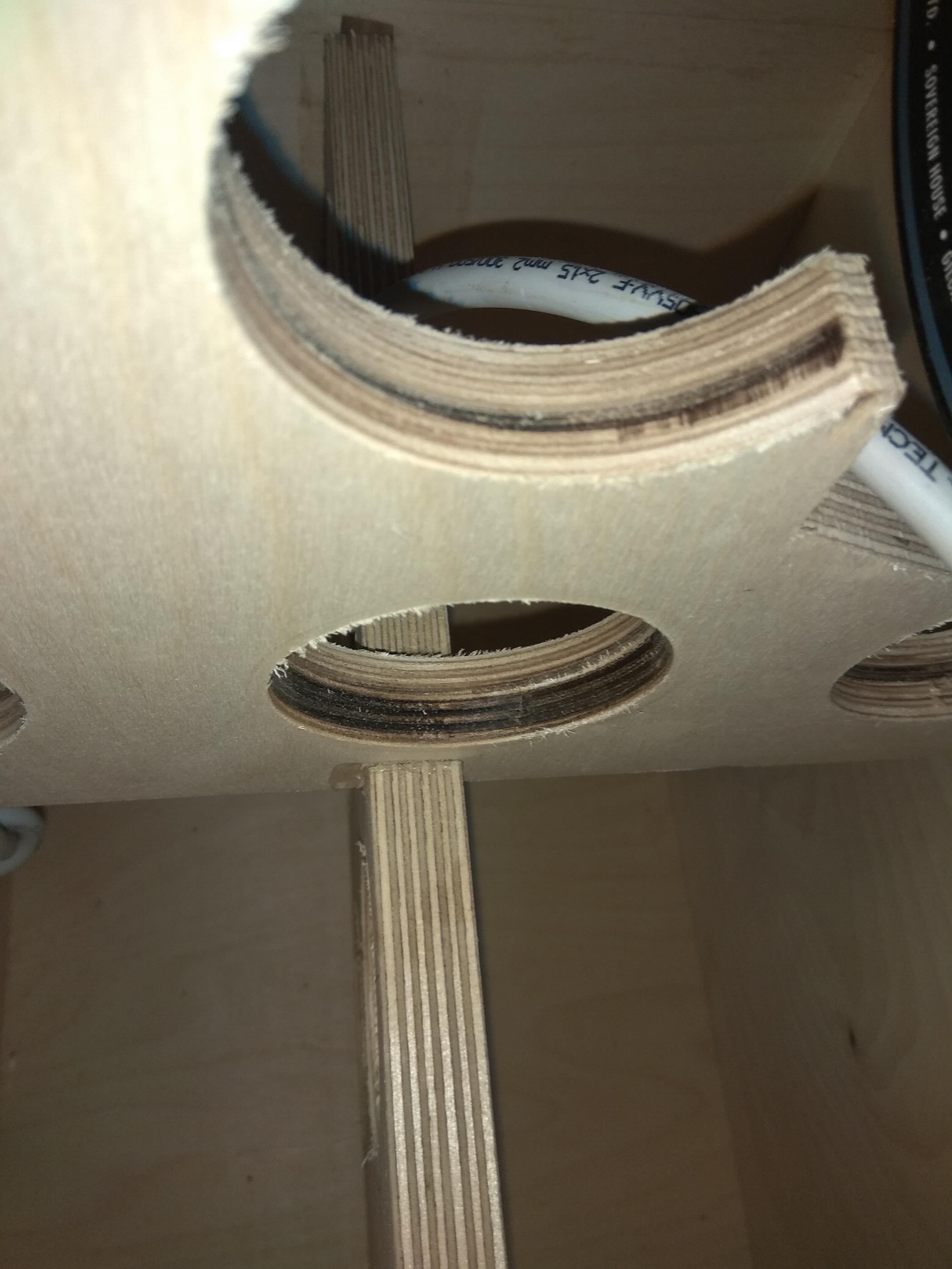

66cm high×39.5cm width×30.5cm depth. Indernal dimensions.
*Bracing left-right end, 28cm from the bottom.
Bracing front-rear 30.5x39.5 cm 8 holes 60mm each.
Bracing right left 17x39.5 cm 8 holes 60mm each.
Speaker center position 22.5cm from the top.
The dealer for Fane in North America is Solen.ca and they have 2x15" drivers available for $178cad each. That's what I'm using on an open baffle with a Fane 15" bass driver per side. Great driver.
It looks like circa 79L after you subtract the braces, and maybe 78L after you subtract volume of the driver itself. That's close enough. So baffle dimensions are 43.1cm wide baffle width (external) and 69.6cm high (external). I will call it 43cm x 70cm close enough.
Plywood 18mm.

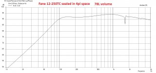

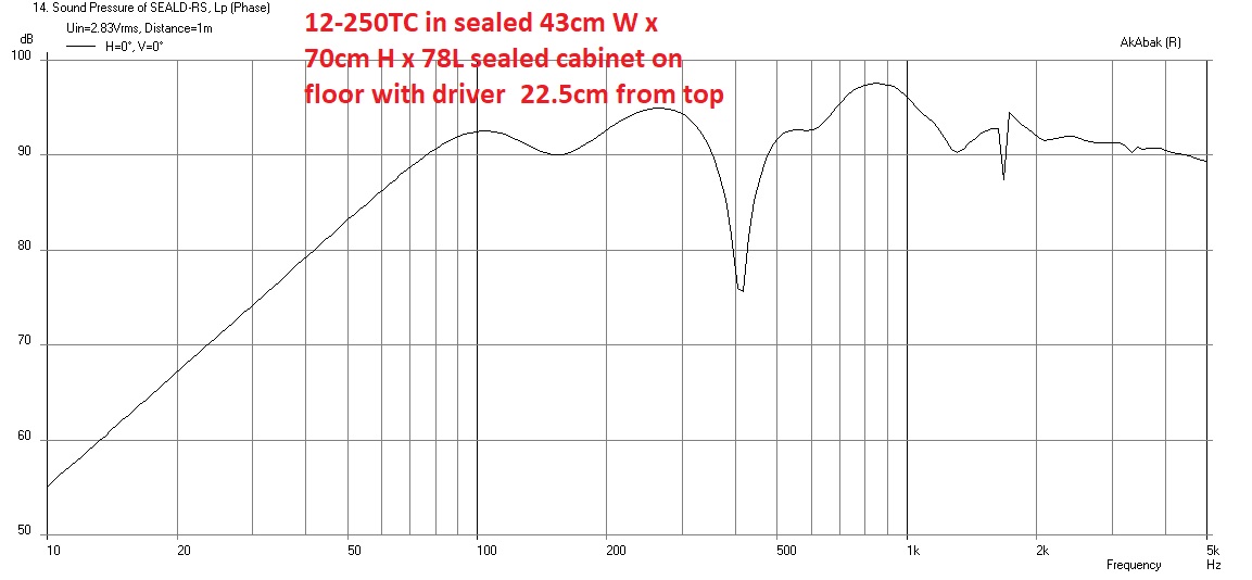

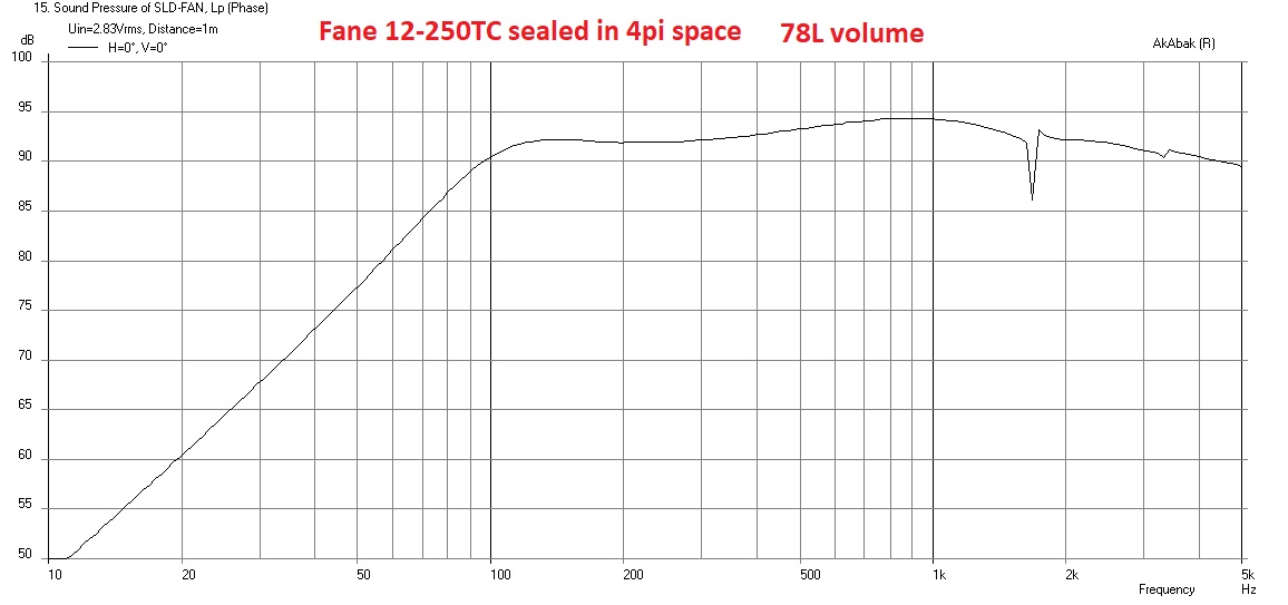

My sims for a Fane 12-250TC in a sealed box with critical damping of 0.71 seems to get only about -3dB at 97Hz with floor and back wall reinforcement. If placed on ground, there is a big floor bounce cancellation that will have a dip at about 400Hz.
Here is frequency response with effects of room bounce for cabinet sitting on floor next to a back wall:
If we place cabinet on a tall stand away from surfaces, you only get -3dB of 97Hz:
Max SPL is at about 32Vrms and 114dB.

Can you use foam for such a large cabinet?
Yes, thicker foam like pink 1in thick XPS. Bracing is always important. Use thin 3/16in ply to reinforce where driver mounts and also on K aperture to strengthen it.

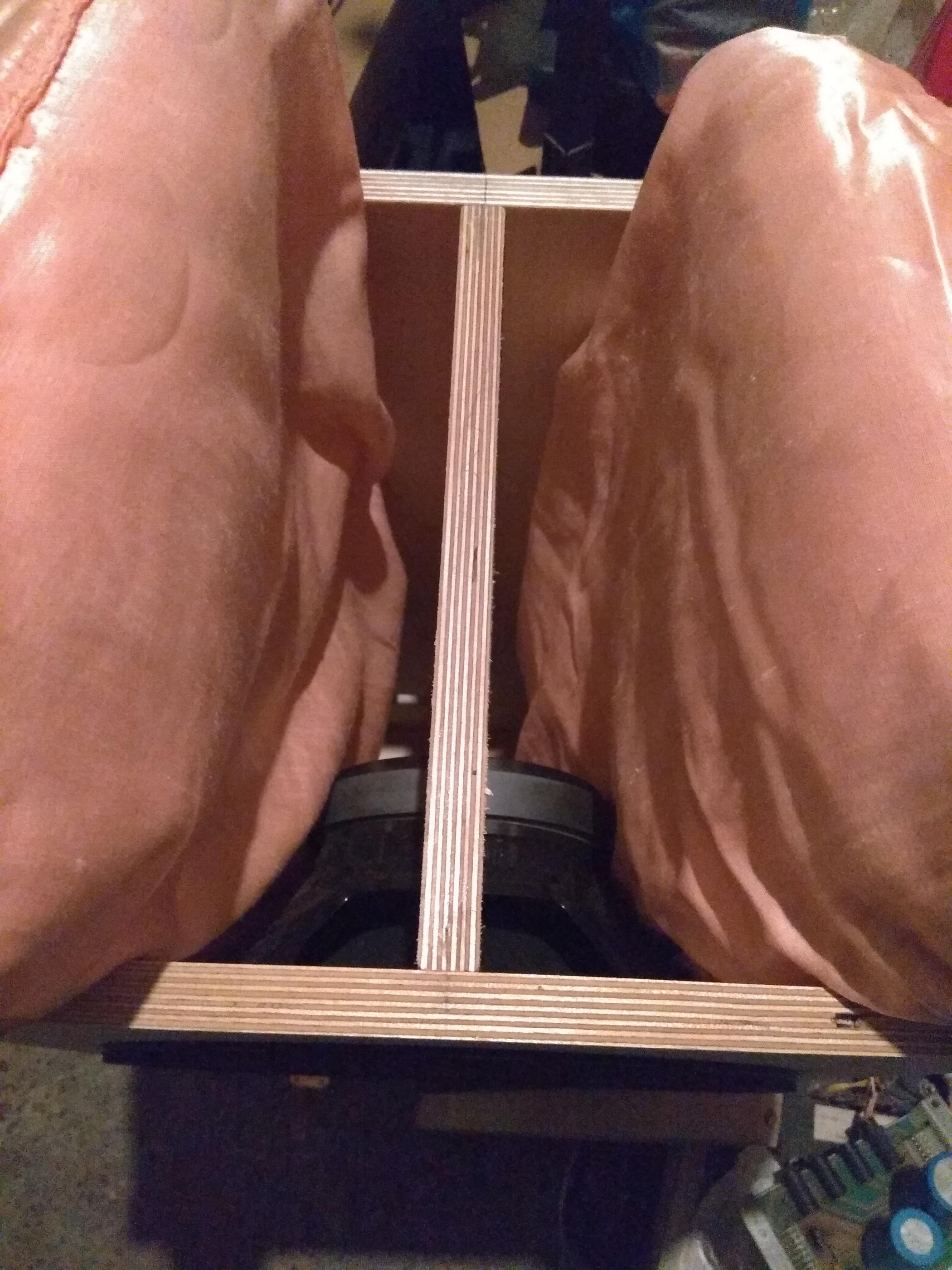

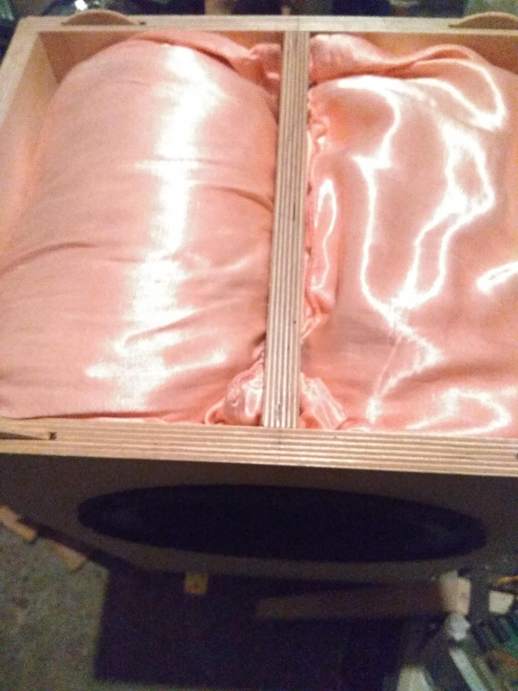

Sorry,i'm not a speaker expert, can you explain what do you mean damping of 0.71 ?
I think that is something to do with damping materials but ...😕
Finally what you think,is it something that need improvements?
I have tried to add sheep's hair as damping material.
Nothing special,just two sleeping pillows,about 4kg. and only at the right and left upper sides.
I feel that i hear a better and more deep bass.
There is a point of “just right” or critical damping (stuffing amount) that doesn’t have overshoot and doesn’t attenuator bass more than needed. Mathematically it is called critical damping factor equal to sqrt2/2. I personally like mildly overdamped about 0.6. You can read about it on internet search.
But ultimately, adjust stuffing to your liking. It’s not a big deal - it will sound quite nice with a lot of stuffing. I like removing rather than adding.
Stuffing increases the virtual volume and makes deeper bass at expense of lower SPL. Try removing the pillow covers. It allows free air to move through.
