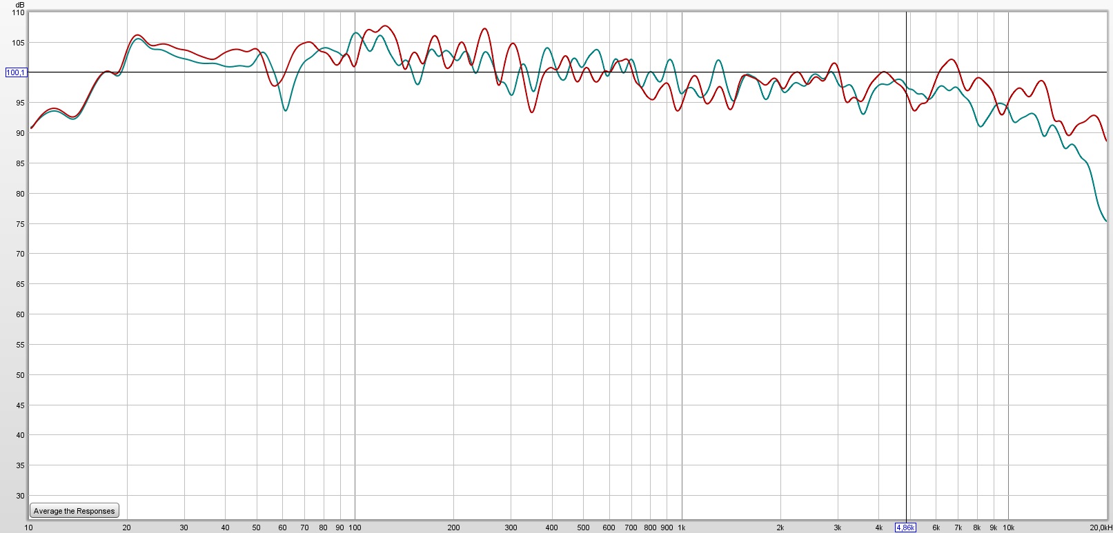

Here you go, just got some sweeps done. 5db/div 10 to 20 000hz.
Left is cyan and right is red. 1/12th octave smoothing.
This is not measured dead center a bit and a half off axis, sounds good over a wide area.
If you by some insane miracle manage to get your head in a vice exactly at 0° from both sides they are a bit hot, at 3° off axis its not a big problem.
Edit:
Only reason they are rolling off under 20hz is because it's actually impossible to kill the HP filter for the subs on my dsp, otherwise it would go flat to 13hz.

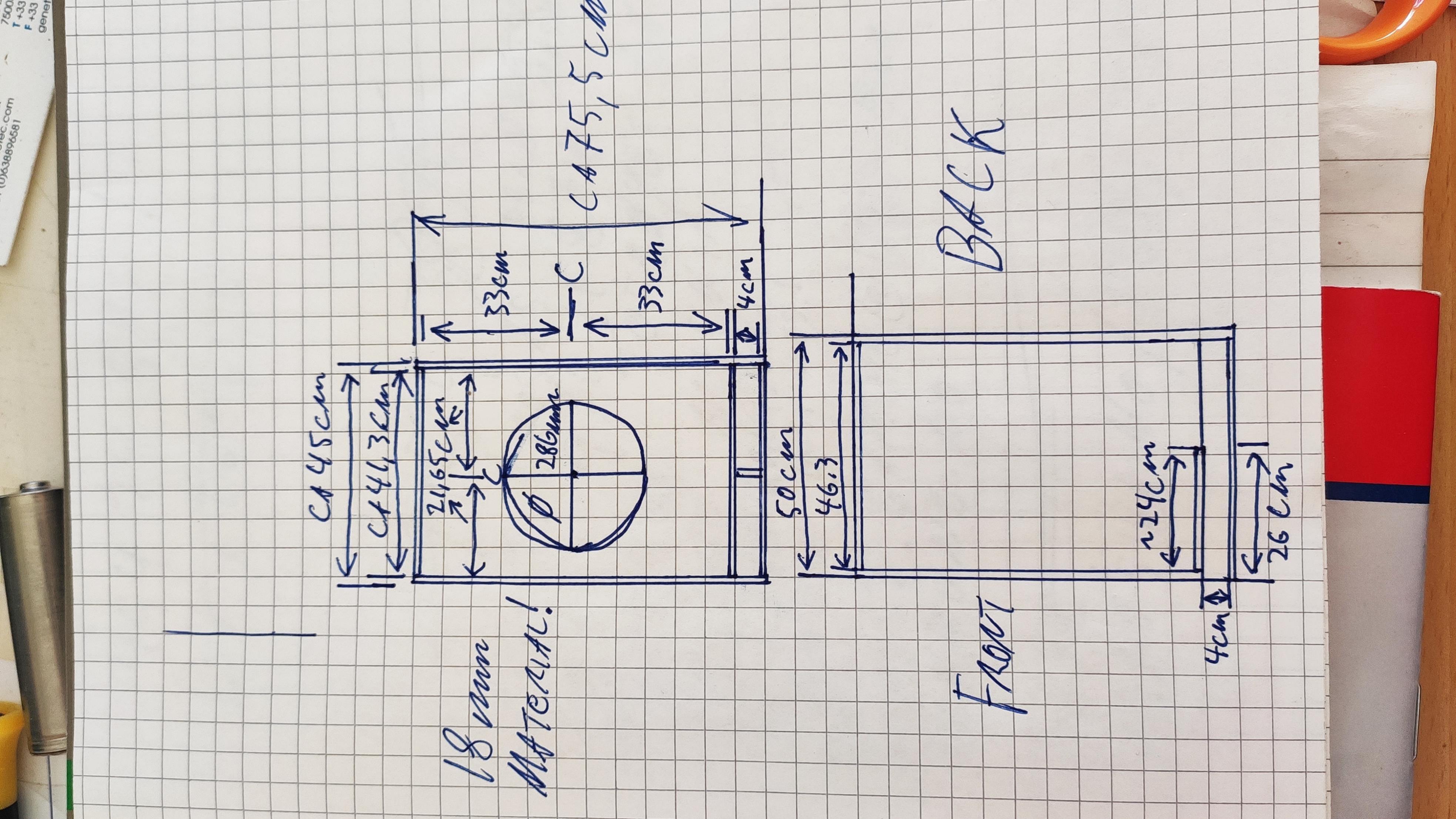

I see your box is around 140liters? what happens with smaller enclosure?
ex if we make a 80L box Vented BR or Sealed .
See the official Fane site specs Why do they recommend enclosure of 34 to 75 liters??
129.996 liters internal volume.I see your box is around 140liters?
The qts is somewhat high, and the VAS is not too bad, up to 80 liters sealed should work really well for this driver. My 130 liter box is somewhat compact really, I would not make a smaller box than perhaps 120 liters if going vented, it would most likely give a peaky response and no low end.what happens with smaller enclosure?
Depends on your application. This is a PA driver, and most PA applications call for easy to carry and mount boxes for the top end, and stuff pushed around using wheels for the low end. Max output to 50-60hz seems to be the most common goal.See the official Fane site specs Why do they recommend enclosure of 34 to 75 liters??
Are you willing to trade some max SPL for deeper extension? I am. Especially so since I can not play at max volume anyway, it's too loud!

Yes Lets try and start from minimum volum and with simple shapes and then according to what we can achieve we can go higher (I think we will not have diferent choise).
For a 15" I guess the minimum volume we can get would be 40x40x40= 64 Liters net
For a 12" 35x35x35= 43 liters net
Thank you
Thank you
I do not think you understand what I meant.
Both those volumes you list are too small, except perhaps as sealed enclosures, but even then they'd be a bit small for the Fane FR's.
Are you seriously telling me you want a cube of 40 x 40 x 40 cm?
The cube you list for the 15" would maybe fit as a sealed box for the 12", the cube you list for the 12" is a bit small for these, so then I'd suggest you use that volume to make a ported enclosure for a single 8" or two 6.5".
At this size there's no chance I will even attempt to do a sim on anything other than a closed box for the Fane drivers.
BR/TL for the 12" starts around 100 liters, don't expect very deep bass.
I am using the 15" in ca 80 liters sealed, but not by itself. It would work with a bit of DSP power though.
With both these drivers the cab will need to be a certain size just due to the driver dimensions, so if you're coming from smaller drivers then you have to think about the differences etc and of course scale up. That being said I think that both the 12" and 15" can be used in a 'modest' cab design comparability to what a sealed, ported, mltl etc would need to be, especially if you have subs or ' low frequency augmenting' drivers'..
Myself I'd go for the 15" in an open bottom cab, not sealed or ported etc. Still going to be lots bigger than a bookshelf though .. It is what it is..
