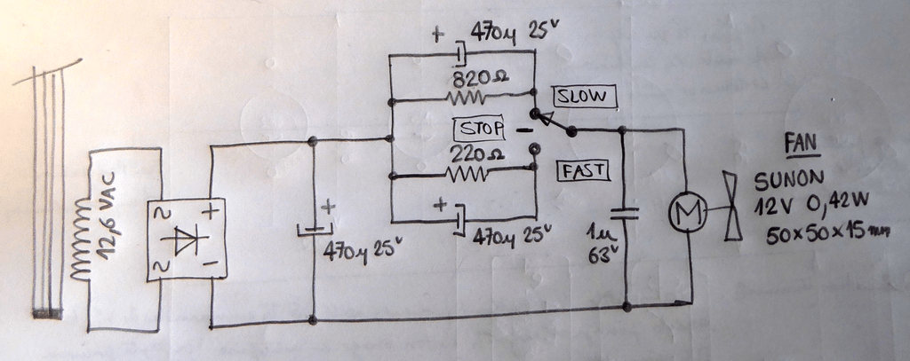

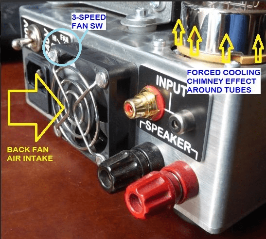

I use small fans when needed on tube amps :
The control is manual and analogic :

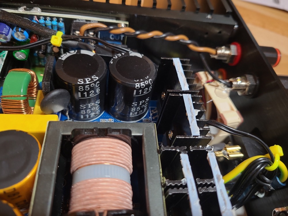

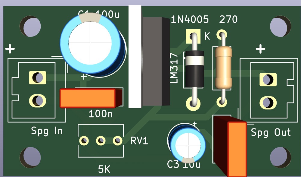

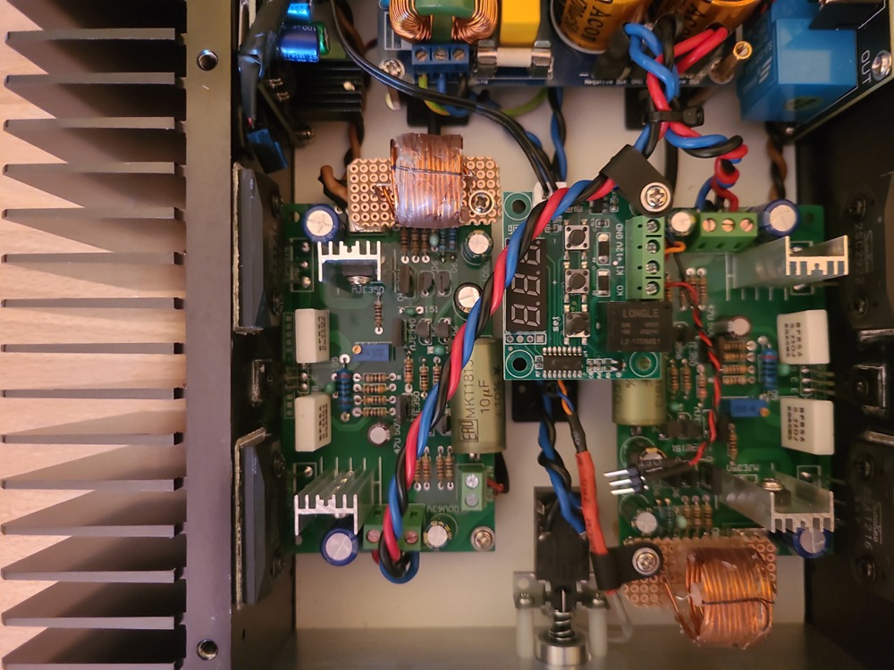

I have another cheap solution...
I am using two mini pcb's with LM317 on it. One for the temperatureswitch 12 Volt, one for the noctua 40mm fan, 9,5 volt. The temperature is set to 50 degrees celcius. The 10k resistor is placed on the heatsink with thermal glue.The switch https://de.aliexpress.com/i/1005005390866435.html
You can not hear the fan, it is quiet. There is a little space to the backplate to get air in...
Its only for more safety. The fan has to cool down the heatsinks of the smps. I never reached the temperature until now...
