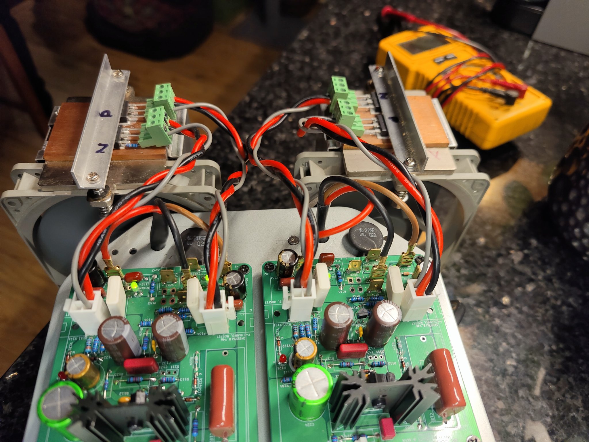

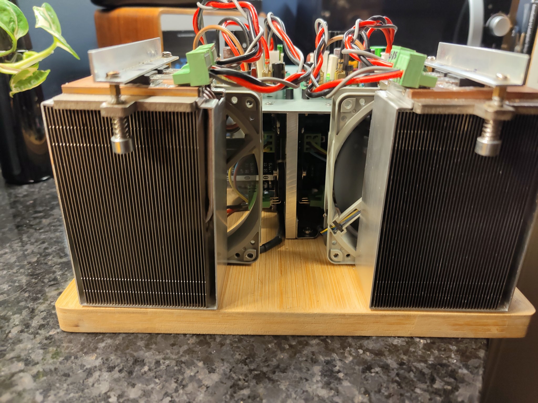

My F6 is fine, except when the ambient temperature rises. I made my chassis, and used 4 ebay heatsinks, with the back up plan of adding a small fan to the fin end of each one, blowing towards the center of the base, where the mosfet is. It sounds great, but I can't help putting a hand on it every now and then to see how its doing. I think fans on the amp would be quieter than the AC 🙂

This is a neat idea, and I'll need something like it to jam an F5 amp into a smaller enclosure. There is a real lack of chassis pictures and layouts around here! Any suggestions on possible layouts? I like using existing technologies: CPU cooler, like the classis Cooler Master Hyper 212, then possible a real big fan right on the inside top of the enclosure for hot exhaust like this big Phanteks 200mm (~8in) fan.
So I envision the MOSFETs with either own CPU cooler, then a big exhaust fan on the top. <shrug>????

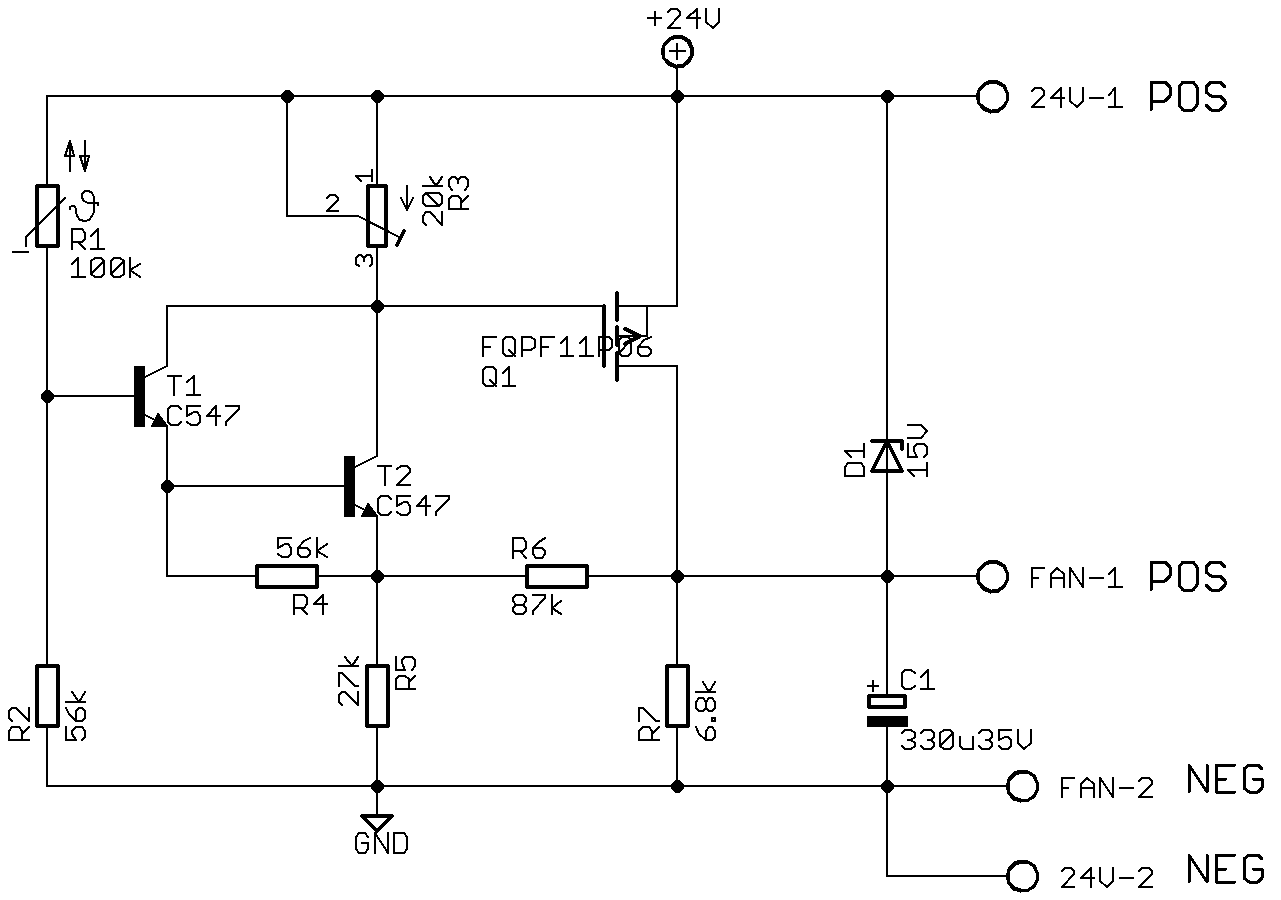

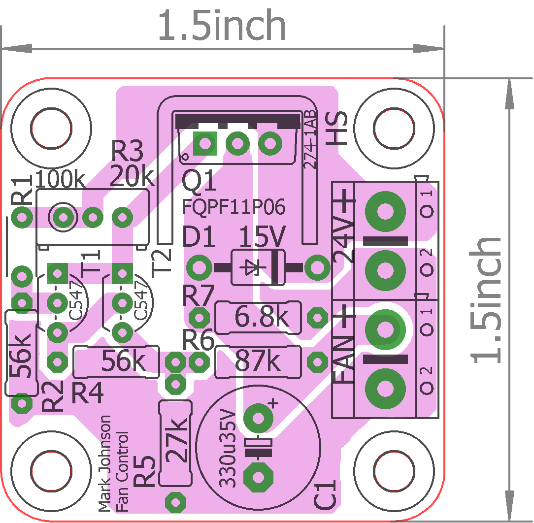

Hello Mark,
Is there any simple way to modify this circuit for 12V fan?
Also any of the IRF9510 can be used?
regards
Prasi

Noctua fans are indeed delightfully quiet, although their price seems a bit steep. They're available in both 4-pin (PWM only) and 3-pin (PWM or analog) versions. If you wanted to use Noctua 12V fans while simultaneously insisting upon an all-analog controller, in a First Watt amp running from a standard First Watt 23V supply, your options include: (a) use a 24V all-analog controller and simply connect two Noctua fans in series; (b) obtain a 12V all-analog fan controller and power it from a 12V regulator; (c) draw up a new and different design target Volts-vs-Temp curve, similar to "Figure 2" in post 1 above, with your new desired slope and Anchor Point, but which tops out at 50% instead of 100%. Then tweak component values until you get that design target curve; (d) and more.
A snippet regarding 12v operation
A word of caution: this circuit contains so few parts, that each individual part has an effect upon several different aspects of circuit behavior. In other words, everything interacts. Strongly. When designing or redesigning a circuit like this one, it takes a lot of tweaking and adjusting and juggling to get the circuit to work well. Fortunately for you, I have already performed this miserable job; it took me about a half a day to get it completely dialled in. The schematic in Figure 3 works nicely ... but only for THIS supply voltage (24V), and only for THIS choice of thermistor, and it only implements one specific design target curve of Temperature-versus-FanVoltage (shown in Figure 2).
If you want to modify the circuit to operate at a very different supply voltage, or to use a different thermistor, or to hit a different design target T-vs-F curve ... then you will need to tweak and adjust and iterate and juggle component values, to get your new circuit working and meeting your new specifications. It will take effort. Do I know of any time saving procedure(s) for this? Not really; all I can suggest is to thoroughly explore and experiment and keep good notes. And don't forget to have fun!

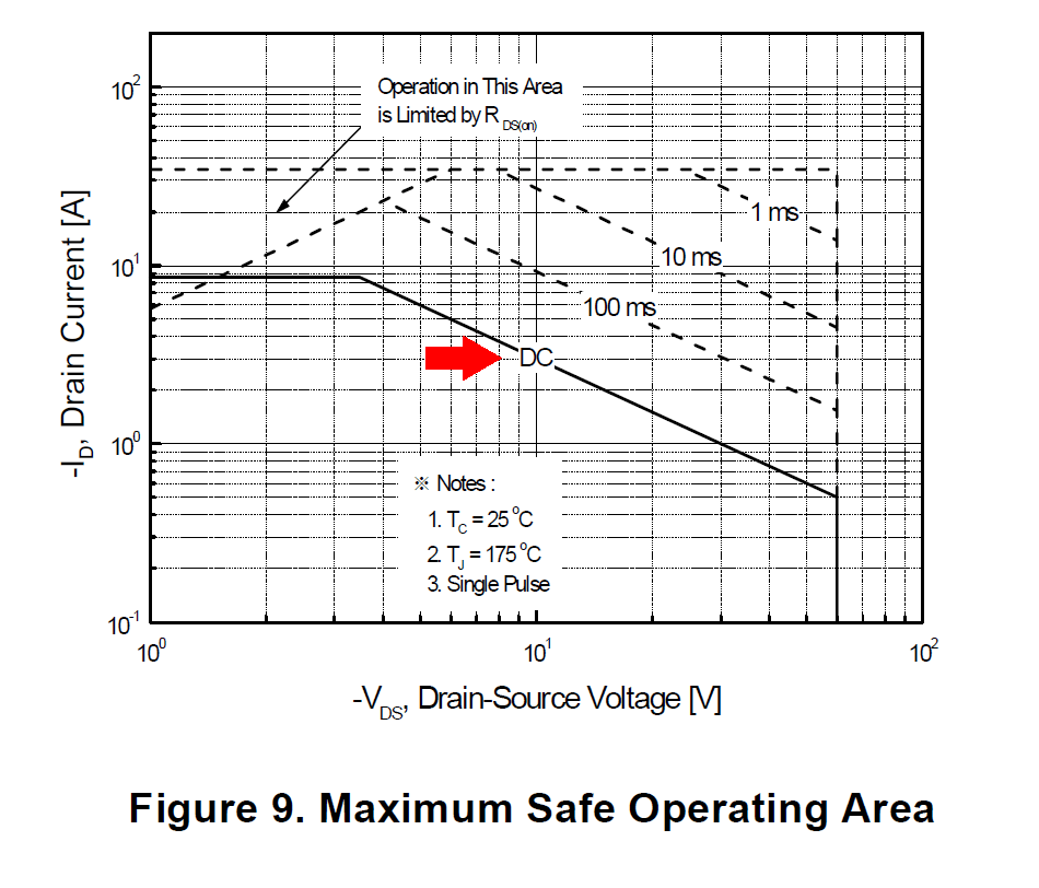

I like the fact that [FQPF11P06] is in a fully insulated TO-220FP "full pack" package, and requires no insulator between MOSFET and heatsink.
However if you want to use a not-fully-insulated MOSFET just make sure it has a similar gate threshold voltage, and that its dataseet safe operating area actually includes a curve for DC, and the fan current is way waaaaaay below that curve.
