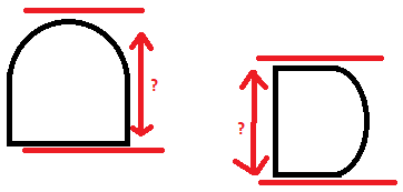

are these pairs fake or original?
I have varius 2SC2240 transistors, some are strange, some are original.
Measure the length and the width of the transistors please.
Measure them with chinese transistor tester and photograph the results.
Don't buy or use alleged 2SC2240 in any event. Its obsolete and will be copied, so buy Onsemi KSC1845 if you expect anything similar to original 2SC2240 transistors. In my experience, the fakes usually don't make the BV of 120V DC. Those of mine that do are similar in tests and appearance to MPSA42 or 43 copies and measure >200V.

hfe number of both bjt's is around 120 so they are absolutely fake
there is no original 2240/970 in market at all.
these are good just for garbage
found some geniune NEC 2sa1376/2sc3478 and buy them.

no i didn't buy tgem from ebay or chinese stores
buy them from local store in my country which are original NEC
they are a little bigger than regular to-92 transistors
If you already know they are fake, why waste our time asking here?no need to measure dimention
