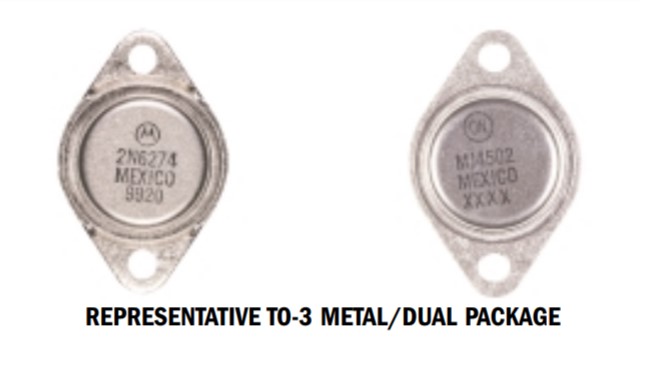

Yet we all know about Motorola/ON labels not being perfectly centered, and that´s saying it politely.
While everybody else does it right:
and the mighty:
or the equally classic *military* 2N3055:
China by itself does not mean iffy quality, would you trust this European (Italian) surplus dealer?
1.3 KILOGRAMS of TO3 beauty for only 49 Euro

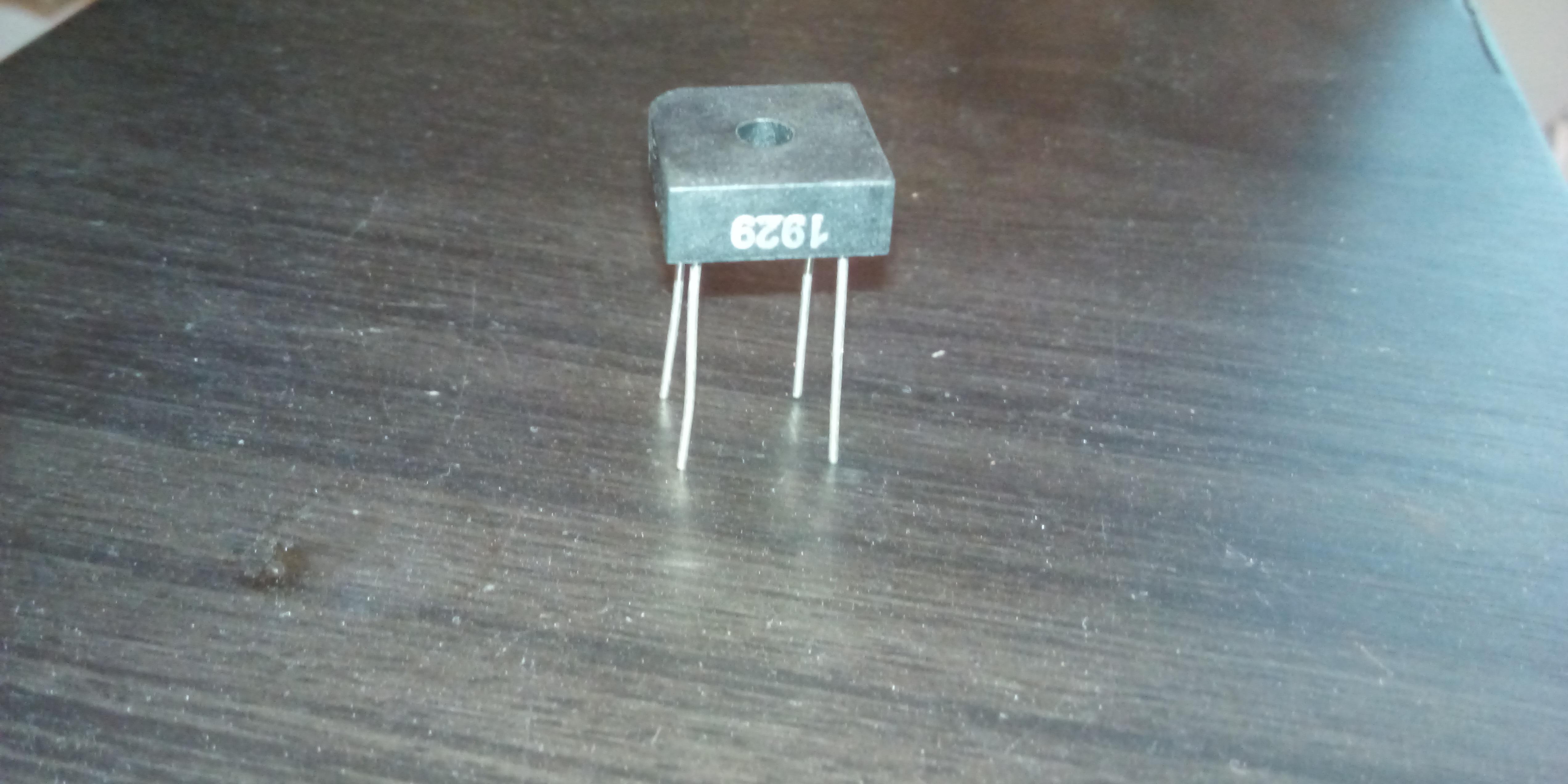

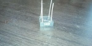

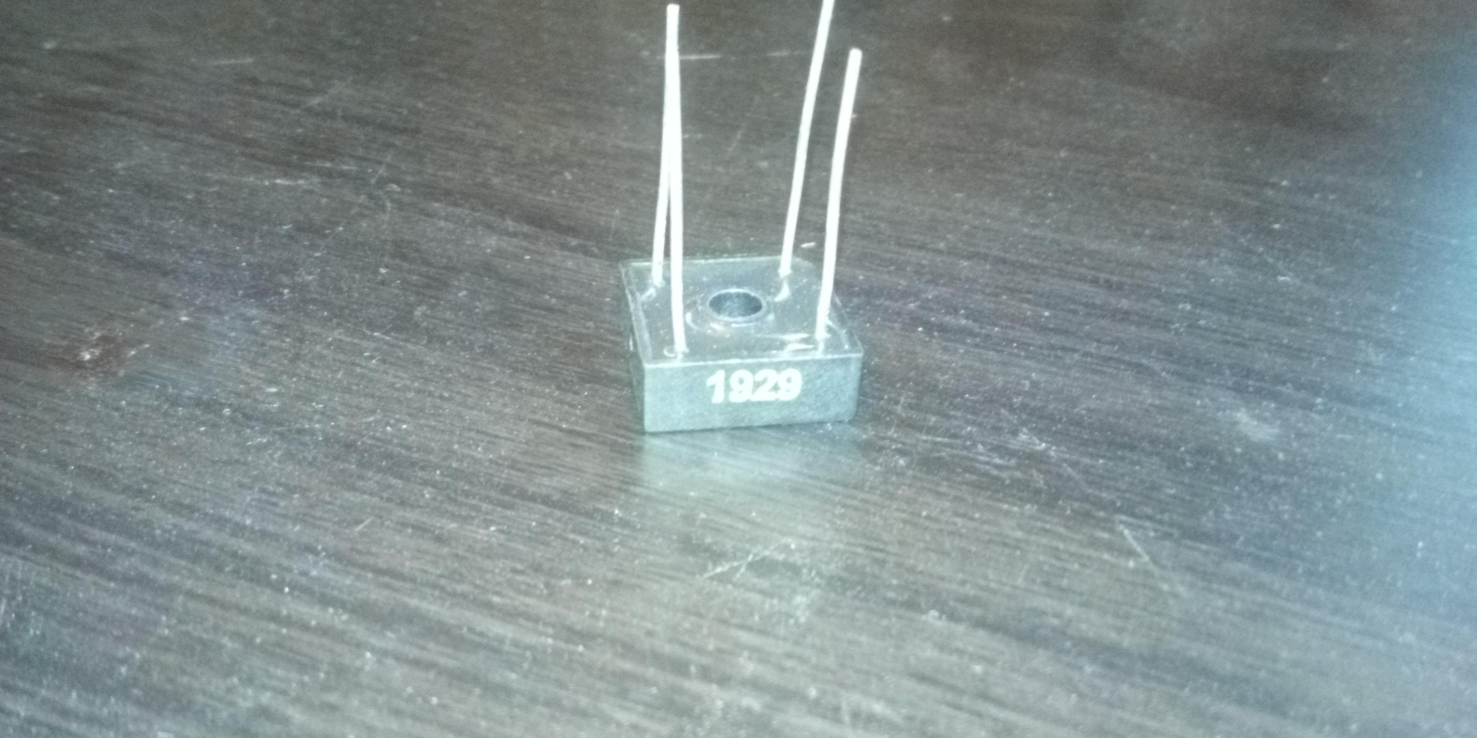

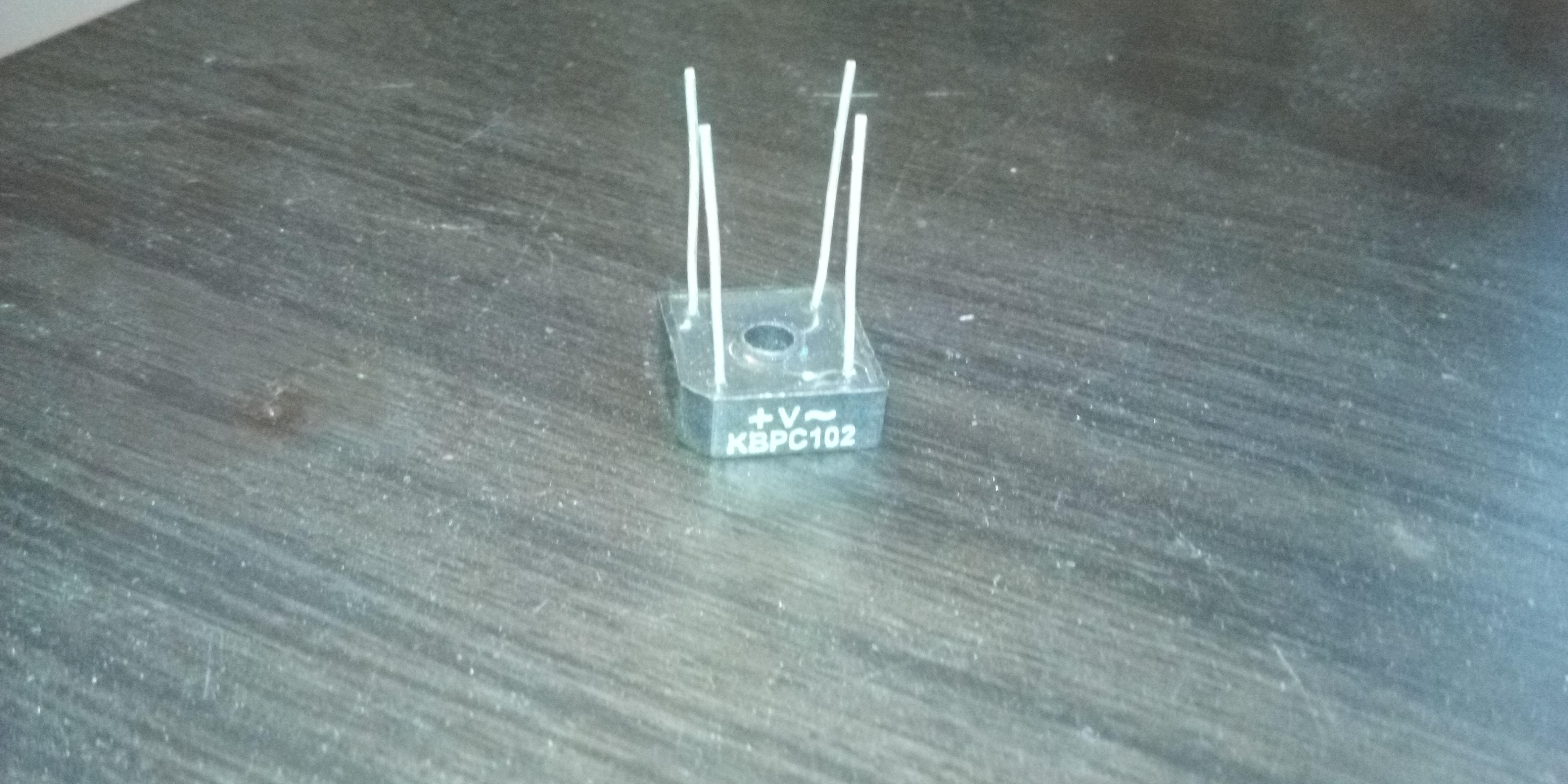

Glaswegian rectifiers arrived today, probably fake! i cant really tell just buy looking. i have looked at others online from reputable retailers, and the only difference i can see is the position that the characters are placed in are not as uniform as those in the online pic's.
gaz
gaz
They have the fuzzy/off color look of fakes , I checked my genuine same type versions , mine look professionally finished,black ,smooth , large current types have a steel casing , fine printing I removed from a well known communications giants own industrial equipment no longer required.
Not Glasgow but a "far east entity " , ask for the order paper work from a genuine "Scottish " maker of diodes that I know exists , those direct manufacturers insist on large initial orders from commercial clients.
You are not showing the most important part!!!
PLEASE show the package label, and stamps/post seals (if any).
Hide your own name and address but let us see where the package was actually shipped from.
Not impossible that "cousin living at Glasgow suburb" received and reshipped it from a local address but let´s check it.

India is now competing with China in the production of semiconductor parts including rectifiers I doubt the guy selling them to you would contact China as he is more related to India.
I am glad my comment made you laugh but I have come across many fakes that seem to be die-cast ( pressurized extrusion molding) with a "powdered effect " rather than a smooth professional one showing a more costly machine tool.
