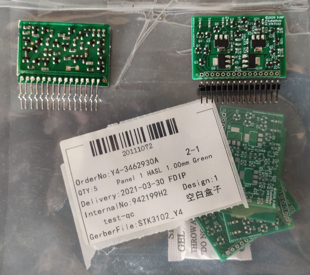

SO - with a nod from davidrsb (as I understood it) I turned to some family relation, who does small electronic production as described on page 3.
Will it be possible to produce a small number of STK3102 based om Davids documentation?
Yes it will.
Off course the price depends on how many we need, so therefore I must make a survey among you DIY's before deciding anything.
With caution I guees the price could be approximately 50 USD + shipping.
Yes it will.
Took this picture with an opened available "STK 3102" from AliExpress - upper left.
The upper right is the new one produced based on Davids files. Thank you David.
