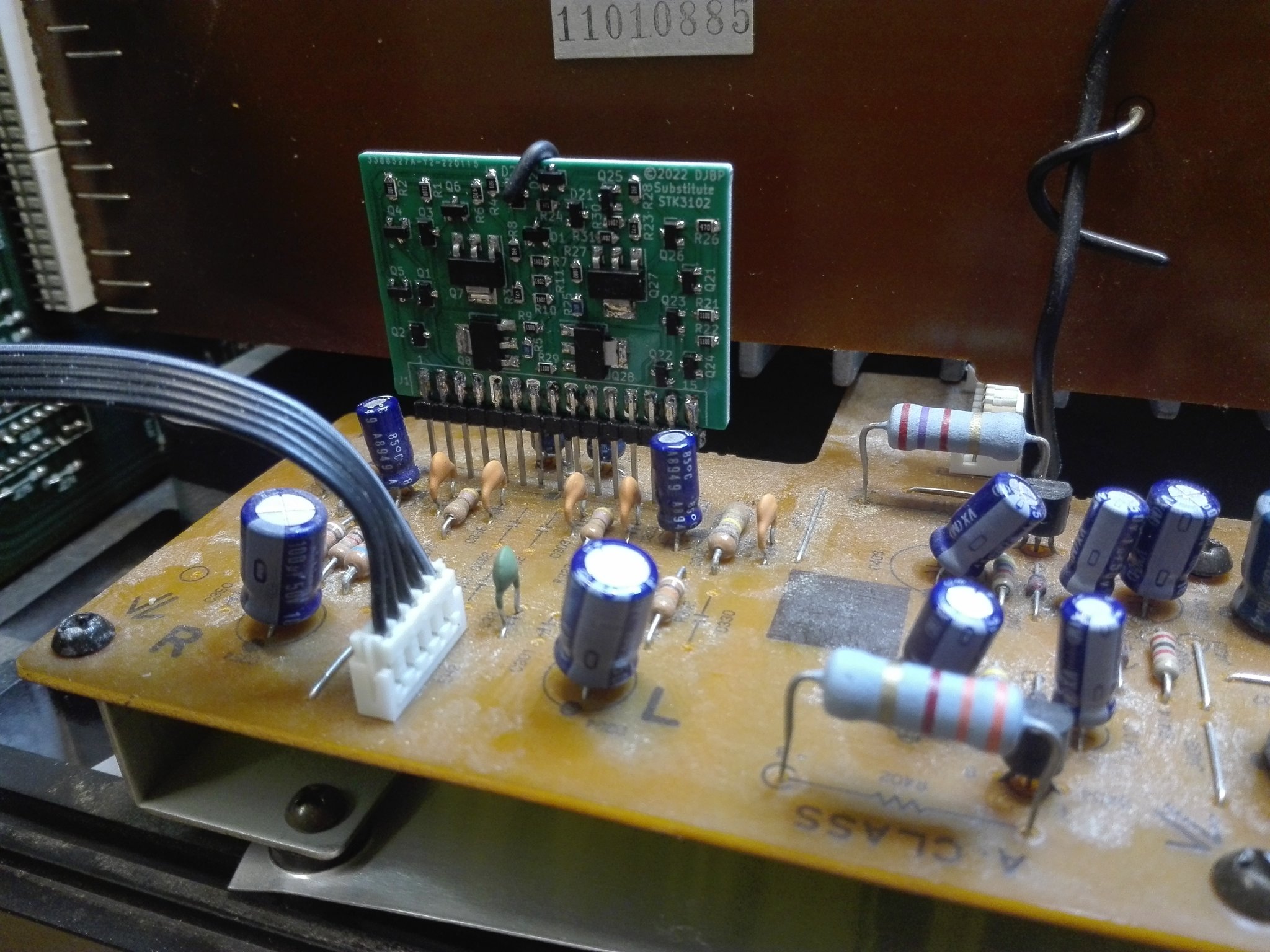

Hello, I was just planned to order a STK3102 in ebay...and now I really hesitate 🙂. The ampli I have is a marantz PM-80 and I am investigating but more and more think on a failure on this STK3102IV.
However, when I saw the soldering on the picture, cannot do this on so small. So is it possible to order it with components soldering and not only the PCB? Alternatively how to find a real STK3102IV? ( As my case is similar to pioux, guess french will get a lazzy reputation...)

If you order the PCB from JLCPCB or PCBWAY you can also order a solder stencil with the PCB. Then there are tutorials video online about screen printing the paste with the stencil. It might be an interesting new challenge to learn perhaps? Or perhaps not for everyone? JLCPCB can do the assembly but it is a bit of a learning curve in KiCad to do the BOM and centroid file if you do not have regular need to learn such skills.

I have not tried EasyEDA. KiCad is pretty easy once you get over the initial learning curve like any CAD program. But I think learning SMT stencil and reflow is easier than learning all the details of getting SMT assembled at JLCPCB with KiCad.
I have deliberately avoided using the tiniest SMD parts, to make hand soldering using reeled solder practical

David, regarding cooling, and if you are updating the gerber files, how about making it double sided with at lot of through-holes? and how about two 3 mm holes to enable an aluminum sheet to be tightly boltet to the pcb?

Why not build the aluminum PCB version? JLCPCB charges $2 for quantity 5 of such a small aluminum PCB. Airmail shipping is cheap.

Ok, I made this module for a Sony 530ES. Got it up fine. In idle all looking good, stable, bias adjusted. Measured a temperature of 45 degC, no worries.
Next step, apply some input - failed, heavy oscillation of the output stages! Both with and without a load.
Will check the feedback path.. but.. any suggestions?

Just to follow up - after a redesign of mainly the feedback loop (which had mismatched capacitances causing the oscillations), the Sony now plays beautifully.Ok, I made this module for a Sony 530ES. Got it up fine. In idle all looking good, stable, bias adjusted. Measured a temperature of 45 degC, no worries.

We have no information about the transistor die types used in the original module, so it is always likely that the clone module will need some compensation tweaking.
Many of these amplifiers were chasing headline distortion figures at the expense of stability margins

Right, and I think everyone is likely to run into this problem. In a test setup similiar to the original application note, I get oscillations as well.We have no information about the transistor die types used in the original module, so it is always likely that the clone module will need some compensation tweaking.

Changing this module will usually go along with changing the output transistors, even more stability concerns
