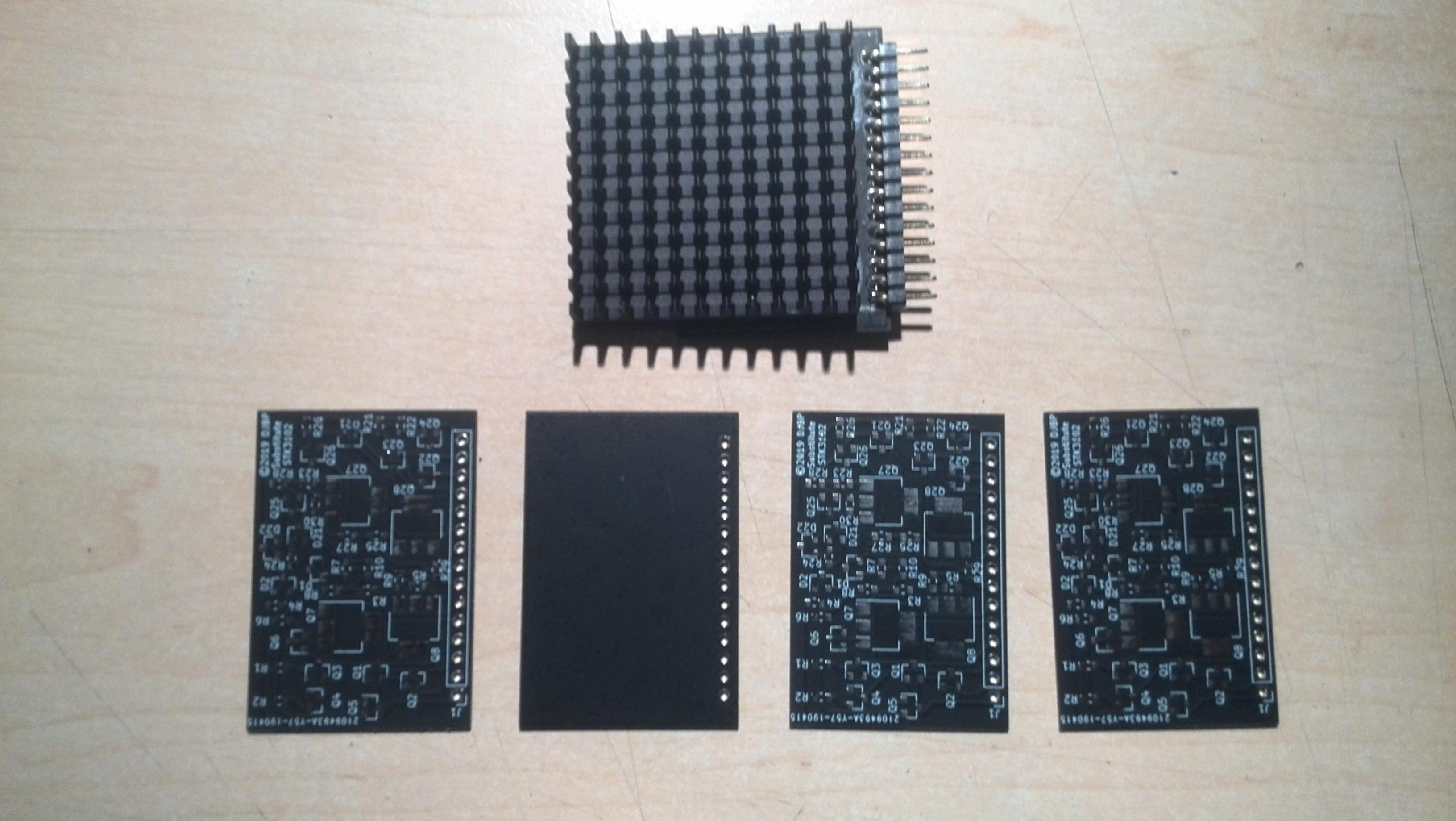

I recently purchased a defective Marantz PM80 MK1 amplifier. The STK3102 IV module in this amp has a short in it. The amp also came with one of the replacement PCBs discussed in this thread. The PCB is marked "2018 DJBP substitute STK3102". I believe the original owner got the PCB from a DIY Audio forum member. Two questions (for now) if I may?
1) Is the substitute module discussed in this thread a drop in replacement for the STK3102 version IV model or is the application only suited to replace a version III ?
2) Is the 2018 PCB blank I have fit for purpose or should I go with the latest version and BOM mentioned in the thread above?

I have no information about the Version IV, if you can find any information,I will have a look

I've not been able to find a datasheet for the IV version, but it seems that the III version will work in its place. That is actually implied at the start of this thread. I'm going to order up some of your boards and give it a whirl. Thanks very much to you for providing a solution to this problem.
If the boards work for you, please make a donation to a charity of your choice. I don't make any charge for the design.

Heatsink
Interesting that the topic of heat sinks has come up. I purchased a small heat sink and used the self adhesive tape it came with to fix the heat sink to the back of the module.
The heat sink doesn't seem to do much. The transistors run hot (like too hot to touch) but the heat sink is cool.
Please can I ask what is the preferred method to fix the heat sink to the back of the module?
Heatsinks on the back don't help much as the FR4 PCB is a very poor conductor of heat.
This is why a ceramic PCB has been suggested.
Another way to use a gap filler pad and attach the heatsink to the component side
Something like this Thermal Interface Sheet, 2.2W/m*K, 150 x 150mm 1.2mm, Self-Adhesive | RS Components
ohh ! I'll check that out
FR4 thermal conductivity is somewhere between 0.25 and 0.3 W/mK, so the gap filler pad is an order of magnitude better conductor of heat
