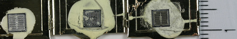

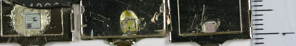

Hello All,
See by yourself what you get inside fakes : in pic1 you get 3 different 2SA1302 and in pic2 you get 3 different 2SC3281.
It is for this that there are classes of fakes.
As you can see, there are also fakes smaller than 3mmx3mm. I have 2mmx2mm too.😉
4mmx4mm are king sized fakes.😀 I have them ...
Best regards
rephil

Great pictures, rephil!

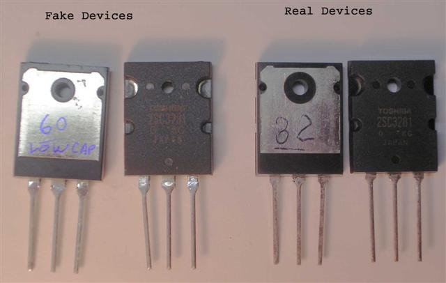

Hi Clem,
I aina gonna crack open a real Toshiba! 😱
I did measure mine and found 4 fakes (all 2SC3281A). They are mighty fine fakes at that! There were slight differences in the moulding hole (not flat and clear) and the mounting holes were not cleaned out (over mould).
Measurements were taken with an HP 4263A and 16089B Kelvin lead set. The leads were compensated just prior to the measurements. Settings were 10KHz and 100mV.
2SA1302A averaged 5n7 for the ones removed from a Carver Lightstar PCB, 5n4 for the newer batch I have.
2SC3281A averaged 7n2 for the used lot (5 pcs each) and 7n9 for the new ones. The fake new ones averaged 2n3.
A pic of fakes and good ones.
