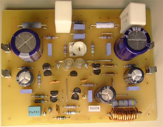

The first unit (ver 5.3) is almost ready for playing with. I am waiting for driver transistors. I may buy a bunch of polystyrene caps to relace the ceramics. My past experience leads me solidly towards these cap types. I can only find them in 50V. My input cap is 1 uF, 4u7 and 10uF both non-stock and expensive as sin!!
A shot of the board
-Chris

Hi Chris,
Thanks for the measurements! I see your board is coming along nicely!

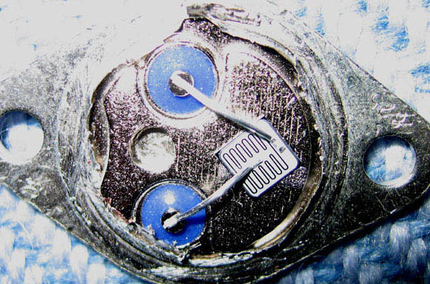

Anyway, this is what was inside those Motorola MJ15003/4 (the top cap was not easily removable) :
You could make your own judgement but to me it looks like an original, if not, its a damn good fake isnt it ?
Regards 😎

Manufacturing undoubtly looks like genuine On-Semi, however, be aware that they may be rebranded transistors from other On-Semi model. Rebranding transistors into higher power ones is a very common practice requiring very little knowledge and resources, unlike fake manufacturing. That may also explain why part number shows "Morotola" and dissolves into acetone so easily.
Rebranding higher technology parts like IGBTs and MOSFETs is rather easy too, so be careful.

They may be original and okay as well. Try pulsing the transistor within it's SOA ratings. On-Semi might comment (send pics) or compare the die dimensions with the Motorola handbook, or On-Semi. data sheet.

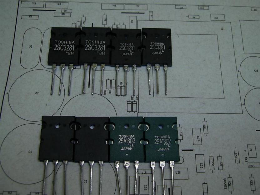

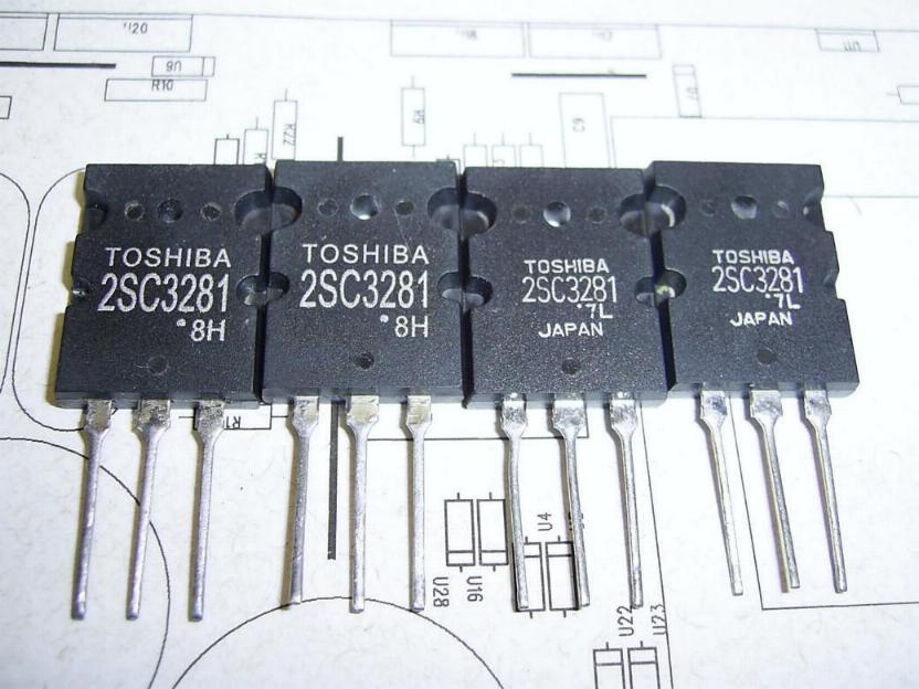

Refering to your first photo, the 2 on the top left look suspicious, missing the "JAPAN" is often a bad sign...
The 2 on the lower left look exactly like Toshibas actual manufacturing, and the right ones look like the older cases.
My guess is, that only the 2 on the top left are fakes, but only a guess.
Mike
Mike

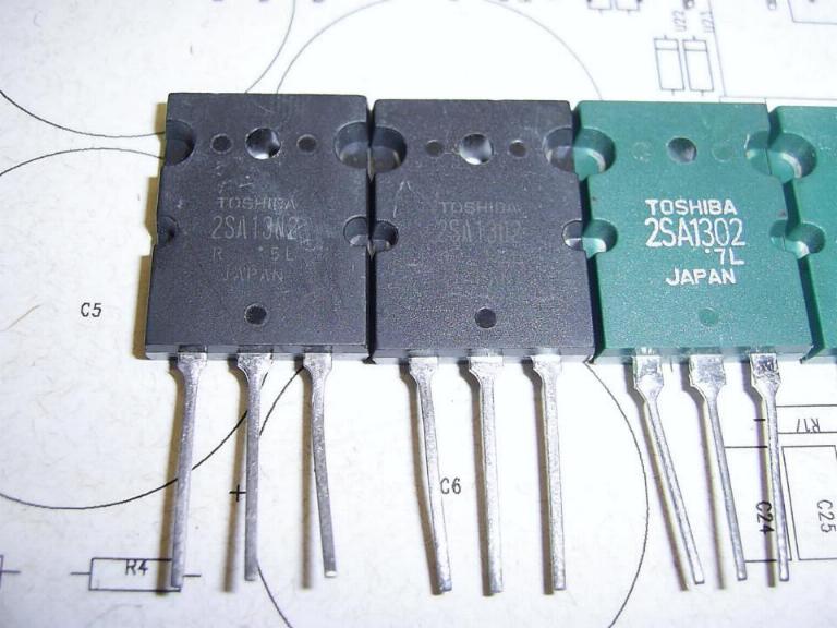

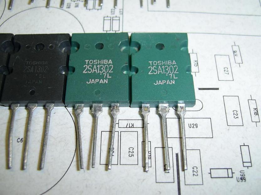

One thing I've noticed,the green-colored PNP ones generally tend to be The Genuine Product.
Alot of the time if you get a replacment for the green PNP ones,that isn't green,it's a fake. (though,it seems not 100% of the time.)
Did the original manufacturers stop using the green cases?
Some Genuine Original PNP replacments I got were in black,instead of green,but they looked original,and they seem to be holding up just fine. 😕
Maybe that's another detail we can use to find fakes?
Toshiba stopped a few years ago with the green cases, the ones on the lower left with the barely readable labels are the new style.
Mike
