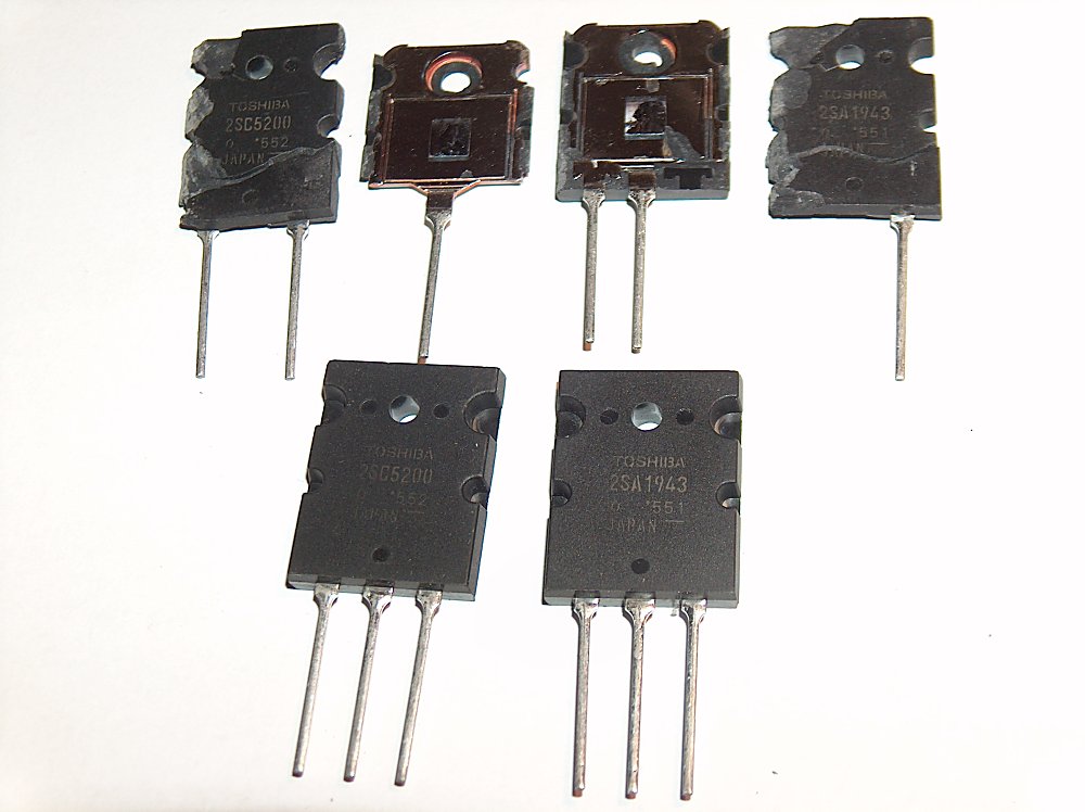

Motorola MJ15024
Hi everyone,
I need your help. I bought some Motorola MJ15024 transistors.
I think they are genuine Motorola. But aslo I am not sure. I took some pics. There are some damage inside. Because, I could open it via drill only.
http://img.photobucket.com/albums/v170/muffy1063/IMG_4532.jpg
Hi everyone,
That's as real as real can be - it would have been nice to have a close up of the lid decal so that we know what to look for when searching for authentic parts...
Those Toshiba's are at least 99% original. Don't think to much about this, I ever wondered about this paranoia here. I've never seen any fakes that are visual-vise not easy to separate from originals. Or do I see more than others 😉 cheers, Max

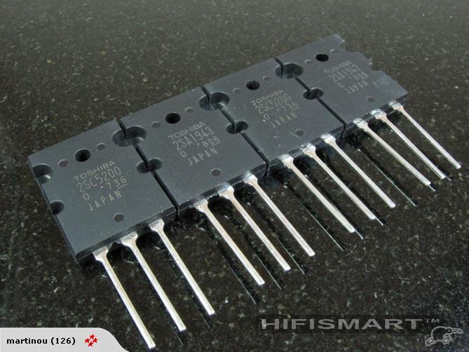

More Counterfeit MJ15024s e-bay
Please look at the listing:
http://cgi.ebay.com/50-NPN-MJ15024-...5|66:2|65:12|39:1|240:1318|301:1|293:1|294:50
Has anyone ever seen Motorola transistors with a mounting surface as shown? It is rough and uneven. Furthermore as far as I know Motorola does not make T03 output transistors now. I have used MJ15024s for many years. These must be counterfeit. This kind of seller is making e-bay a marketplace for crooks... Anyone who buys these is being cheated and effectively robbed.
