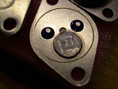

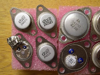

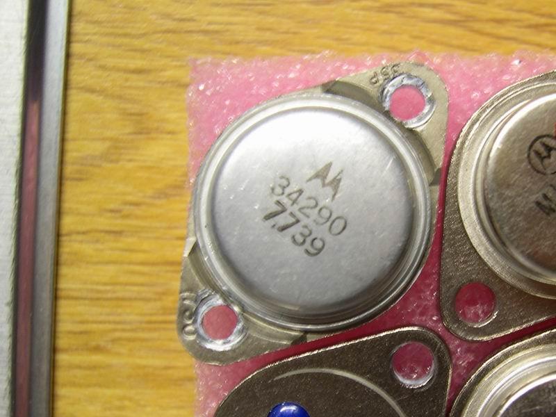

Recevied my second order yesterday, four matcing pairs of MJ1003/4 also two 2N6211, 2N3583. All of the MJ have the marking the wrong way, easily rubbed off, not using any solvents. Inside, the cooling plate is missing! The 2N ones seems to been painted gray on top then marked. Tried contacting Fibra-Brandt, no reply... Will post Pictures later.
OnSemi were also interessted.
Seems my vintage Harman Kardon will have to waith furter to be repaired. 🙁

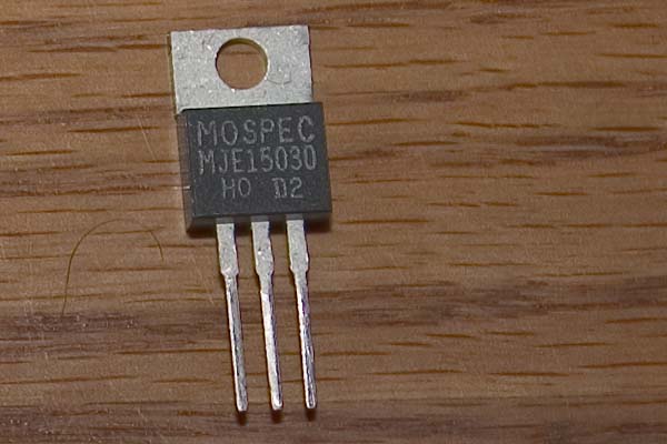

I don't think you'll have a problem with MOSPEC parts. They'e generic , but not counterfeit.
A counterfeiter would use the original logo of the original manufacturer, like OnSemi or Toshiba, etc.
MOSPEC is a generic manufacturer of parts that have come out of patent, and they make parts that perform to spec. You just don't pay for the brand name.
