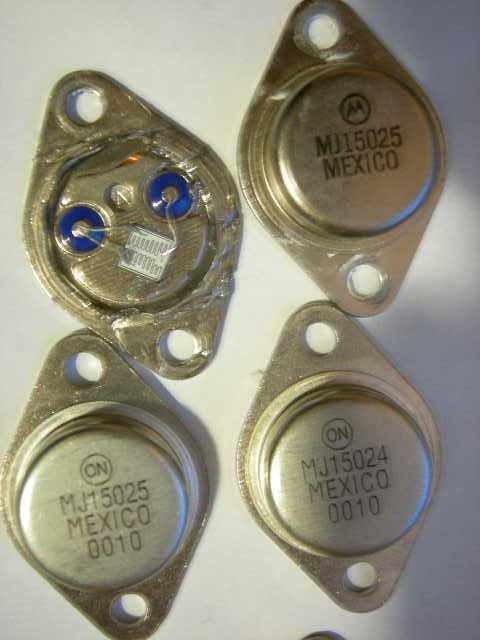

Hey nando,
hope this help, first two are original Motorolas from an altec lansing amp I repaired, notice the big die and two colletor wires.
the two at the bottoms are original ON semi samples from my brother who works as an engineer fro ON Semi. Will take a pic of fake Mot on my next post.

Yes, I opened many transistors, and I know the diference inside between the original ones and the fakes...
But, how do I know if they're fakes or not when I'm buying them??
Testing? SOA is out, I can not burn their fake transistors...
Still in the air... Any good method to indentify?
I read some time ago about HFE here, did you guys found any thing related with hfe and fakes?
Thaaannkkssss !
