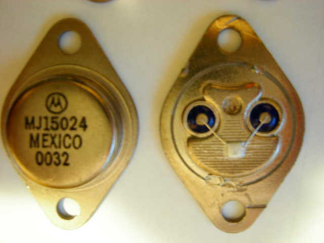

ECS21 said:pic of fakes motorola transistors
These devices seem very strange, because the manufacturing seems almost genuine On-Semi, including the shape and size of copper base and the bonding wires, but die size does not match MJ15024. Might they be rebranded lower power On-Semi deivces?

Hi all,
The fact that my pic of the fakes still have the logo of motorola with a date of the 32nd week of 2000 confirms that they are counterfeit. I think motorola became ON around 98.

OnSemi had it' s stock IPO in April 2000.
Is it possible that the factories didn't change their logo marking dies till later in the year?
I'd have to make some concession to uncertainty.
