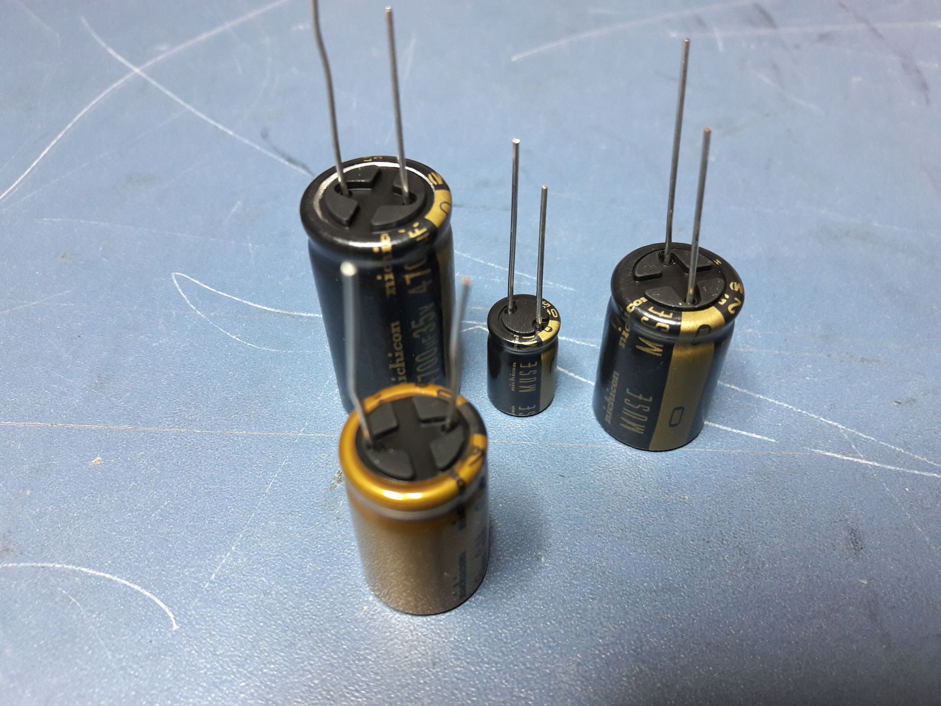

I used to use Nichicon caps both type from your picture, they look orig to me ....
yes they are original. as i wrote -no ebay dealer - ists mouser.at or mouser in your country

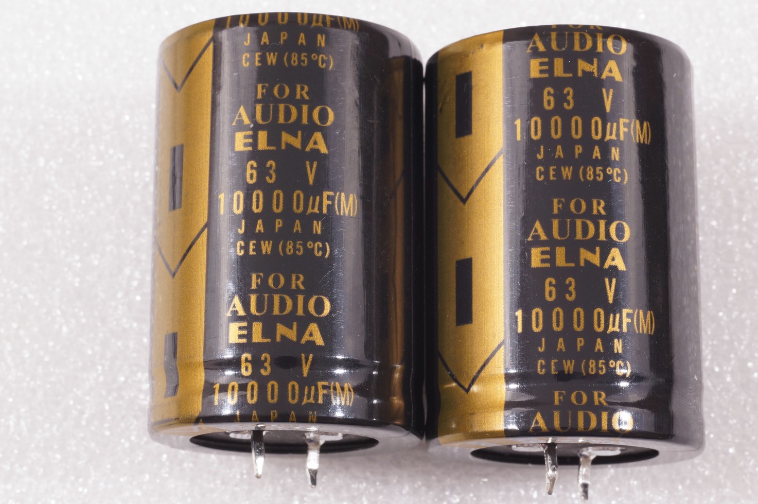

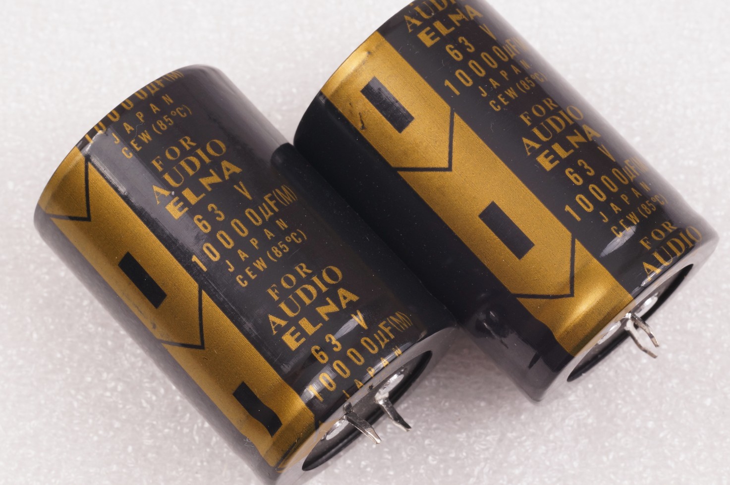

I've got some caps stated "ELNA LAO 63V 10000uf" from this guy
2018 Black Bolsa Elna For Ina's Top For Audio Stereo Filtering 10000uf /63v 30*50mm Electrolytic Capacitors Free Shippping-in Capacitors from Electronic Components & Supplies on Aliexpress.com | Alibaba Group
The sword is there but Elna LAO 30x50mm would be 4700uF only
http://www.elna.co.jp/en/capacitor/alumi/catalog/pdf/lao_e_p191.pdf
so I guess it might be re-sleeved Elna LAH
http://www.elna.co.jp/en/capacitor/alumi/catalog/pdf/lah_e_p155-157.pdf
30x50mm 63V is indeed 10000uF - check datasheet table
it's ok caps, just not for audio series as printed on PVC sleeve.

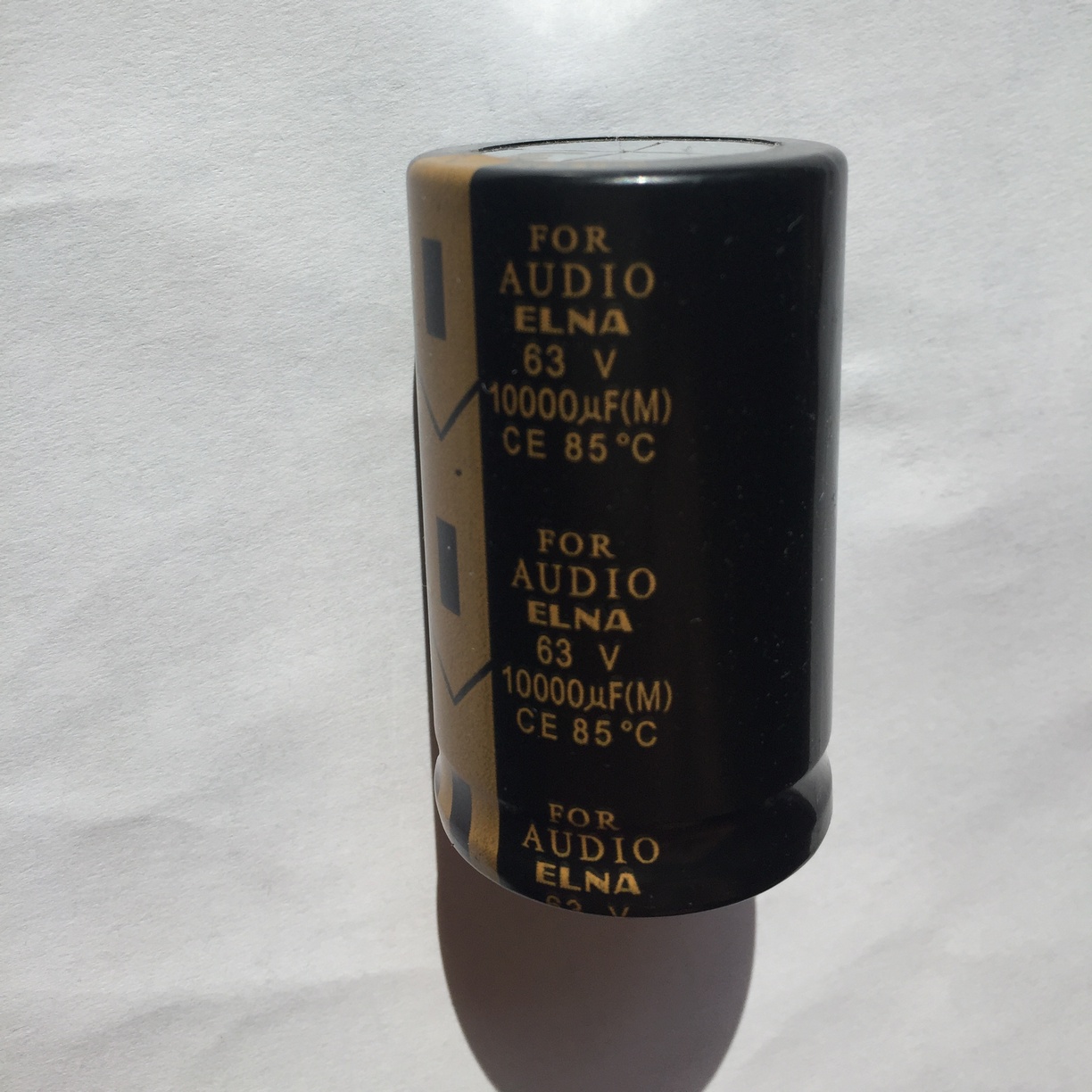

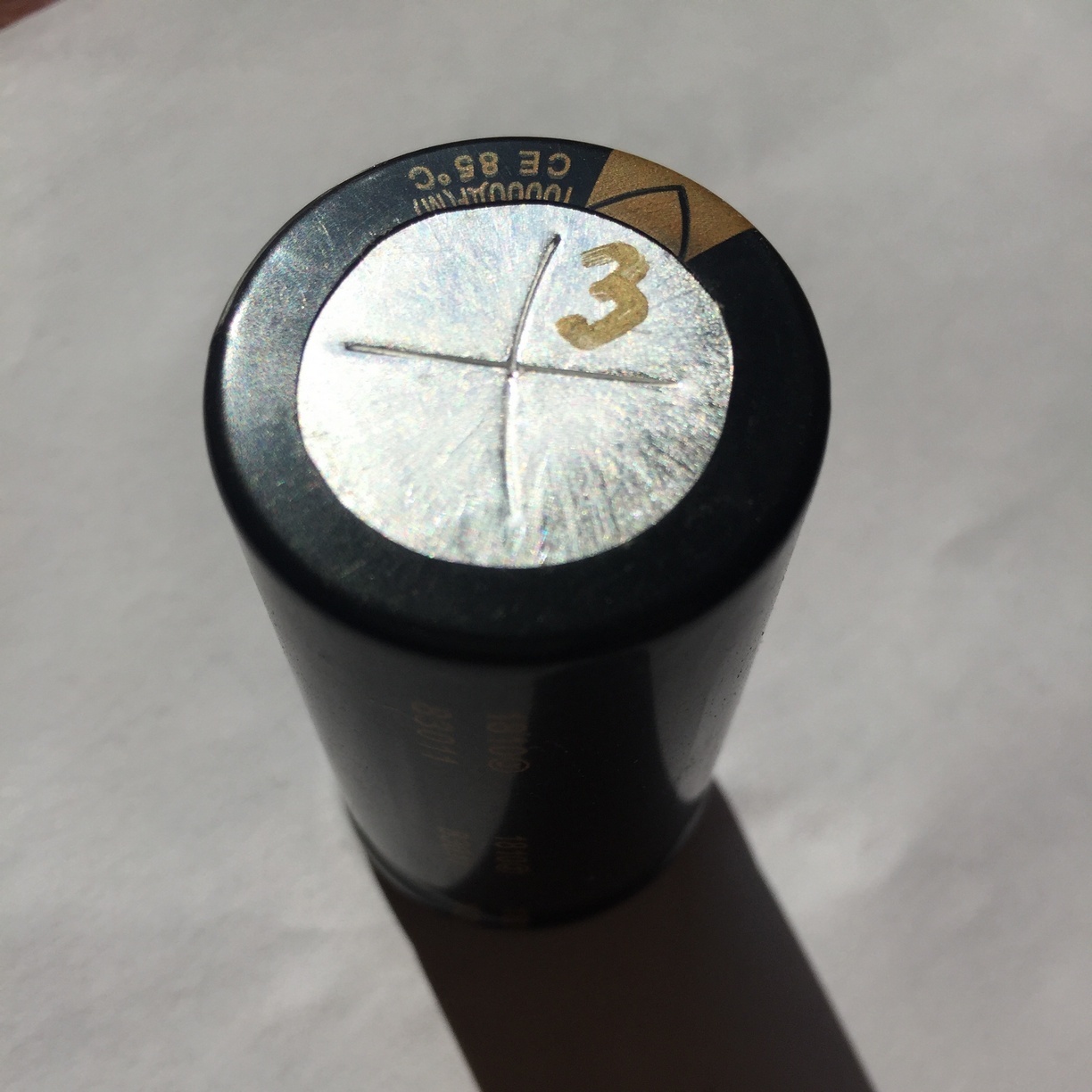

Ordered a batch of the 'Elna LAO 10,000uf 80v crapacitors from ebay seller: bsitsgood
The items arrived damaged and the crap printing quality on the sleeves were quite obvious that they were fake. The physical dimensions measure 35mm dia. x 50mm high, capacitance does measure to around 9,500uf and they do have a bit of weight to them.
When I questioned the seller about their authenticity, this is what they responded:
"I saw your feedback, but the capacitors is original elna, though you can not find the datasheet from Elna site, and you can not find the datasheet of all Elna capacitos from ELNA site either, those audio type capacitors are specially made, only can be sold to some special dealer"
Surreee, special dealer eh.....!
Facts: Elna datasheets for LAO series only provides a 4,700uf at 80v with a can dimension of 35mm dia and 50mm tall.
At best these are either re sleeved LA5 with the same electrical specs.

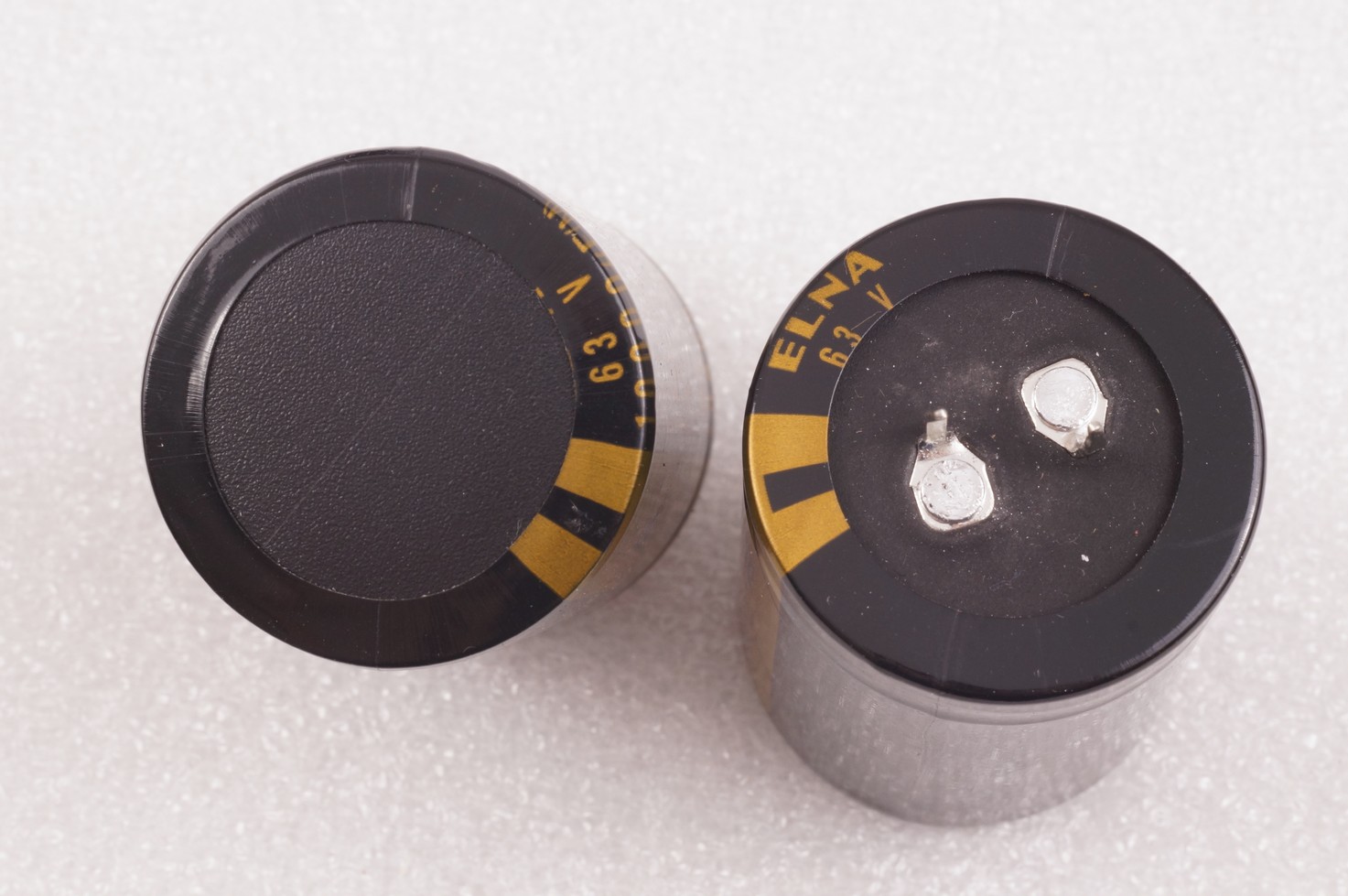

ELNA 10000uf 63V for Audio - Fake ?
Hello.

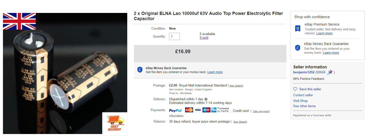

I normally buy such things from Mouser, but this time needed two 10000uf 63V caps and bought them from UK based eBay Seller.
The title clearly says original - "2 x Original ELNA Lao 10000uf 63V Audio Top Power Electrolytic Filter Capacitor"
I got them today and I have my doubts
The finishing and printing definitely look fake to me.
They look different from the photo with black plastic 'cap' on the top.
There is no any writhing, printing or coding on the other side ? 😕

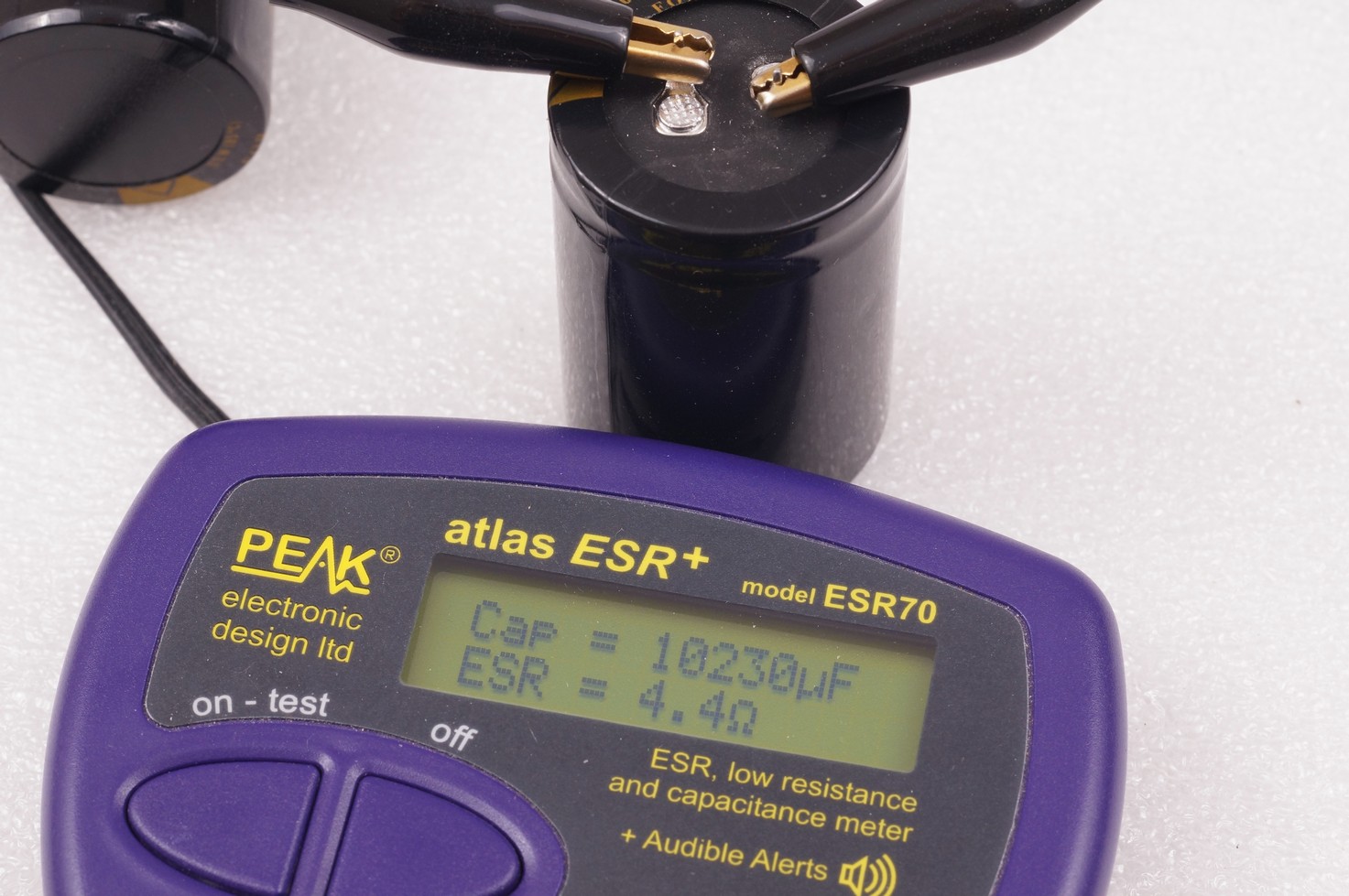

Their dimensions: Length 52mm, diameter 35.2mm, Weight - 60g

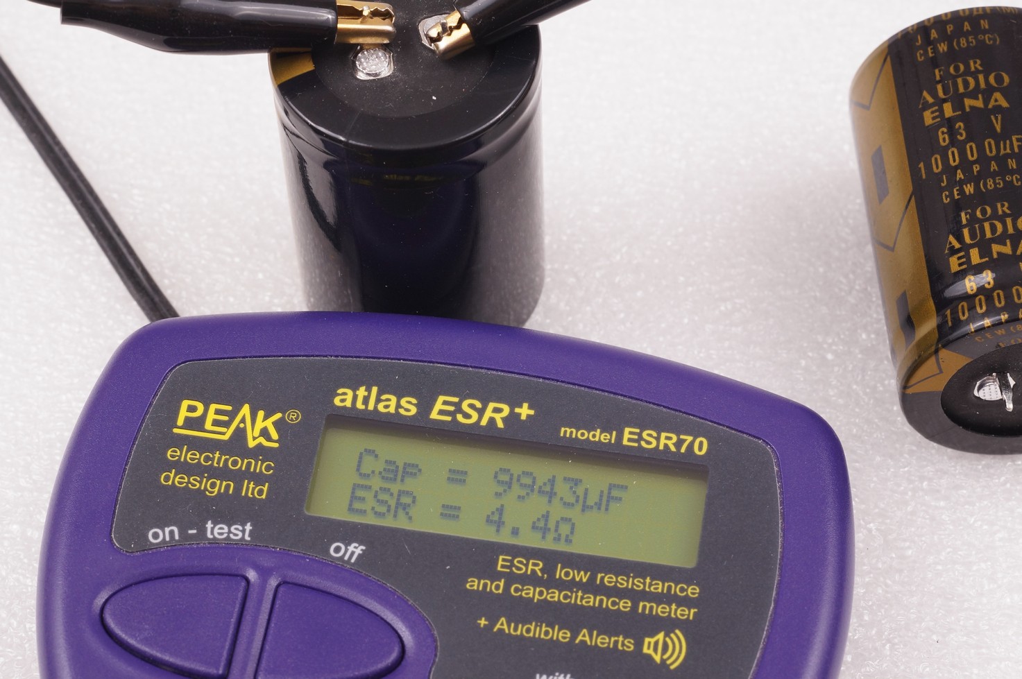

Measured they look fine, just for comparison I added two additional 10000uf (50v) caps that i got here from Mouser.
I just wonder if they are really fake and contact the seller or keep them ?
Any way to clearly prove it ?
Any hints are welcome. Thanks.

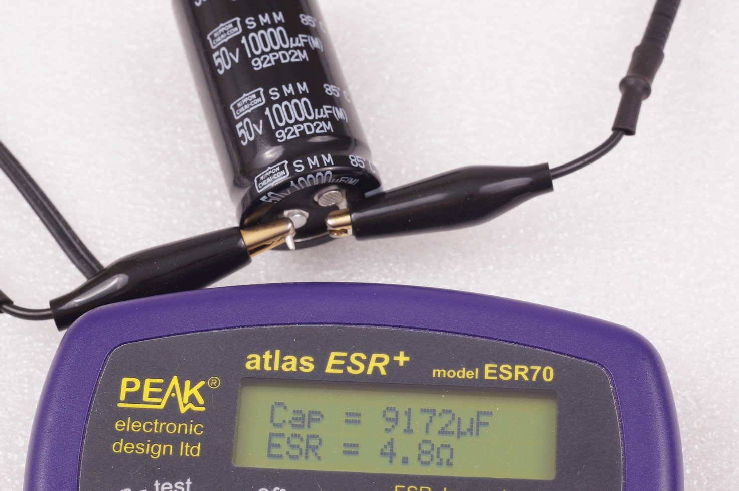

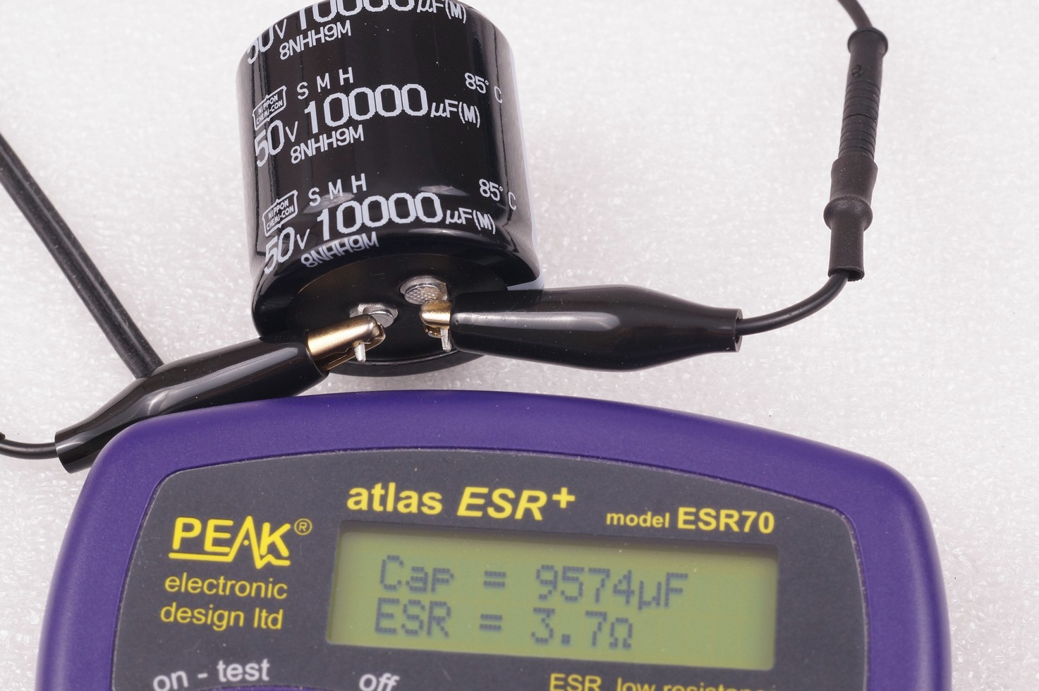

I have some of those "ELNA" capacitors. I tested them for leakage current and capacitance. In both tests, those capacitors I have passed well within specs.
"Elna" is a brand but it does not mean the capacitors are made in a particular factory or even in Japan. It seems that many of the more main-stream brands produce at sub-contractors, even in China.
Then the question becomes, what is genuine and what is fake?
If you want the best chance that components are genuine, buy at reputed suppliers. If you buy at less trusted sources, the risk of ending up with "a fake" is no-doubt bigger. As long as the component is performing within specs, you will never know for certain if it is genuine or fake. It could even be a genuine that was discarded in test due to non-compliance with the specs.
