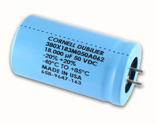

I just ordered 8PC Cornell Dubilier capacitors from US
With shipping cost and tax it cost almost as much than 8 PC Elna For Audio at least I know these are not fake. Made in USA and purchased from US.

These CND not audio caps but that not mean they can't be good
