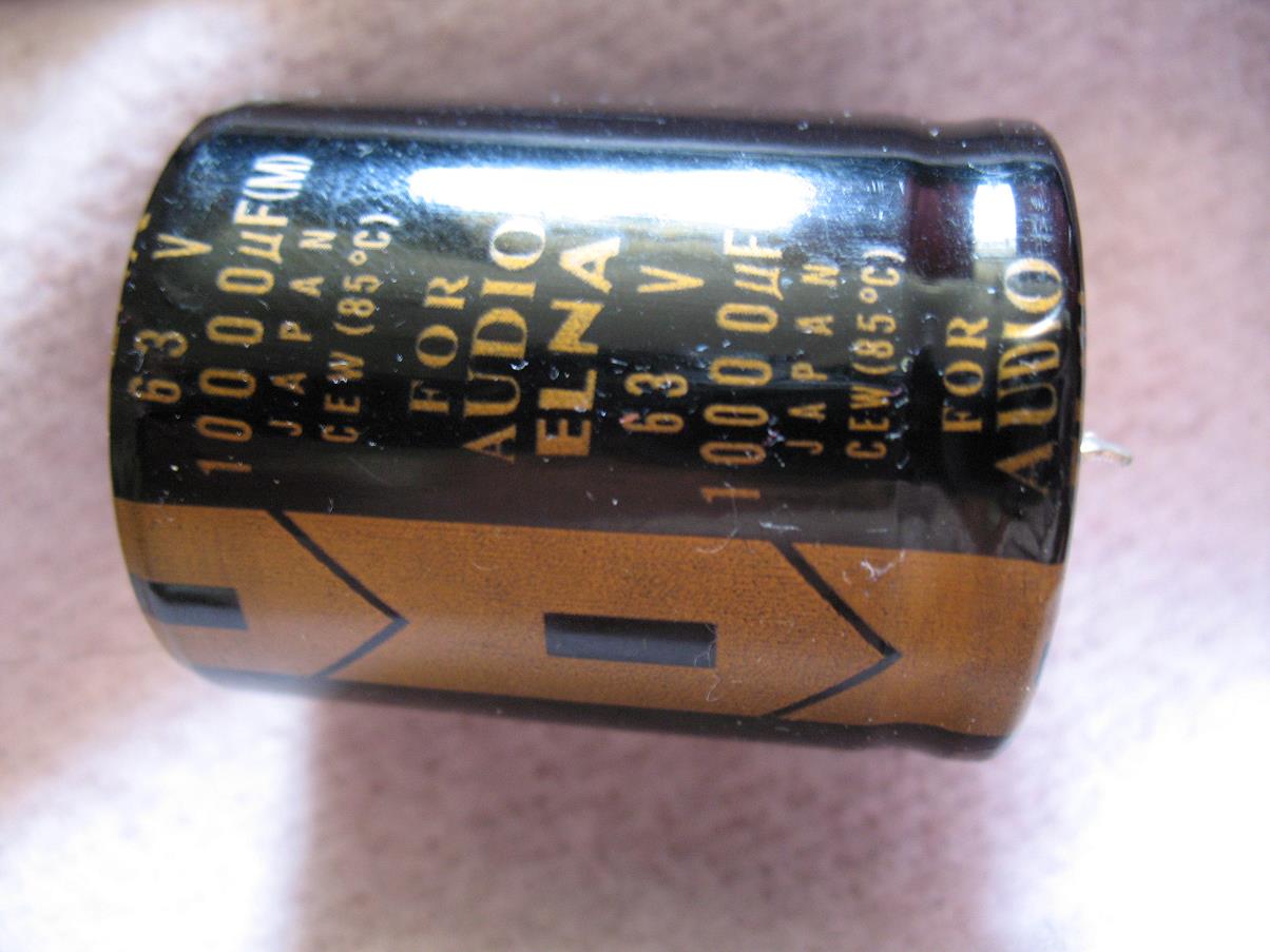

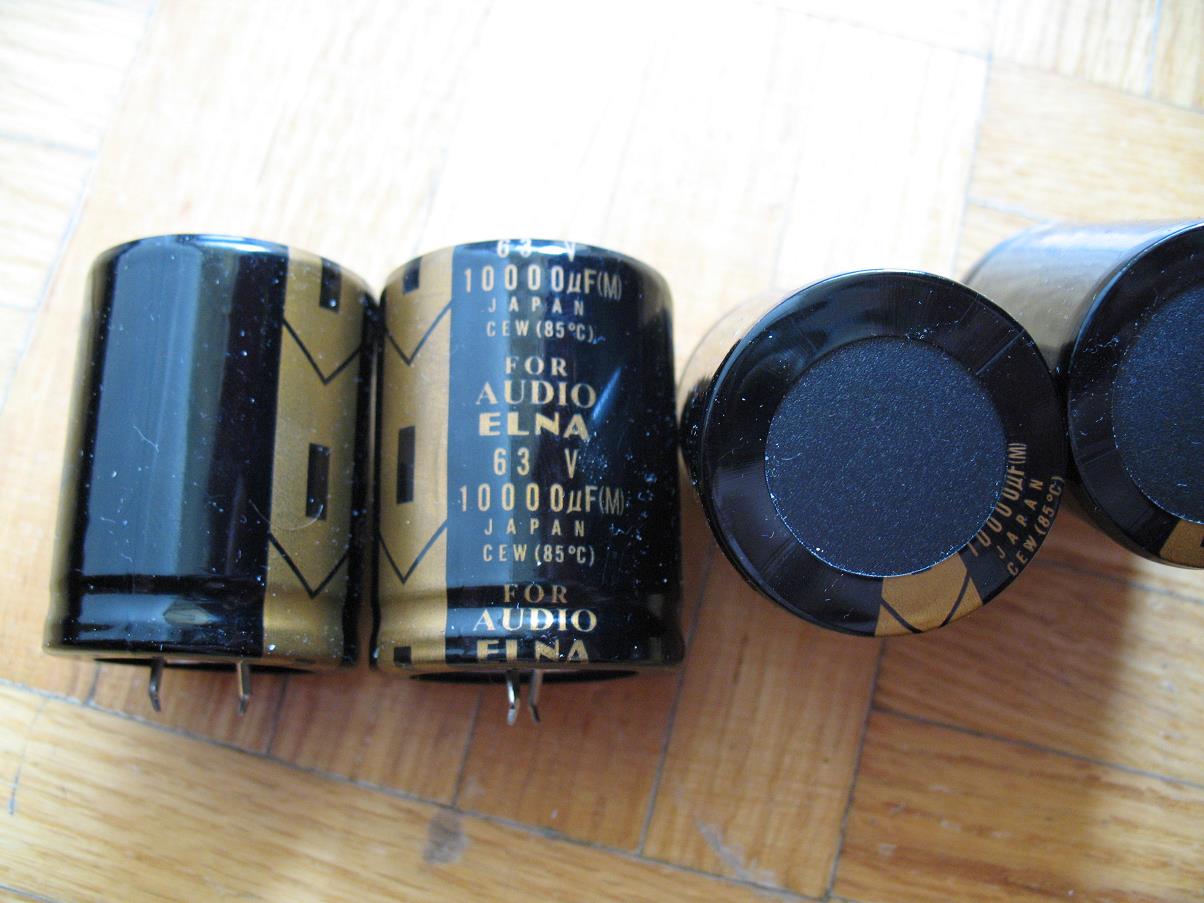

Same vendor has ELNA for Audio with proper top, but that is still no guarantee of genuine.
ELNA High Quality Electrolytic Capacitor 63V 10000mF - Audiophonics
And accordig to the "top", this is the real deal 🙂
This is definately a fake
