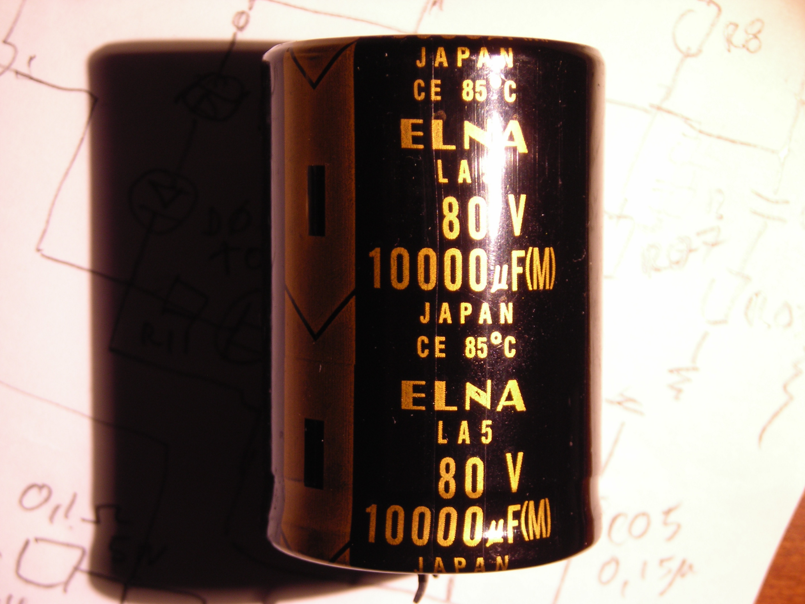

The Elna caps I've seen are labelled with the series name. The LA5 series seem to have these markings, but the alleged LA0 pix I've seen do not.
Is it possible that audiophiles invented this part in their minds and the people who are selling them are just selling a dream?
Then, based on the available evidence any LAO 10,000 uF 80 volt cap has to be fraudulent because Elna doesn't make any such thing.

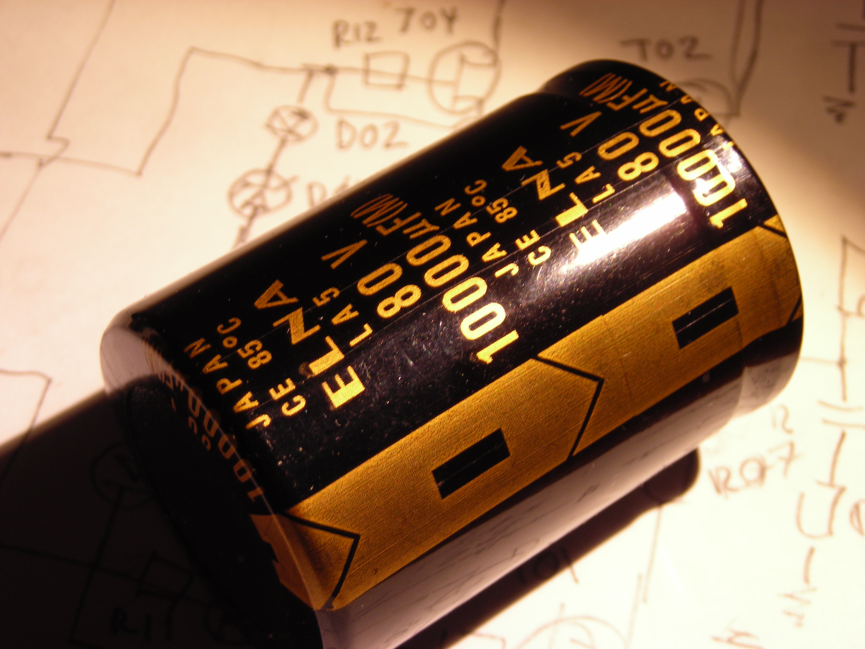

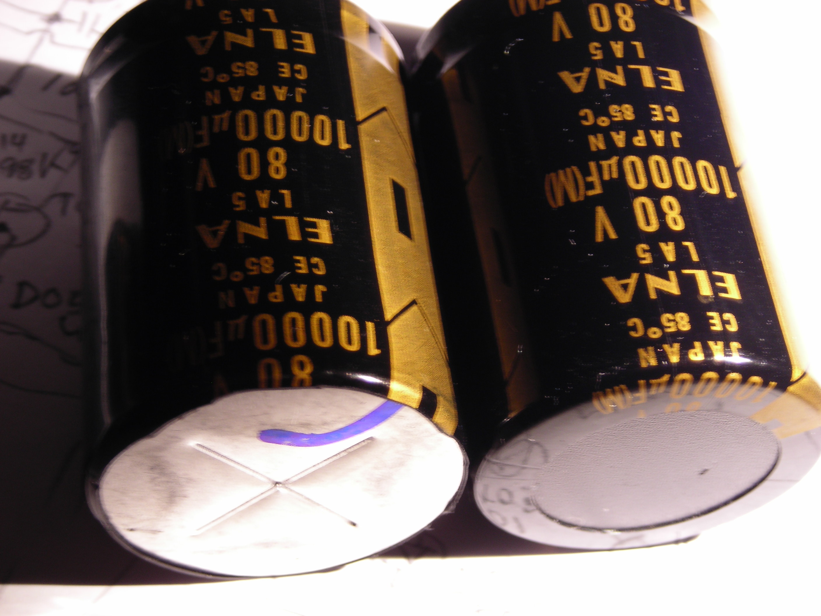

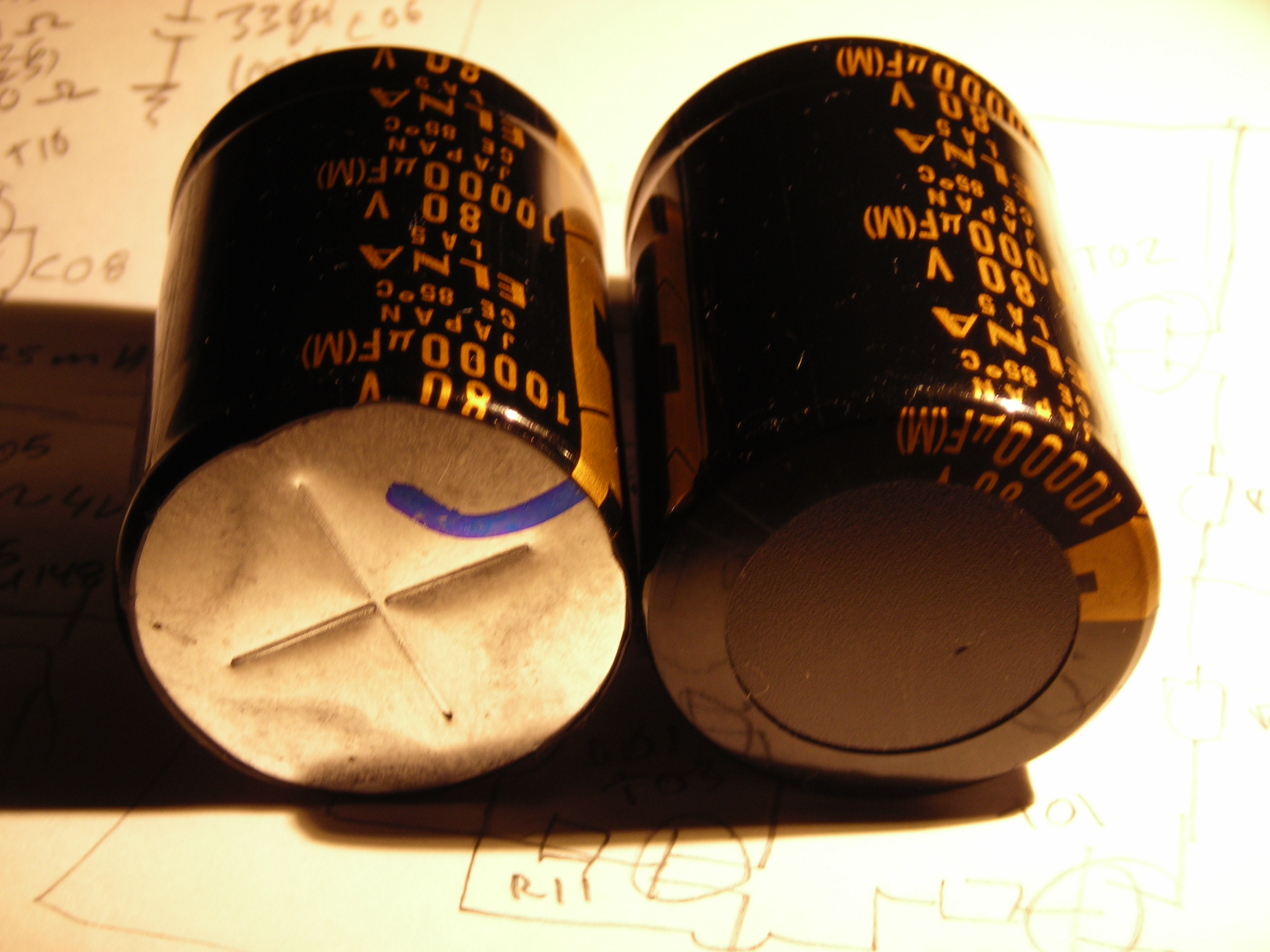

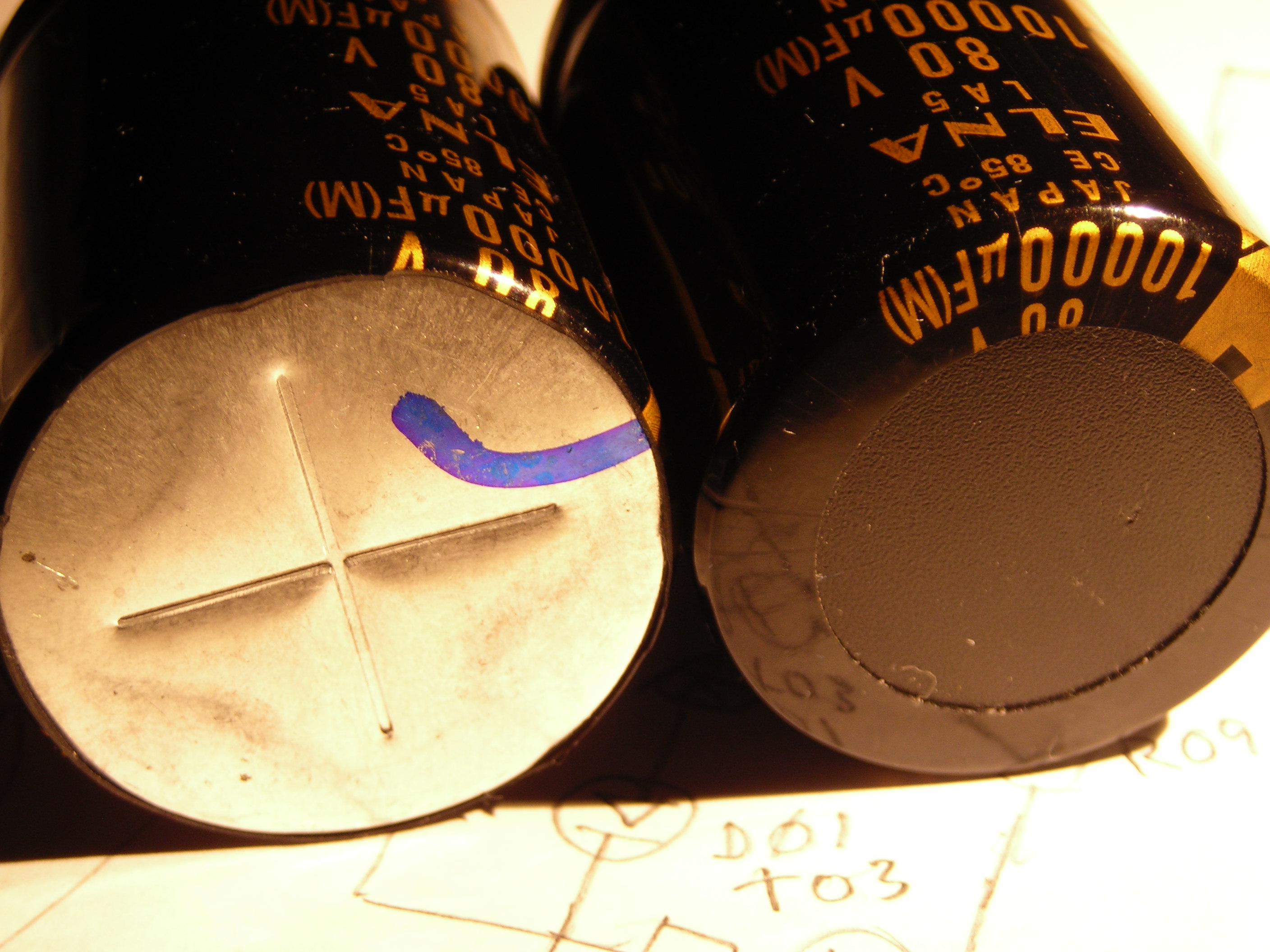

I meant cut the plastic from the top, 95% sure not even a product from Elna
Cheap industrial type caps re heat shirked- take a look at the latters of my caps.
The original made in Thailand and has no plastic on the top, also it has the Elna symbol.
Yes, I already showed the caps "sharpseller2000" sent me and show them here again.
On one I have cut the plastic on the top!! to see if it's a genuine elna....😱

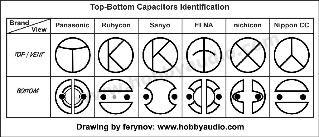

I found a site (pic 6) with typical top and bottom can pattern, and according to this it is a Nichicon or another no-name chinese cheap stuff.

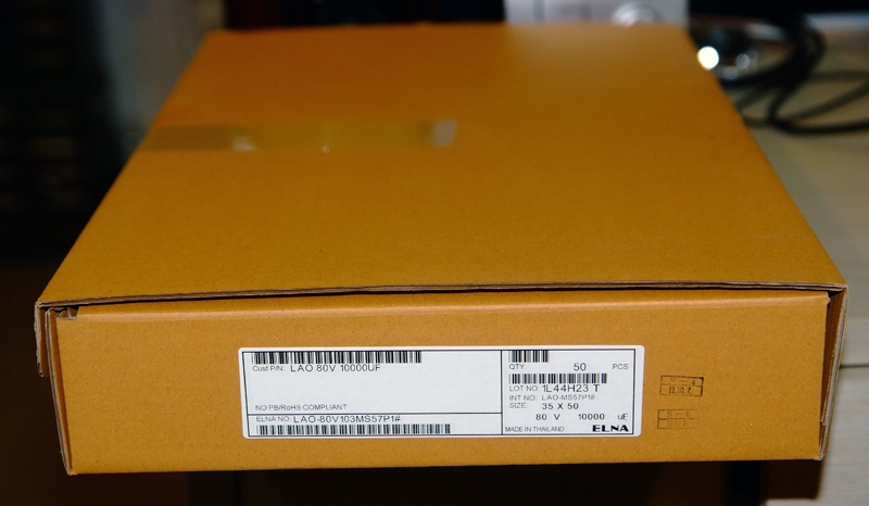

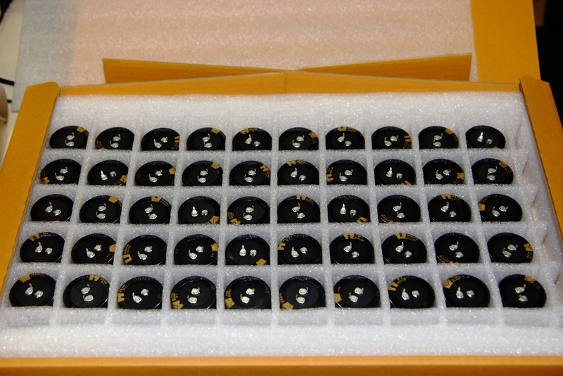

On another sellers site, I found these pictures of an claimed to be original ELNA LAO capacitor box from Thailand, so maybe they exist....?

Probably it is a couple of suppliers that put counterfeit sleves on some cheap no-name brands. These caps are good enough to pass as the real thing in the not-so-demanding audio (not very high constant ripple current in audio use to heat them up and blow out)
As I wrote in my earier posts in the beginning of this thread, when I measured my counterfeit caps, the leakage current was still very low at 80VDC +10% (and the capacitance was inside the 20% limits) so an immediate catastrofic failure was not to expect due to high voltage.
But the ESR (Equavilent Series Resistance) was higher and life expectancy (due to poor sealings and/or low grade materiels?) can not be estimated.

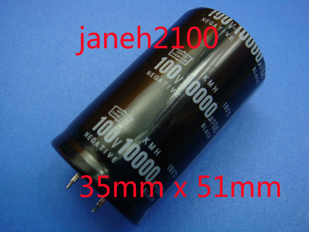

For interest I asked about this NCC "Super-ellyt" 10000Uf 100V in a 35x51mm can from janeh2100 !!! 🙄
I asked how it could be possible:
I can not find this size for 10000uF/100V in the NCC KMH catalog.
How come you can have it?
and they answered:
hello,client
we only have 10000uF/100V KMH ,without NCC,hoipe you can understand and make sure before purchase.
best regards
Libby
This make me lose all confident in the Chinese e-Bay sellers.
