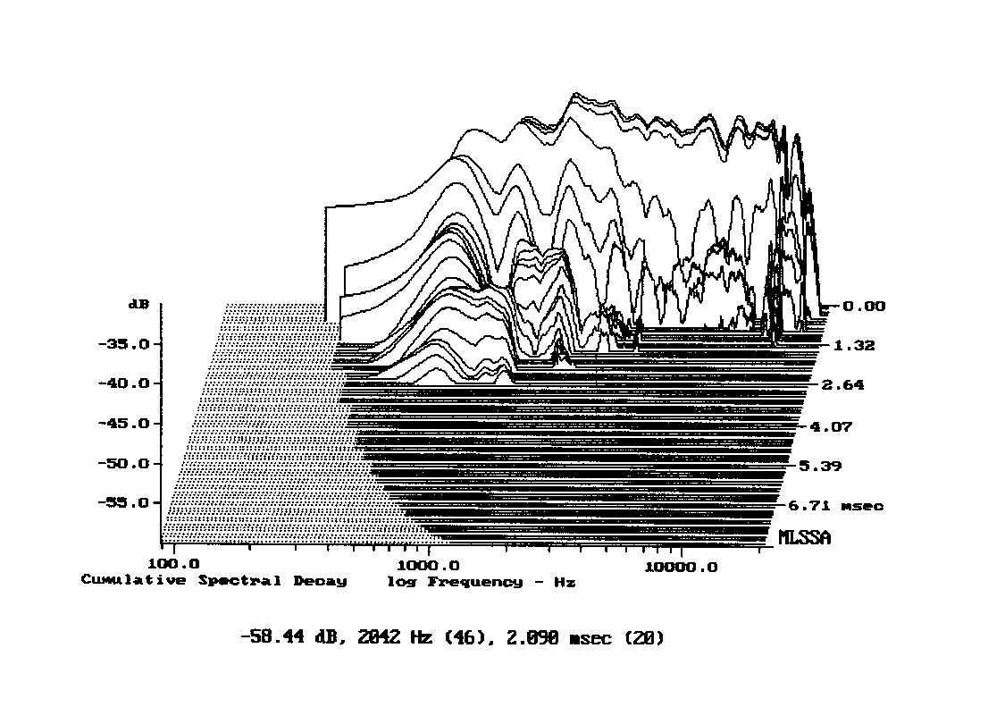

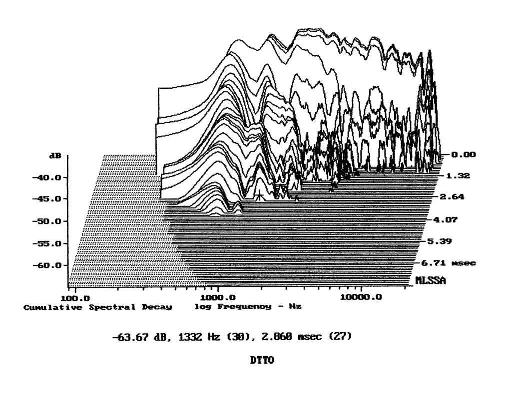

Waterfall of a DE250-8 from 2005:
Waterfall of a DE250-16 from 2014 with the same horn:

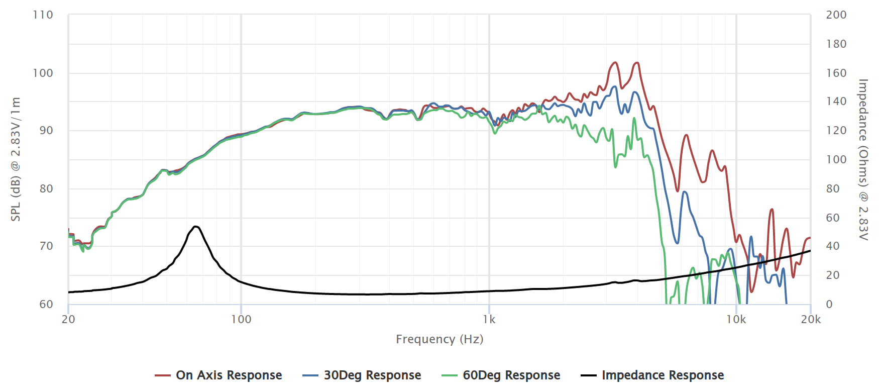

Why someone would pay € 429,95 for a mid with this response:
instead of spending €15 on this:
is beyond me.
is beyond me.
