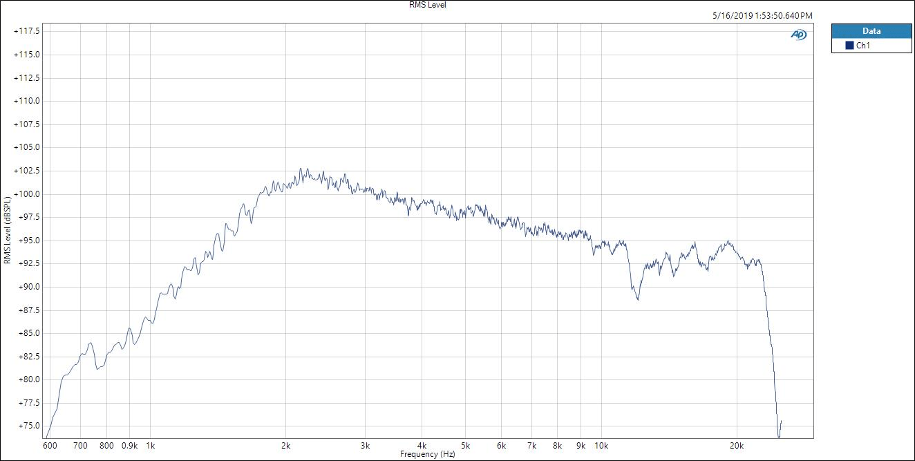

The STH100 HF111 combination is smoother, without peaks and valleys, than most. See the attached on axis plot from my bench. This is raw Audio Precession / GRAS data with no smoothing. With 2K crossover.
Thanks DT
What's the input test voltage level on that graph? Do they publish an exit angle on that driver? Is that including any baffle? Must have a deeper exit chamber than many drivers.
