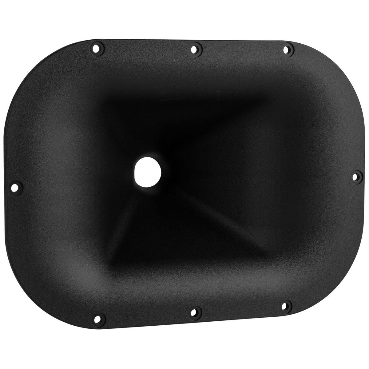

....Such casting defects are undesirable, but should have little effect relative to the grossness of the constriction (that ends in a sharp edged diffraction slot).
The SRX712 horns that Zilch shows at the bottom of the same page have a 'clean throat' and are - apart from the mounting holes - definitely preferable to the 2332 horns. Comments are made about possible ringing.

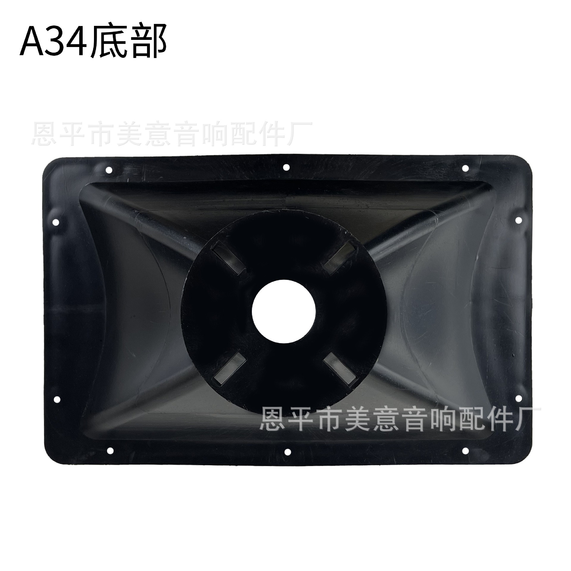

Plastic clones of the bigger SRX722 horns are offered en masse on aliexpress. Also available with 1" throat, without mounting holes.

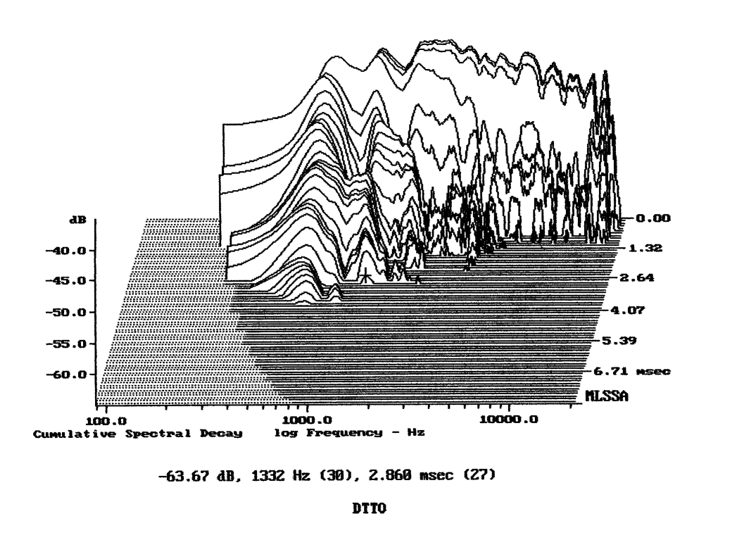

Until about 10 years ago, the DE250 was considered a benchmark 1" driver, thanks in part to Dr. Geddes and Zilch.The DE250 on the WG10 is more efficient but at the expense of some pronounced resonances around 2k and 3k, which IMO explains what some people describe as being harsh, especially with female vocals. It is somewhat smoother and veiled, lacking fine detail yet while being a little more extended up top. Even though the 18sound CD drops off faster without HF compensation, it retains more of the upper harmonics that are missing on the DE250. That may be due to the reduced amount of dampening from the Ti diaphragm vs the DE250's polymer material.
The DE250 was praised precisely for its low distortion, clean reproduction in the vocal and presence range as well as its 'good-natured' top end.
I also owned a pair of the first series (white label instead of black) that I liked, but not as much as the Beyma CP380M.
So what happened?
Here's a clue.

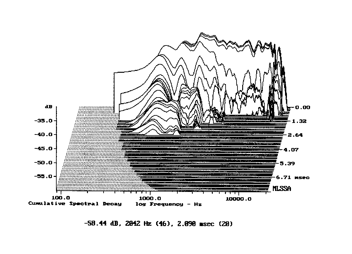

Waterfall of a DE250-8 from 2005:
Waterfall of a DE250-16 from 2014 with the same horn:

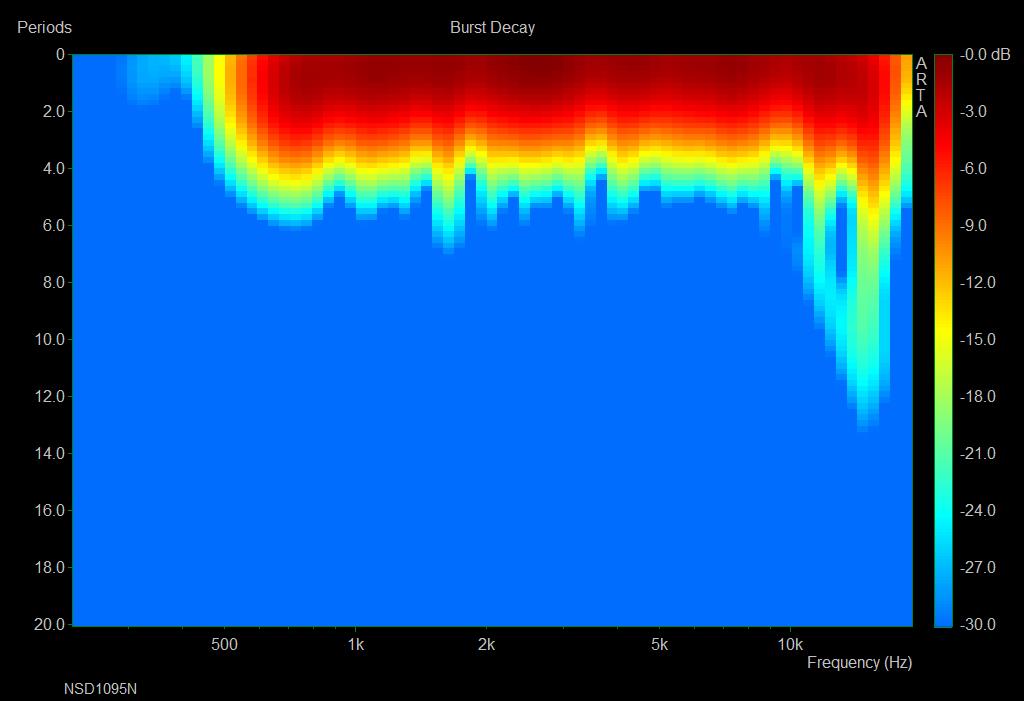

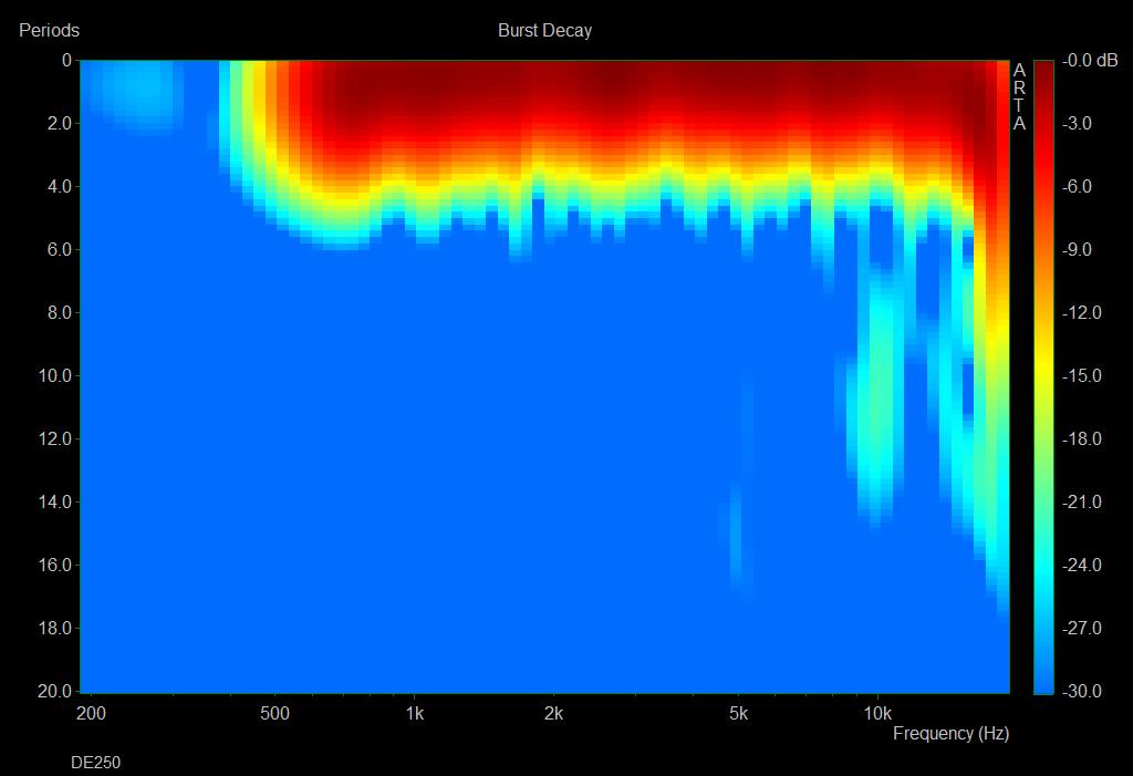

Objectively speaking, the ND1090 performs slightly better than the NSD1095 under certain conditions - the most common in home use. The soft-suspended, uncoated Ti diaphragm of the ND1090 is better damped and therefore causes less 'hash'. In addition, it delivers more output above 8 Khz.
BD of the NSD1095N:
ND1090:
And for comparison (a recent) DE250-8:
Looks like either the diaphragm changed and/or the pjase plug design. My money's on the diaphragm,specifically the material. Many dome type CD diaphragms are made with a varying thickness from tip through edge. I dont ever remember the DE250 being any different than it is now since I haven't heard it before a few years ago. It would be interesting to look at an old diaphragm vs newer production.

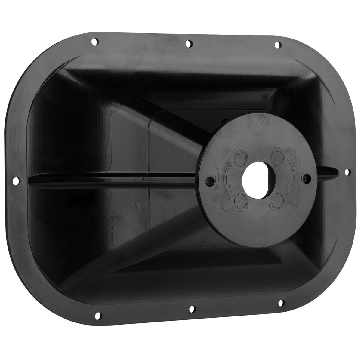

I was just checking over a new pair of Faital Pro LTH102 horns I received to go with some B&C DE-250 drivers for a 3 way project using B&C 8PE21 in a WG for MF and B&C 15NDL88 for LF.
I had some questions for those with previous experience using Faital WGs -
Looking mainly at the finish work in the casting, I'm somewhat disappointed for the amount of money spent. I specifically don't like the pronounced lip in the throat entry right after the flange. but I'm not sure how much of an impact this will have, mainly on HF performance. There's about a 1-2 mm step roughly 1/2 - 3/4 way around the throat in both WGs (see pic). Seems kind of sloppy for a high priced WG IMHO.
In previous situations like this with other WGs, I did see some measurable differences when removing minor casting abnormalities in the throat. I'd rather not mess with it here if there are no detrimental effects to overall performance. Any thoughts?

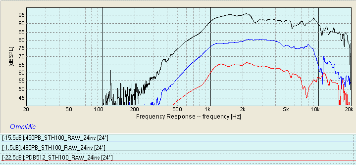

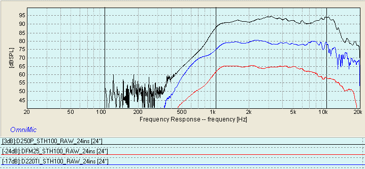

As usual, some drivers work better with a specific horn than others:The LTH100 WG is obviously shorter than the LTH102, which shows up as ripple in the pass band. Most FR plots I've seen of the LTH100 show a good amount of ripple, which is the penalty you pay for a shorter WG coupled with a wider than optimal mouth. Simply put, the expansion rate is too aggressive for the depth of the WG.
First off, I realized making a mistake, referring to the STH100 as an LTH100... looking at the description itself, I'm pretty sure LTH means "long throw horn" and STH means " short throw horn".Could you show an example of this? Trying to understand.
To my eye the problem is often mouth termination more likely than depth, or I'm not sure how the depth relates here? What is the expansion rate for direct radiating dome on flat baffle, very aggressive? is the ripple there? There is ripple but it is due to diffraction I think, or any reflections (sudden change in impedance) where only part of the sound transmits and part is reflected back which happens at poor mouth termination or at baffle edge. Ripple happens when there is some additional sound interfering with the direct sound.
That being said, I can't find the bookmarked sites anymore which had all the WG comparisons with various CDs tested together that I was referencing to. The HF on the STH100 collapses faster than some of the deeper WGs, which is its main deficit and thats really only an issue when used with larger mid drivers and lower xover points .
For nearfield applications the STH100 is a really good horn but it requires a specific CD exit angle to avoid excess response peaks and dips. Many shallow horns suffer from early HF drop-off, such as the really shallow spherical WGs used with dome tweeters. In the vertical plane the STH100 is at a disadvantage to the LTH102 which is why I chose the LTH102.
The STH100 response ripple shows up with some CDs. It was very pronounced with some of the cheaper CDs. The DE250 looks nice on the STH100 both in vertical and horizontal planes.
