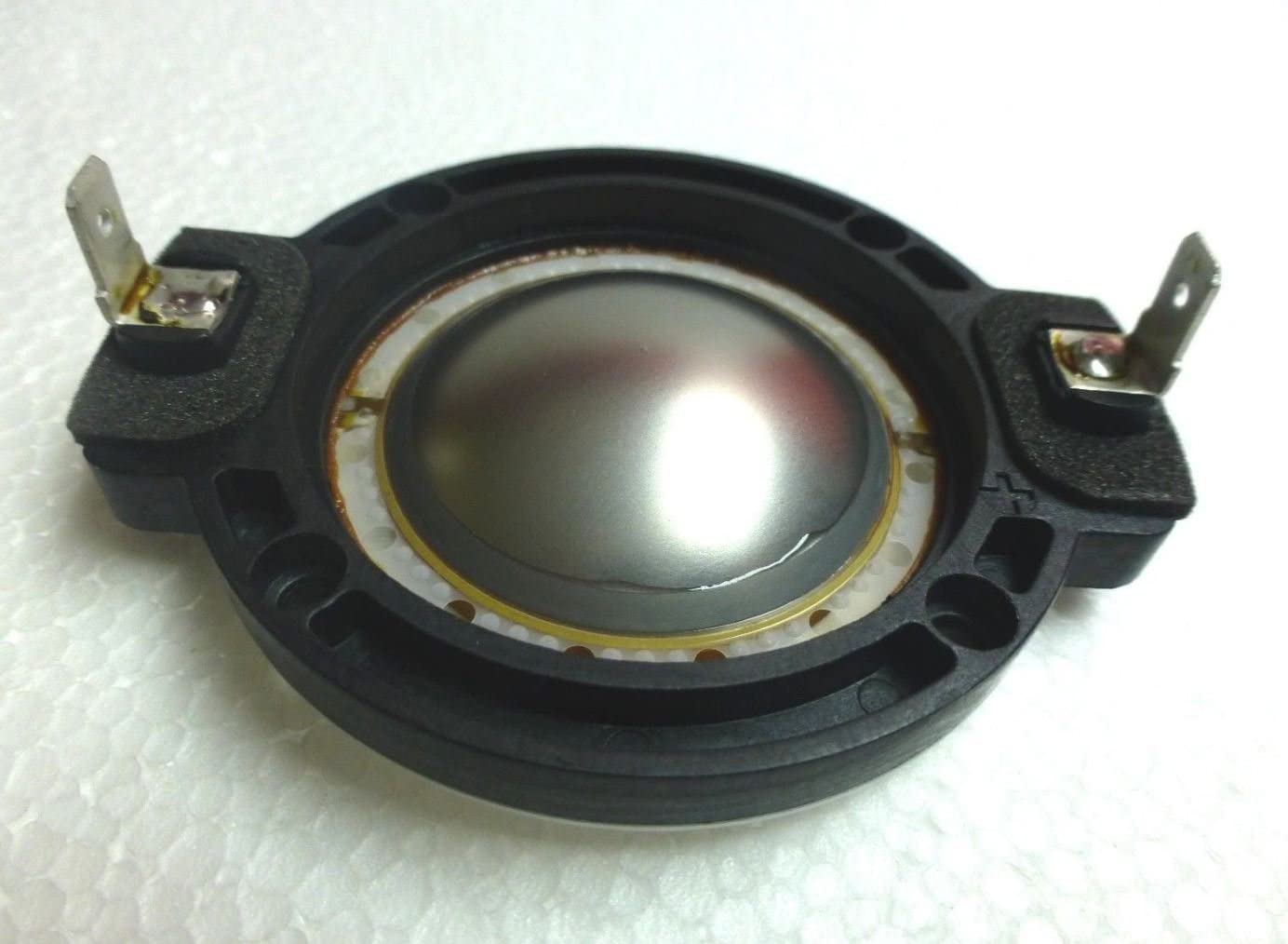

As I spent quite a lot of money in audio, I can afford to buy a mid price CD to compare...The soft ketone polymer that Faital uses for diaphragms sounds nice, but they tend to break up at a lower frequency than the best drivers with Titanium diaphragms > i.e. the B&C DE500 and the older RCF 1" Neo.
Tbh, I have my doubts about the 3P phase plug in the 18Sound 1" drivers.
Wrt (lack of) mid and treble details/refinement I (re)quote:
"The HF108R version has a thicker membrane and a more rigid clamping system. These details allow a more controlled movement, reducing the distortions and making less nervous and metallic the mid/high freq."
Due to the greater thickness of the already highly damped ketone polymer, the sound velocity of the material (roughly between 2000-2700 m/sec) may be too low for adequate reproduction of upper mids and treble.
For comparison:
Aluminium: 6320 m/sec
Beryllium: 12900 m/sec.
Titanium: 6100 m/sec.
I also intend to ask a friend to bring back a pair of heil ess from the states. Even as a decorative object, they are not very expensive.
But as said, metal diaphragm tend to sound metallic, so perhaps there is more pros with mylar.
