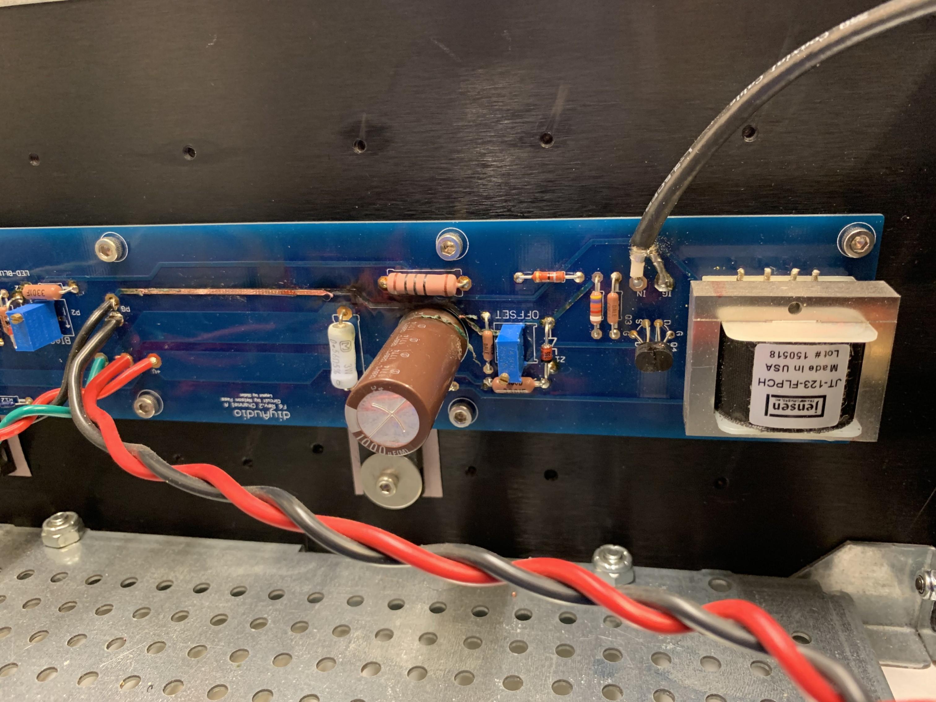

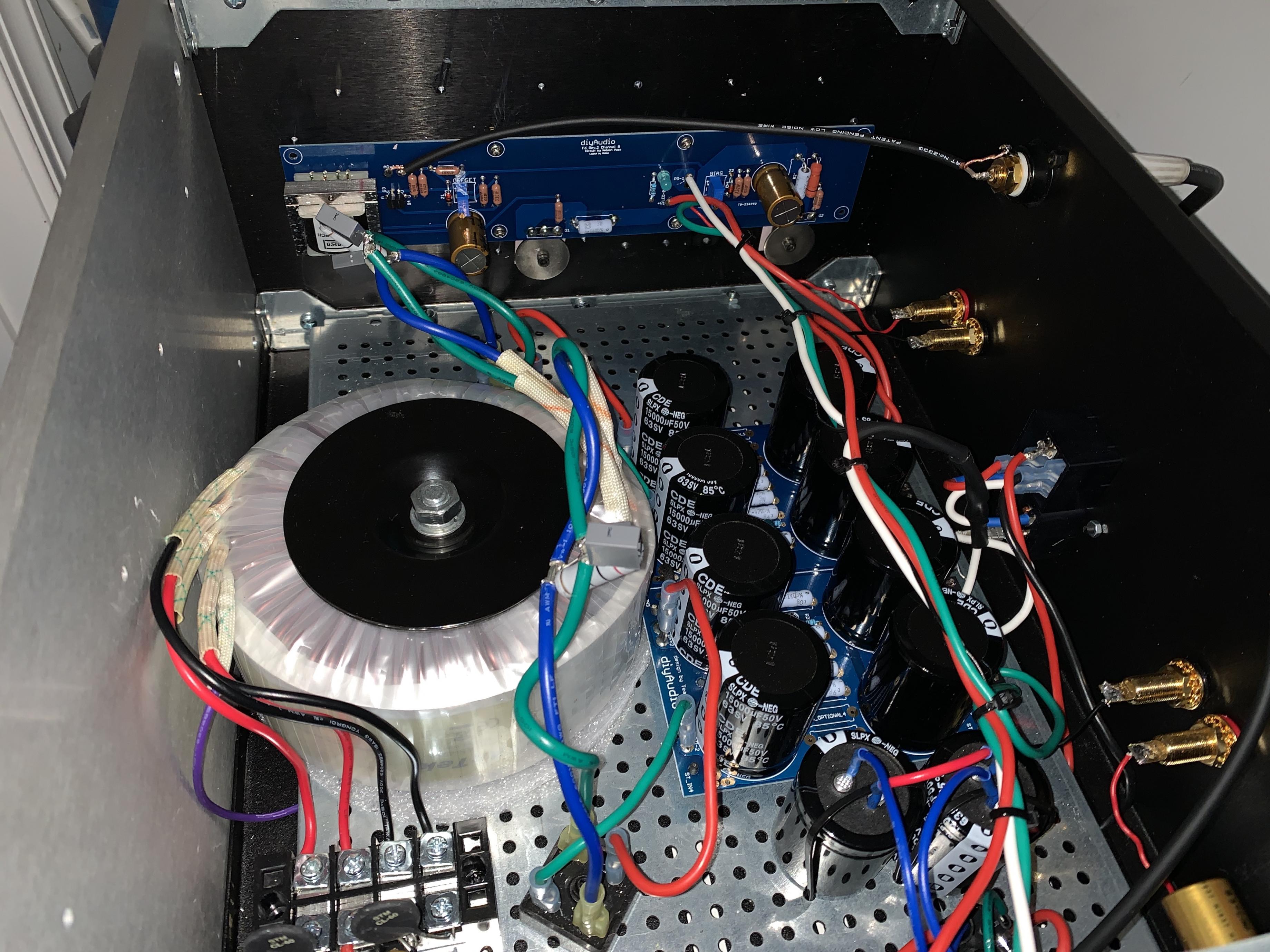

Can't really understand what happened. The mains wires are going directly to the transformer. This is the only mains connection inside the amp. The only thing I can think of is the connection of a mains wire in the plug to the earth wire, and find a way trough the cl60 to audio ground, and then via the rca connection to the preamp. And the preamp earthed via another mains plug?
Taking photos would probably help us help you, otherwise rebuild the amp.
It's most likely a cold soldered joint if it has worked for all this time and only failed now.
I'll be glad to take any photos requested.
The suggestions that there was a short at the receptacle are consistent with what I experienced (flash/arc at the plug). I have since replaced this receptacle and will be going through my house doing the same for the rest of those that have a loose fit.

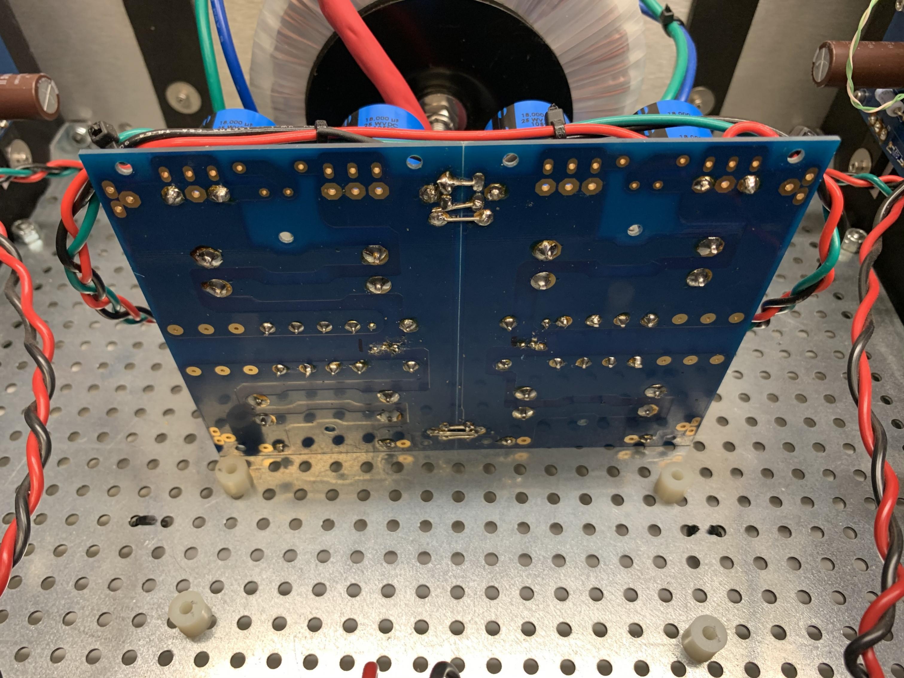

Earlier, you mentioned the PSU, so I've taken a photo of the bottom (and the nylon offsets I used).

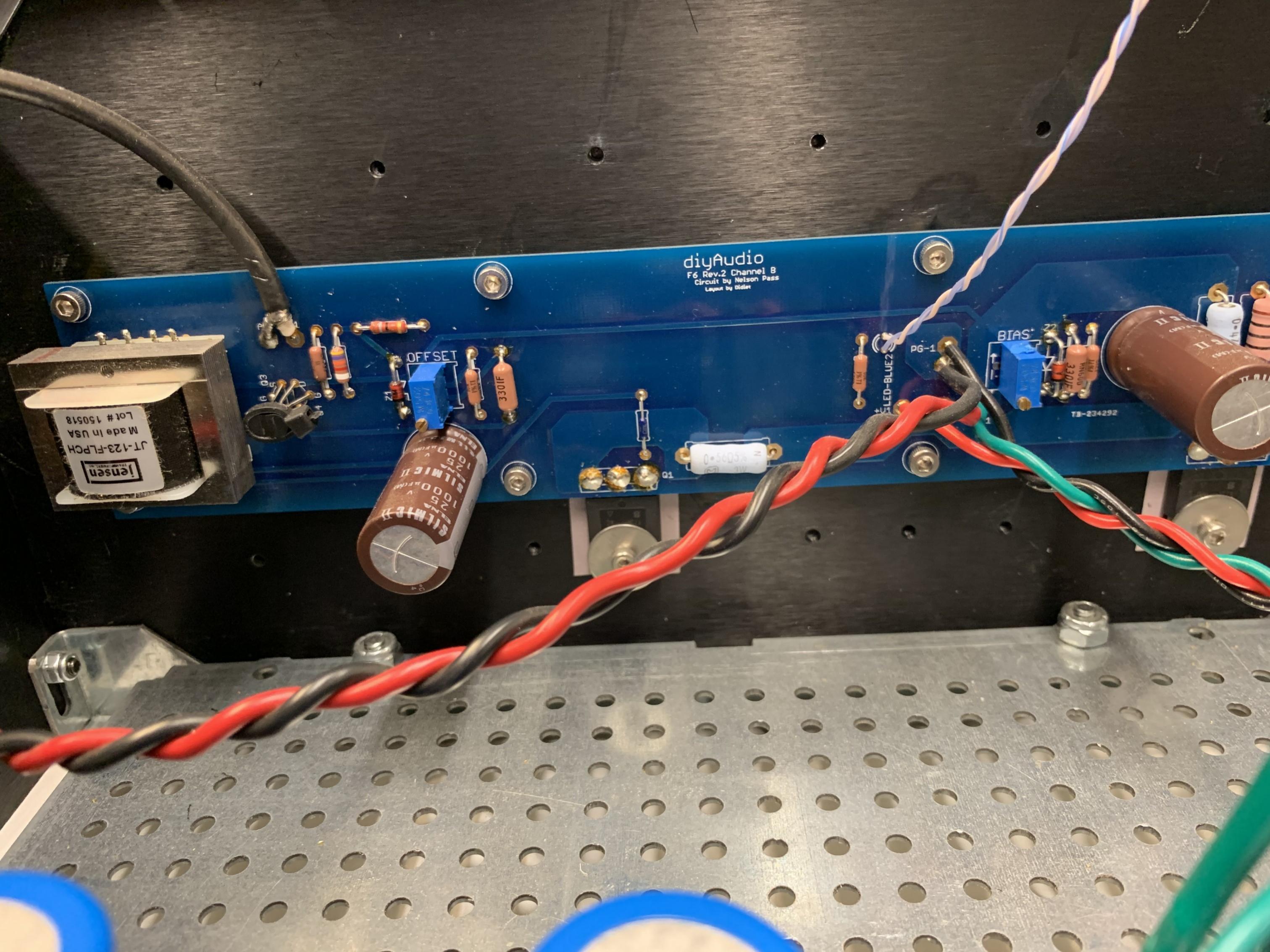

Also, here's a photo of the left side and the right side. On the left the lifted trace is obvious. The two jfets lost their zip tie and are now melted together. The right is not showing obvious signs of damage.
I've already started ordering parts. If the PSU and the transformers are OK, there's not really too much to buy. Should I just disconnect the board and test the PSU? (with ground to earth replaced)

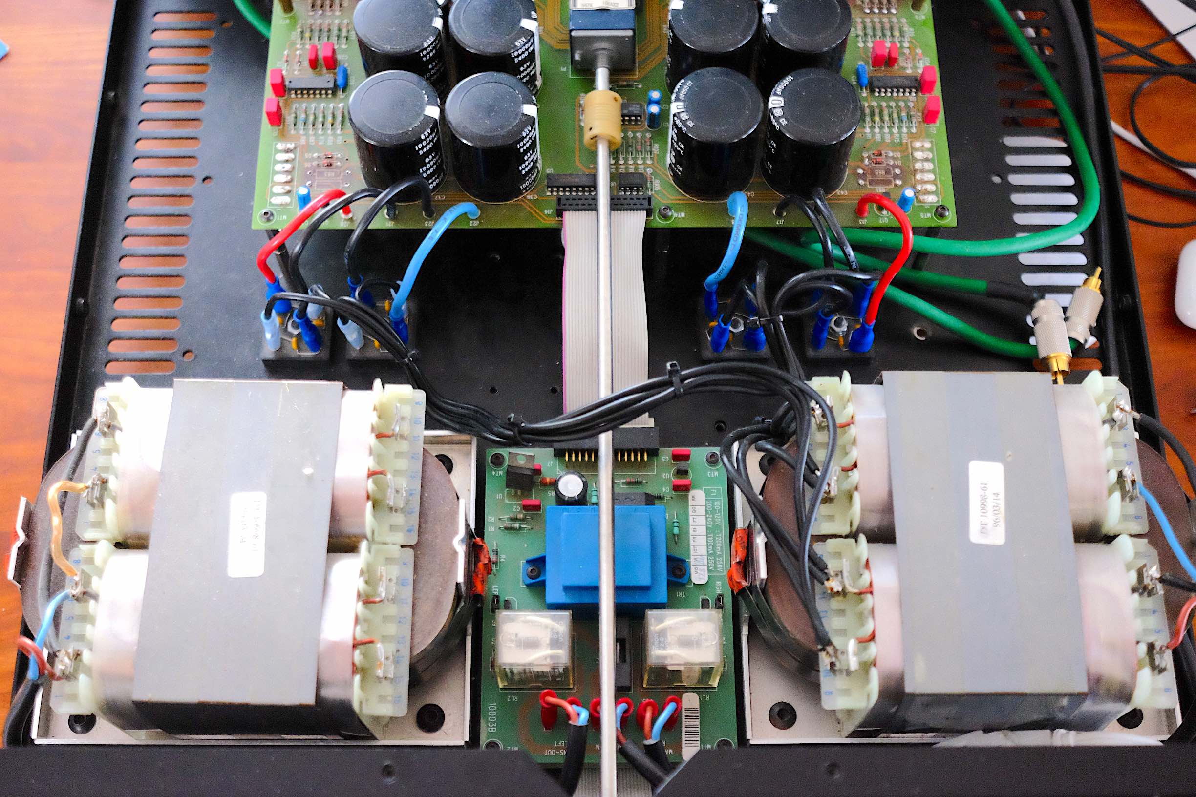

I was planning to re-use my existing massive power supply from an old Gryphon Tabu integrated (see picture). There are 2 monster C-core transformers, and I will throw out all the pre-amp parts to get sufficient space to make it a nice F6 build.
The original Gryphon schematic says 2x50V rails (dual mono), and my idea was to put the Tx primaries in series to halve the VAC, should make about 25V DC, perfect for my F6 build? That was the idea, anyway.
Well, it turns out that the secondary is more like 22VAC and the resulting rails are at ~30V.
