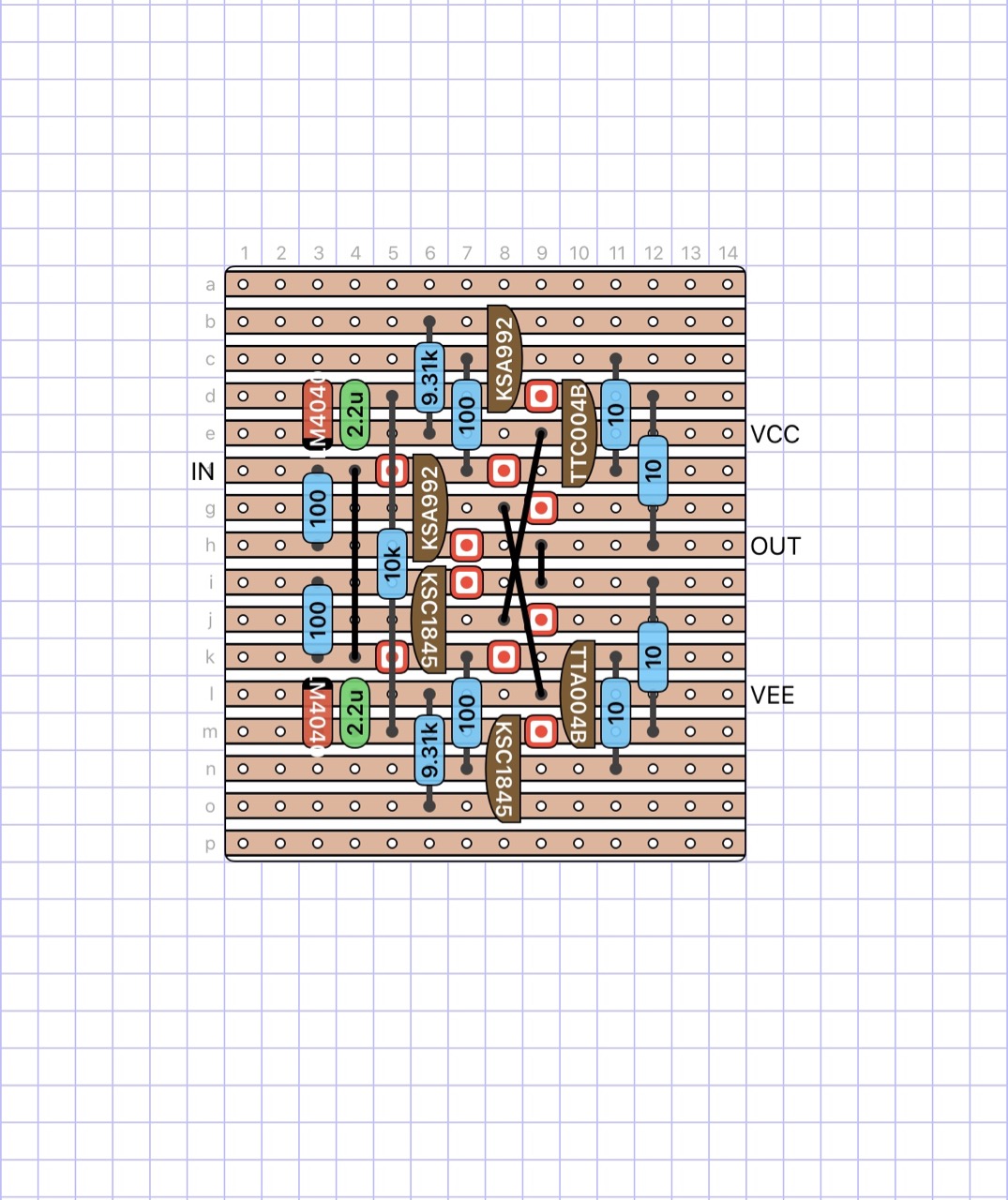

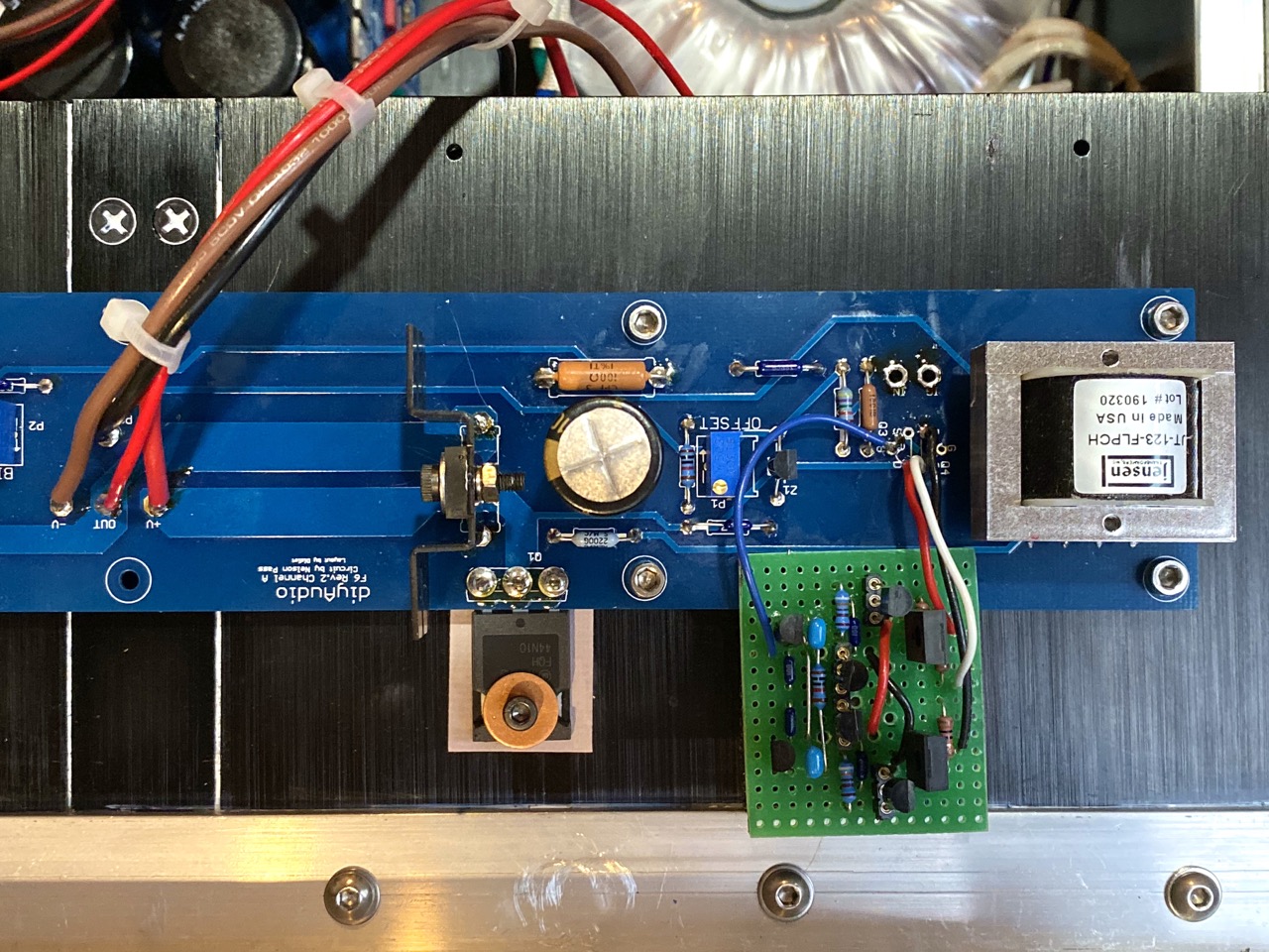

My F6 power rails were +/– 26V, but the standard F6 input stage doesn't have any source degeneration on the JFets. I used a variation of the Austin input stage that is included with the M2x. The Austin IPS is a version of what is commonly known as a diamond buffer. It can be readily adapted to drive the F6 in place of those two lonely JFets. I built it on a veroboard like so:
This is great! Out of curiosity, is that veroboard illustration a rendering option in Kicad, eagle, etc, or something you created one-off? I’ve just started dabbling in Kicad and don’t know much about anything yet 😀
That veroboard drawing was done in an iPad app called StripboardCAD. It follows the same conventions used on the Guitar FX Layouts website. It's also possible, though somewhat tedious, to do a strip board layout using graph paper and colored pencils. That's how I did many of my first custom bass guitar pedals.
These days I can read a layout the same as one would read the code of the Matrix 😉
TungstenAudio, what is the advantage of using the diamond buffer in place of those two jfets?
The way this version of the diamond buffer is constructed allows it to operate at higher rail voltages without stressing the components. The input transistors are fed from CCS which use 10V references. This keeps the bipolar transistors running in a safe region for voltage and current. If I understand correctly, this was Mark Johnson's contribution for the 'Austin' input stage. I kept this the same, and tweaked the output stage to use more robust Toshiba bipolar output transistors. These are the TTC004B and TTA004B, which use the TO-126 package. I also added 10 Ohm Base stoppers and reduced the Emitter degeneration to 10 Ohms for those output transistors.
During initial evaluations of my M2x with different input buffers, the Austin emerged as my overall favorite after trying several other types, including the Ishikawa which is essentially the same as the input buffer of the standard F6 (and M2). I noticed a similar sonic signature to my F6 as I was making adjustments to its bias settings, and have been very pleased with the way it sounds.

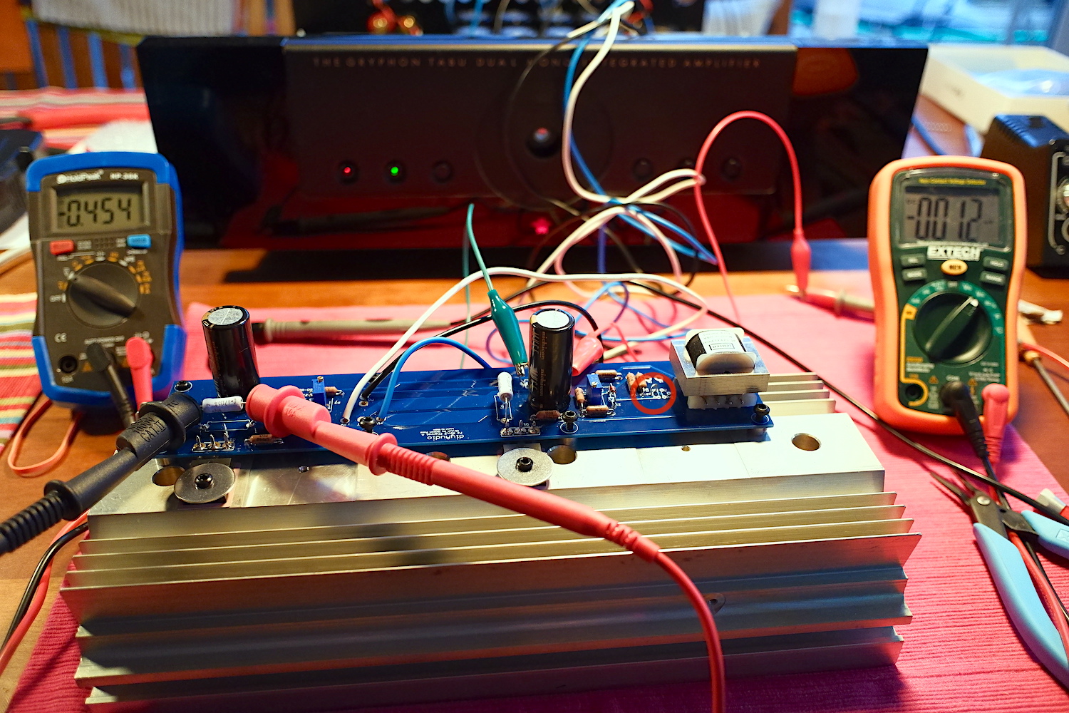

Random observation: not a good idea to just leave out the JFETs while doing the Bias adjustments: R3 suddenly started to get very hot, which really confused me because the voltage across it never got above a few 10s of mVDC.
Thinking about it a bit, with the Tx primary open, I suppose there was a high frequency feedback pumping a few watts into poor R3...
I put a bridge across gate and source of Q3 -- that fixed it.

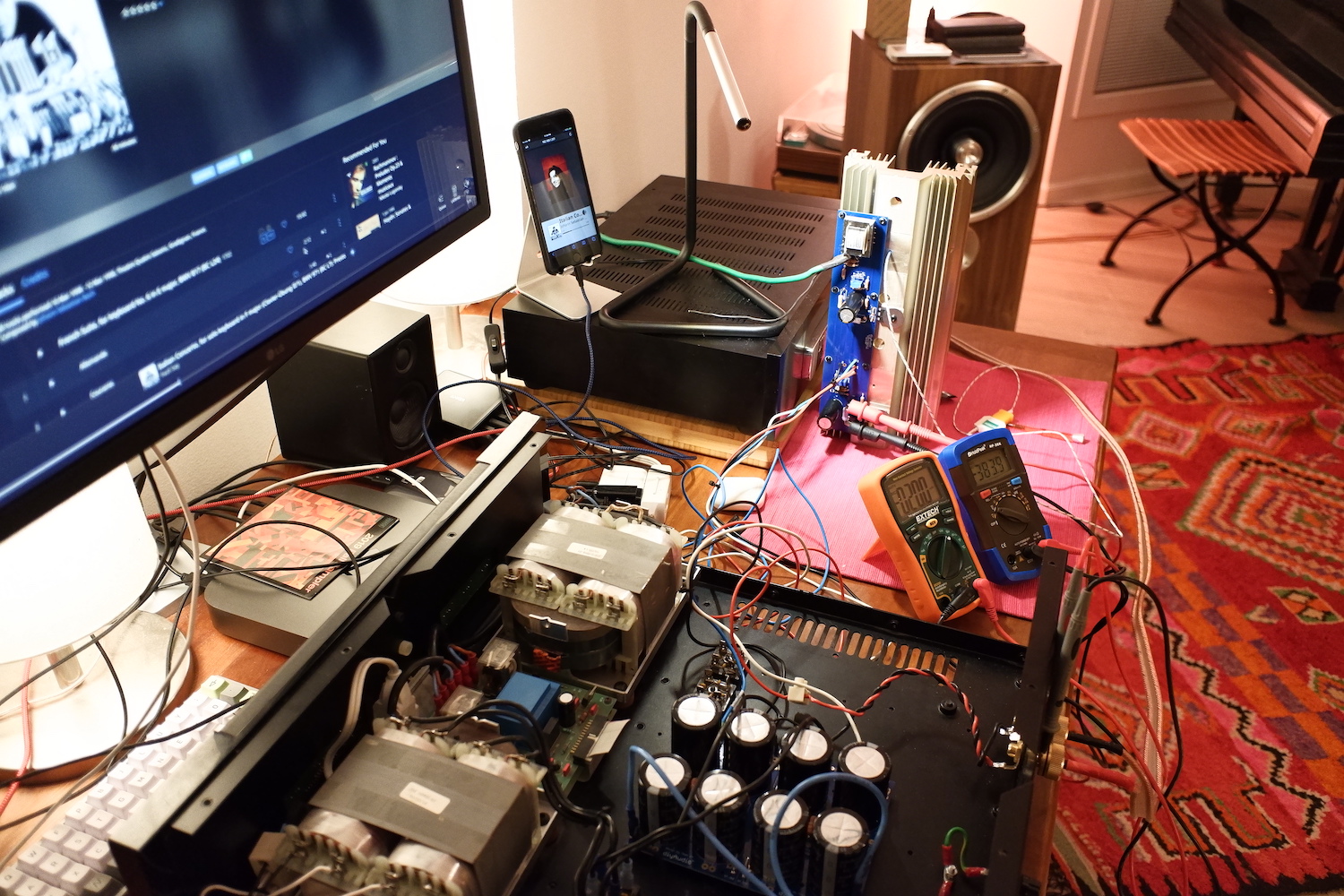

Next: connect in and output and listen to some music (mono only, for the moment...).
BTW: turns out my rails are at ~26V, so I'll probably going to be fine with the JFETs after all. At a bias of ~1A the heatsink stays at a toasty 50C.
I noticed that bias and offsets are wandering around quite a bit when everything warms up. More disconcertingly, when I switch on the output shows voltage swings around up to a couple of Volts. Hope my speakers don't choke on that when I connect them...
