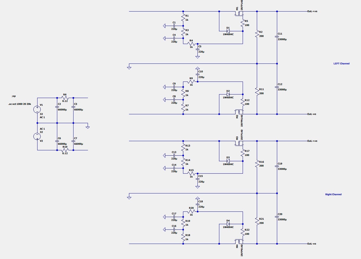

For stereo do like this.
One cap multiplier per channel fed from CCRCC supply.
If you wanted you could replace 1k-220uF-1k-220uF-1k-220uF with:
A single but larger cap like this, 1k-2200uF

What do the Mosfets need for heat sinking in this circuit?

Sorry, I meant for the capacitance multiplier circuit in post 1668.

P=VI
To keep the calculation simple and be on the conservative side in terms of heat dissipation let's just say the Vdrop is 5V.
Current, (I) will be the bias of one channel.
At 1.3A Bias P = 5 x 1.3 = 6.5 Watts on each mosfet.
It will be less than this but it's always good to over engineer a little bit with regards to heatsinking.
