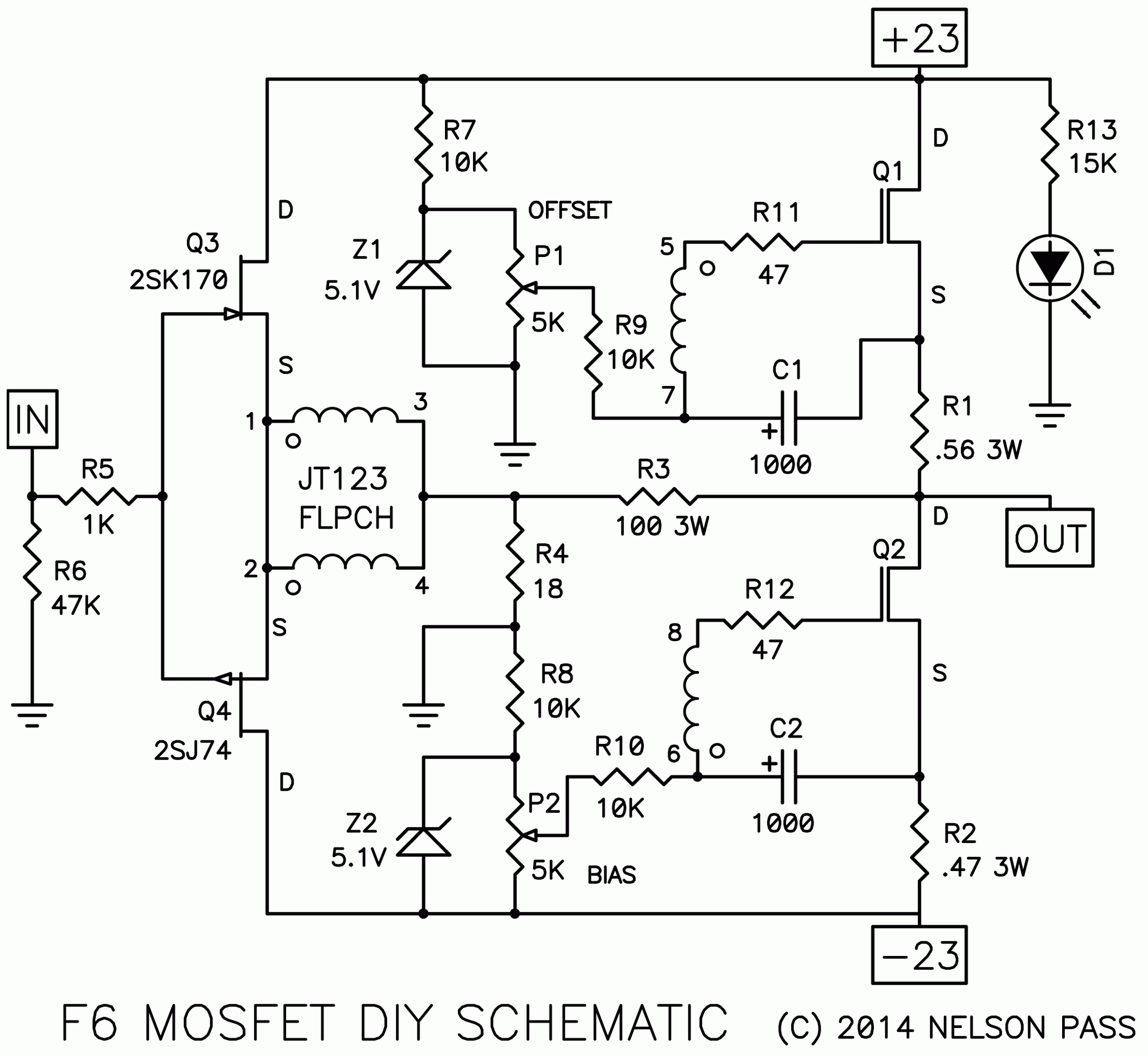

please , indulge me and point to exact schematic (you're using) ,and then I can reply something sensible

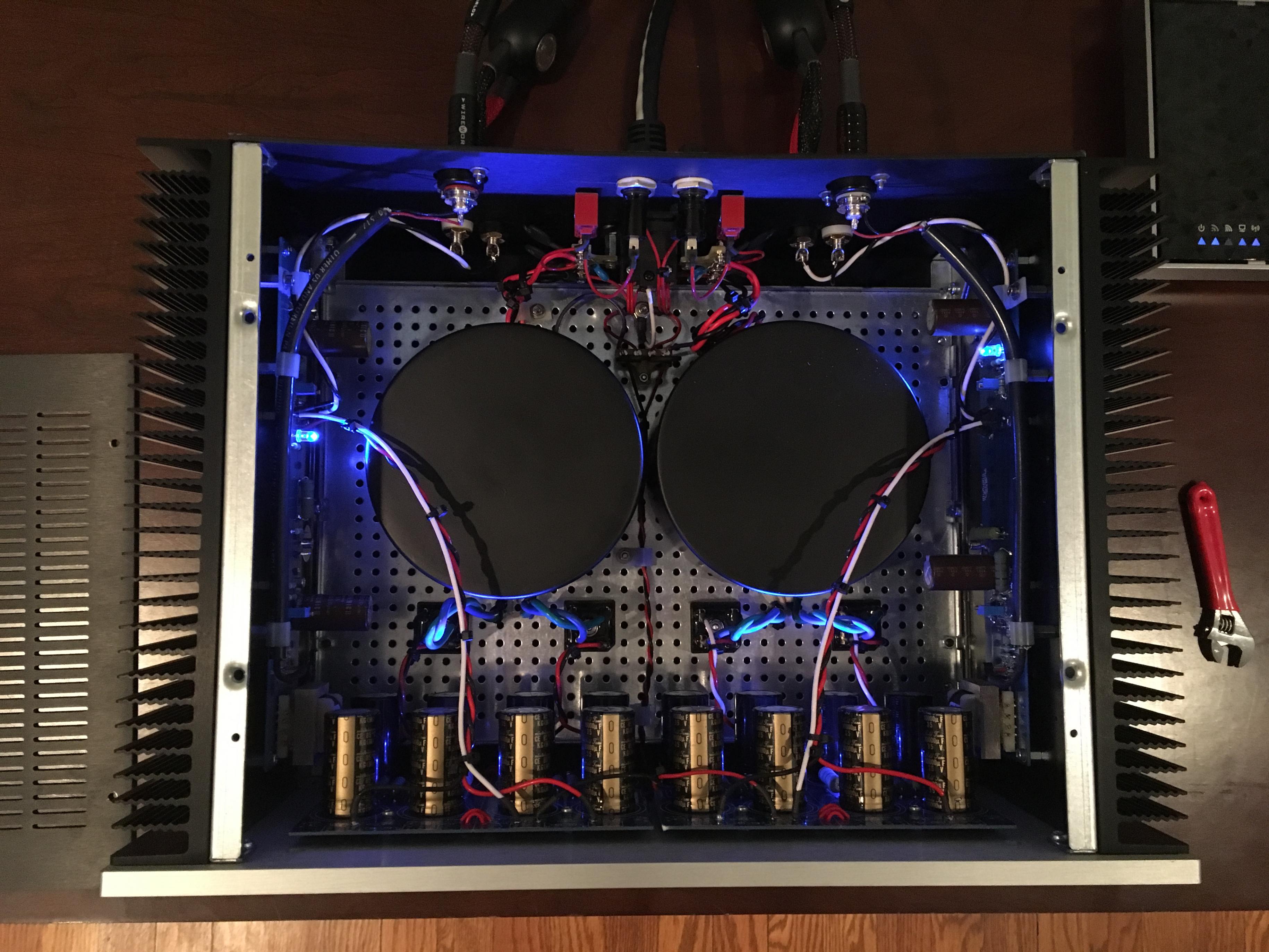

Hello Zen Mod. The schematic is below (from page 1 of this thread). I changed out the 10K resistors based on your post on page 3. But I wasn't paying attention to the value of Z1 and Z2.
5V6 or 6V8 zeners will do the job
or put 2 series 1N4148 in series with existing zeners , cathodes opposite to zener cathodes
( so , pair of additional 1N4148 on each zener)
that will rise voltage on hand by some 1Vsomething
Installed 6V8 zeners today. Bias is sitting steady at 600mV with offset zeroed out.
Still have some clean-up to do on the wiring as it is not quite as clean looking as I was hoping, but the amp is dead quiet as is.
I'd say well done! Excellent effort, enjoy the music!

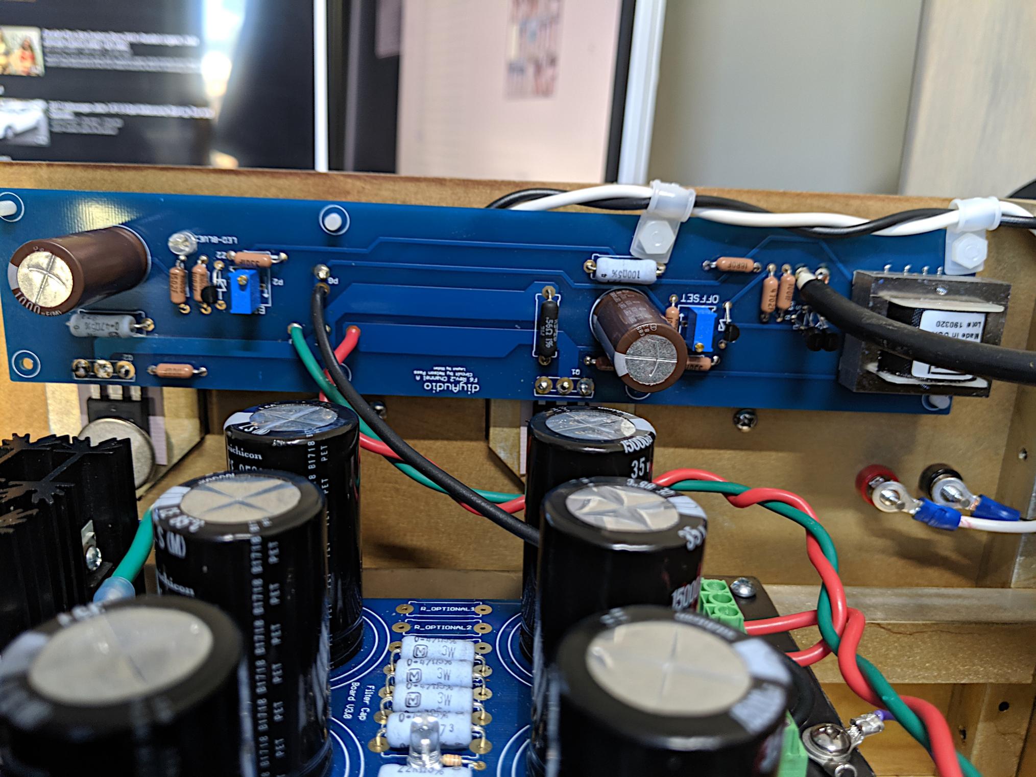

Did a bit of clean-up and added transformer housings. Because I am using the 4U chassis I had to remove the rectifier boards and replace them with rectifier bridges. I honestly can't hear the difference with the rectifier bridges versus the boards. However, even though the transformers are shielded the steel housings made an improvement. So I am pretty content/happy with the power supply at this point and don't plan on tweaking it anymore (famous last words). I made some F4 and M2 boards this week so I am looking forward to swapping the amp boards and comparing the sound of the 3 designs.
Finished my F6 yesterday. It is a very standard build that won't impress anyone except my wife and friends. But I am quite happy with how it turned out. I have built a Bottlehead S.E.X. and WHAMMY headphone amp recently but this was the biggest DIY project I've done. So I had a big sigh of relief when the power supply and then each channel fired up on first try with no issues. Many thanks to 6L6 for the detailed build instructions that were priceless, along with all the questions and explanations in this and other First Watt threads. And of course huge thank you to Nelson for being so generous with his designs and intellectual property. I was somewhat concerned about whether it would drive my medium efficiency speakers but I shouldn't have been. With my Pass Labs XP-10 preamp in a somewhat small listening room it has way more power than necessary and drives my Harbeth speakers wonderfully. Still have some clean-up to do on the wiring as it is not quite as clean looking as I was hoping, but the amp is dead quiet as is. And my wife is quite happy to have her kitchen island back.

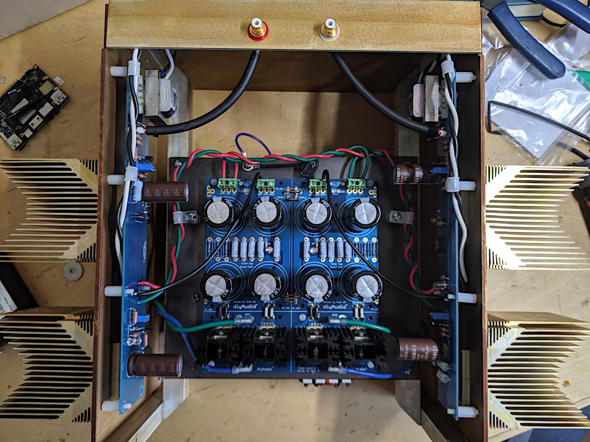

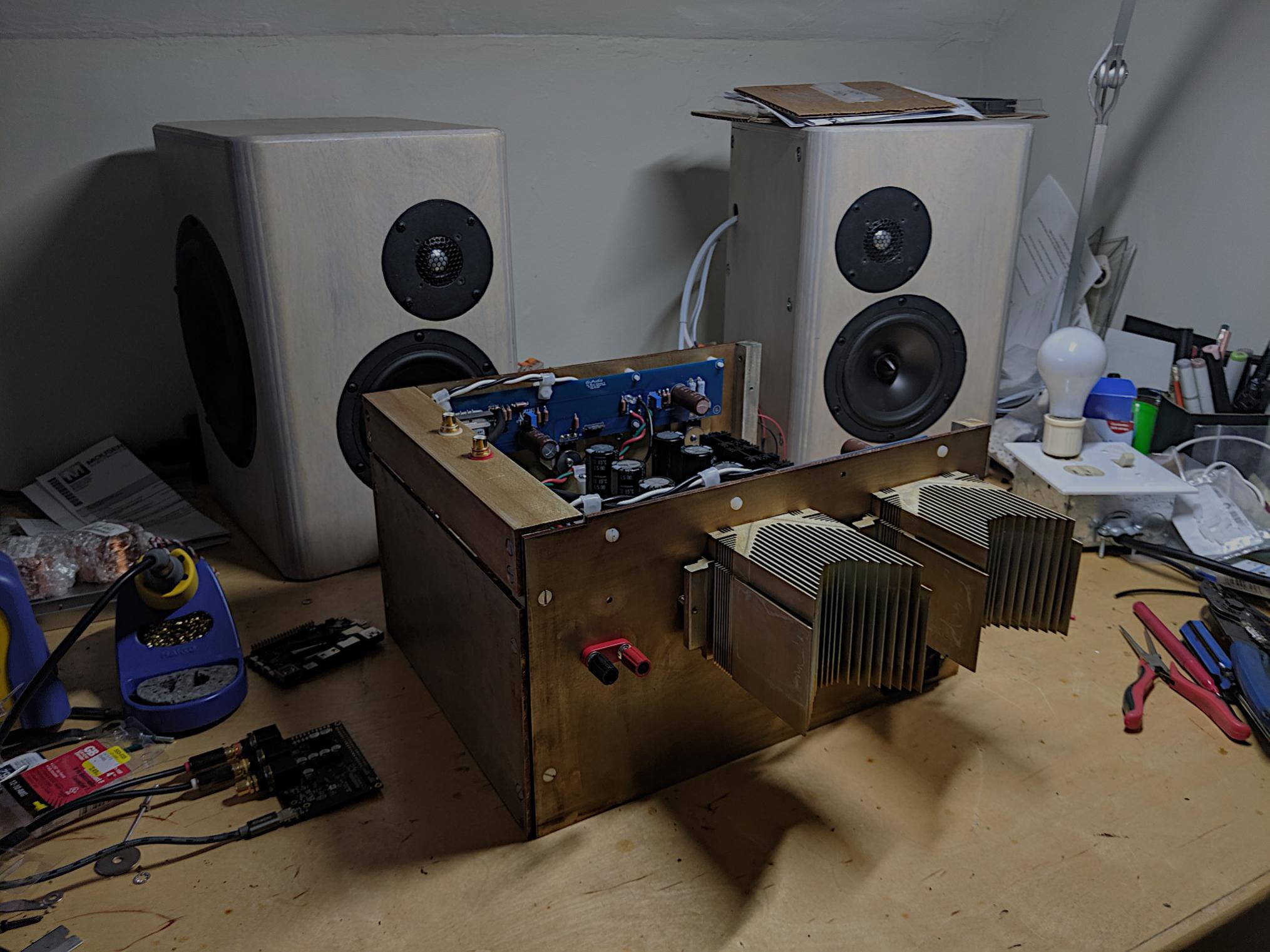

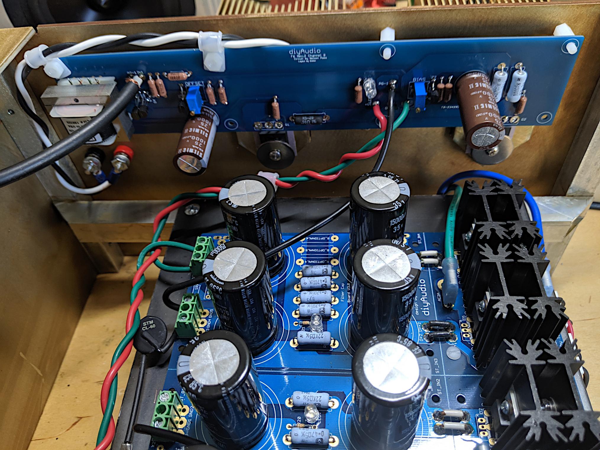

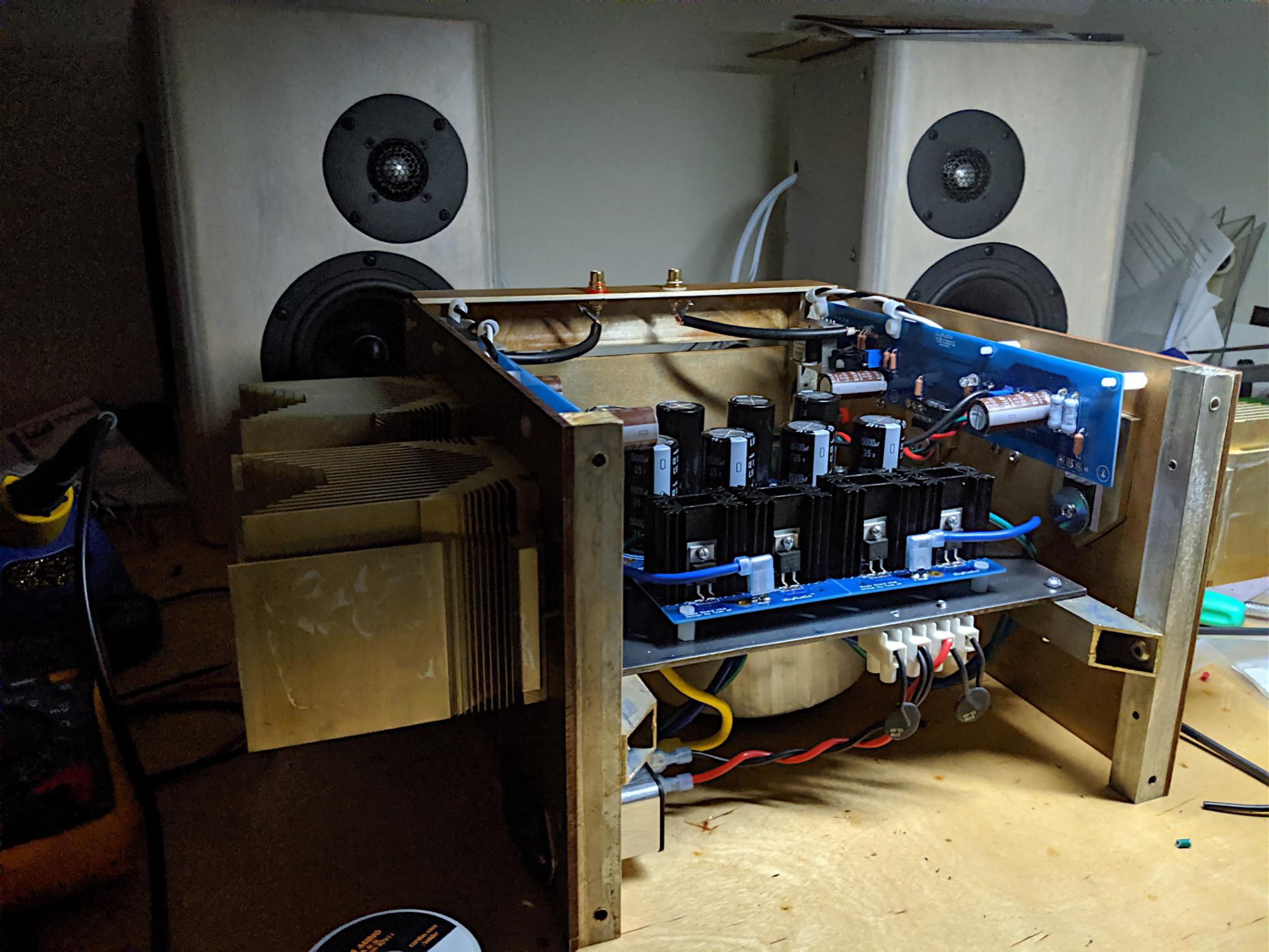

Another first time F6
Hi Folks. I've been stopping by here occasionally for a decade, thinking, I ought to try building an amp sometime, finally gave it a go.
My case design is a little idiosyncratic - the back is blank, so it can go up against a wall, or on a shelf. The front will get a nice piece of wood, plain, and the top will be 3/8 glass, with ground edges, set up an 1/8" above the sides. The edges of the glass lighting up from the led's inside will serve as my power light.
I have a plan to add forced air if needed. I put the power inlet/switch up towards the front, to reach it easier, and the outputs on the back sides.
I used 6.9v zener (LM329)-3.3k R7,8; Jfets from punkydawgs, and VS-HFA25TB60-M3 Hexfred's for the rectifiers. Transformer is an Antek 3218 (300Va, dual 18v)
Please look the attached over and let me know if I have made any rookie mistakes, etc before I start it up. ( I built a bulb tester, and plan to unhook each amp side, test the psu, then one side at a time. I have the zeners turned down. The amp guides were great, but pics of the diyaudio psu rectifier boards wired up are a little shy (I found one) - so let me know if I have it right. Thank you to NP and all here.
