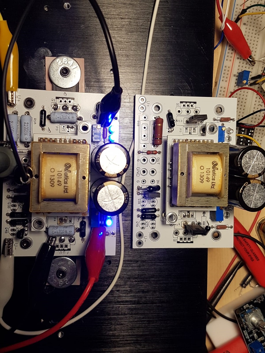

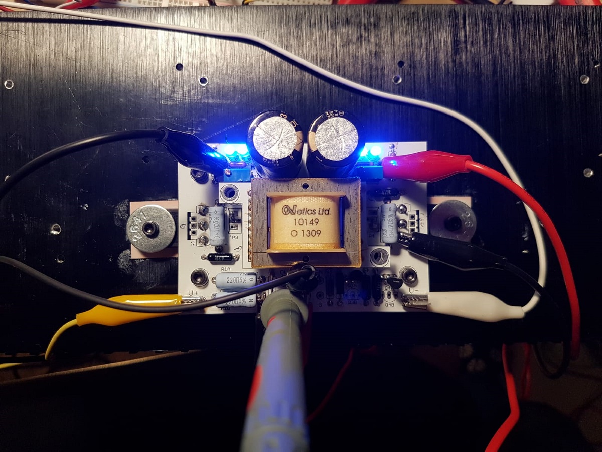

I recently picked up a set of Teabag convertible F6 boards from a fellow member and figured I should try breathing some life into them. Originally they were built to be used with Semisouth SiCs but I am planning to use those in F2J so this was going to be IRF.
I put in 2 blue LEDS for ~6V and replaced the current limiting 10K resistor for 3K3 (if that's the right description for them) like a good Greedy Boy should. I put in the source degeneration 0.47R as well and jumped the 'extra' pot on the board. Without output devices the blue leds all light up and that's when I remembered I had Cree SiC that I bought last year and decided to use those instead of the IRF.
So bias pot and offset pots work very nicely and I measure from pots to ground and -V on each side and get both to read 1.2V steady. The problem is that the fets don't heat up and when I measure V across source resistors, there's nothing going through them. Do I need to bias these differently or change other part values to get the Cree SiCs to work here? Should I just use IRF instead and move on?
Voltage is +/- 24V and offset is about 4mV. I use bias pot to adjust one side and then offset pot to bring up the other side and adjust as needed.

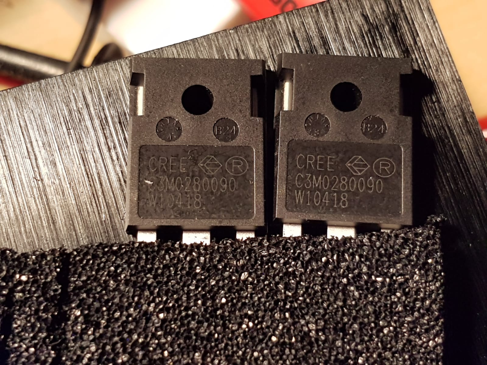

The Cree SiC I am using is the C3M0280090:
