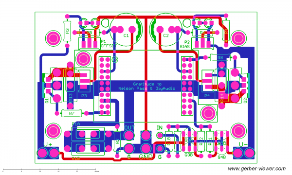

This layout has provision for P3 and P4 for variable 2nd harmonic. Do I have to short all 3 pot pins to bypass it? I currently have it only connected so that it doesn't bypass source degeneration resistors. If I connect all 3, it will bypass those.
Find a pic that shows bypass of P3/P4 here:
Post #18 of F6 GB thread

Thank you 1543 for the jumpered P3/P4 link - verified my jumpers are done correctly.

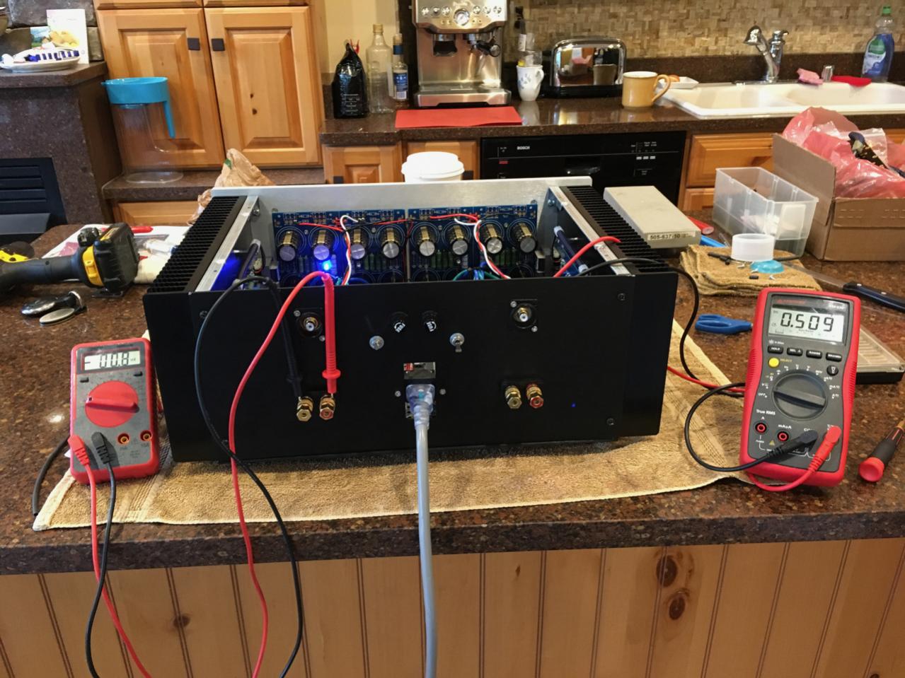

Update: So instead of looking at screen with brain turned off just trying to see if I had bad connection or misplaced component, I thought about what I was trying to measure. Papa's original schematic says to measure 1.2V across gate and source ... isn't this VGS? So I checked Semisouth datasheet and indeed, VGS (threshold) is between 0.75V and 1.25V. IRF VGS is more like 4+V so instead of trying to find what's wrong with the board, maybe it's what I was measuring that was wrong.
Reconnected meters to read across source resistors and just started turning pots ... until ... LIFE!!! It's alive!!!

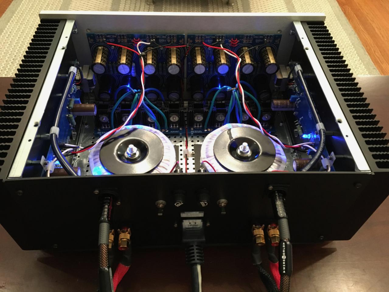

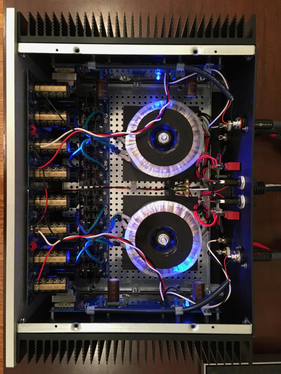

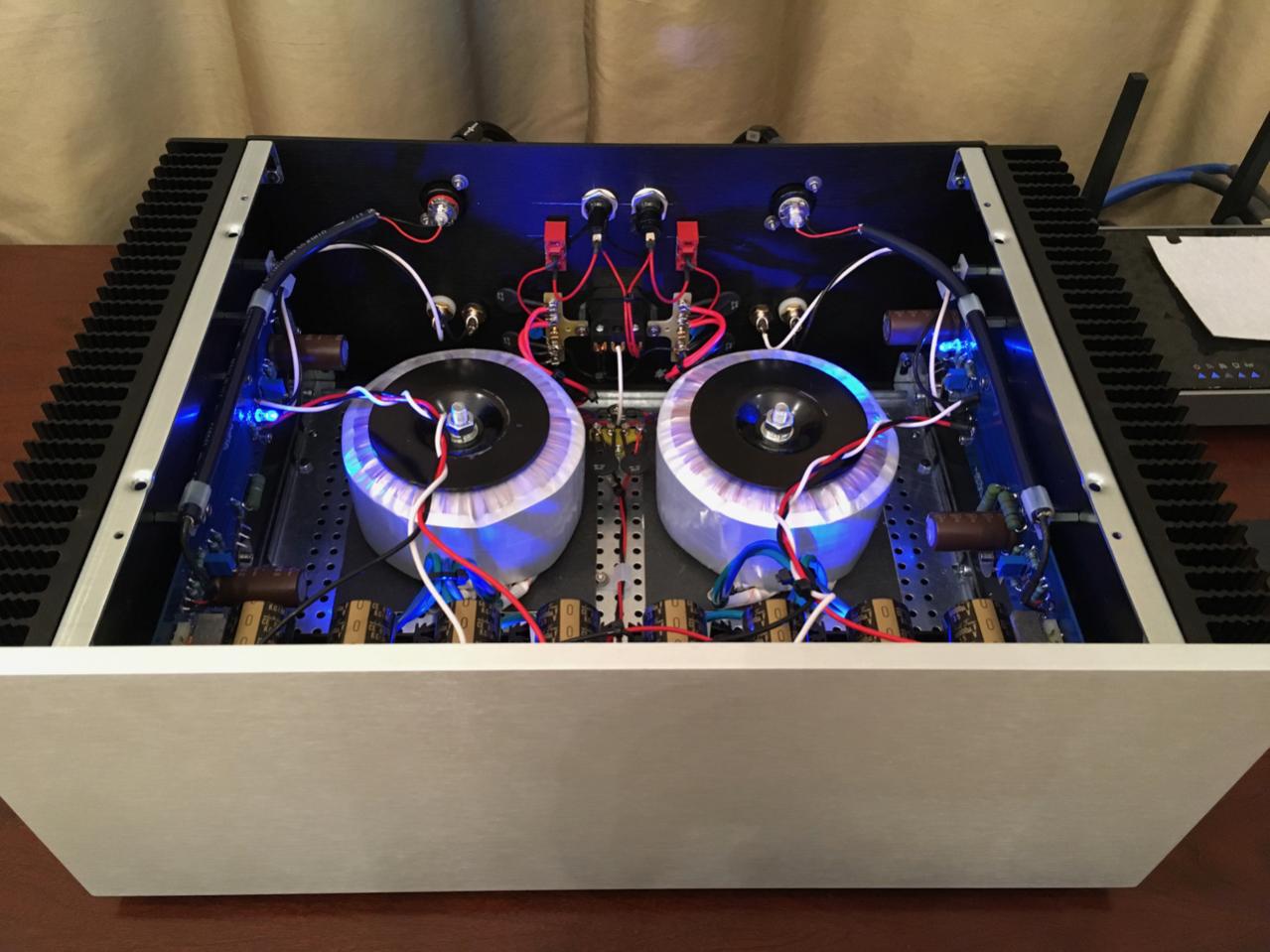

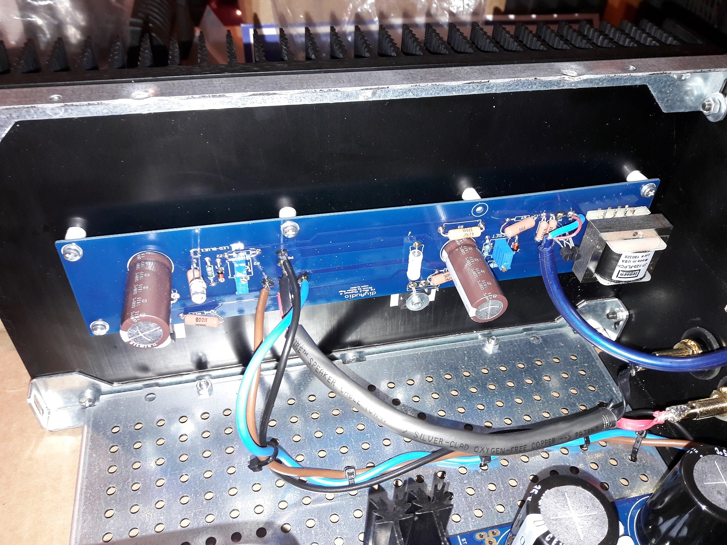

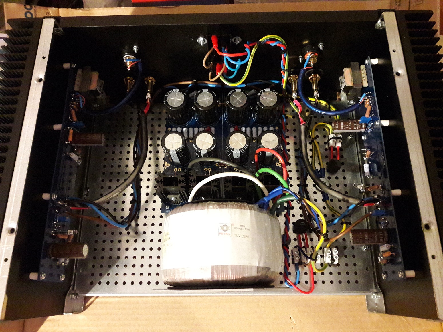

Finished my F6 yesterday. It is a very standard build that won't impress anyone except my wife and friends. But I am quite happy with how it turned out. I have built a Bottlehead S.E.X. and WHAMMY headphone amp recently but this was the biggest DIY project I've done. So I had a big sigh of relief when the power supply and then each channel fired up on first try with no issues. Many thanks to 6L6 for the detailed build instructions that were priceless, along with all the questions and explanations in this and other First Watt threads. And of course huge thank you to Nelson for being so generous with his designs and intellectual property. I was somewhat concerned about whether it would drive my medium efficiency speakers but I shouldn't have been. With my Pass Labs XP-10 preamp in a somewhat small listening room it has way more power than necessary and drives my Harbeth speakers wonderfully. Still have some clean-up to do on the wiring as it is not quite as clean looking as I was hoping, but the amp is dead quiet as is. And my wife is quite happy to have her kitchen island back.
I would say it looks mighty fine as is and that a lot care went into its construction.
Congratulations and enjoy!
