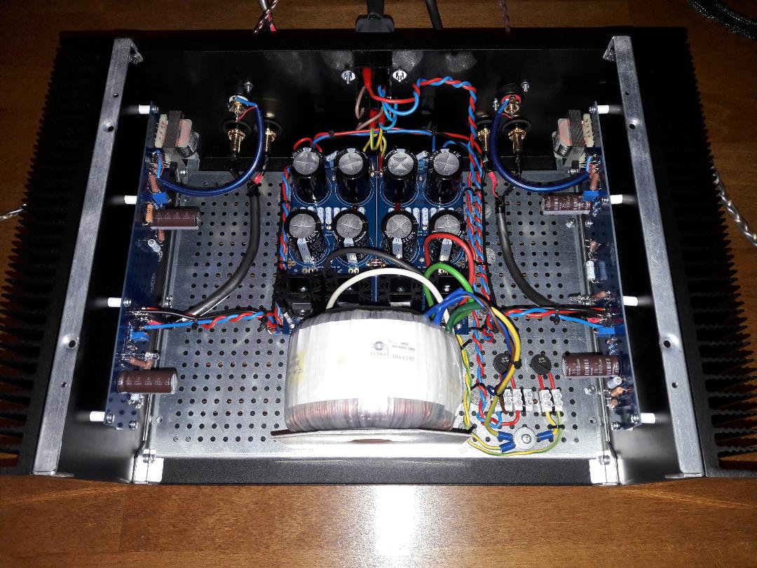

I just finished my amp today ,solving the issues I had after a wrong bias ...and I have to say that I`m very happy and surprised about the sound.It is indeed amazing.I like it a lot! Many thanks to Diyaudio for that and especially to Mr. Nelson Pass.
Though ,there is one single thing I would like to improve , if possible.I have the feeling the bass is a bit shy .Is it possible to add more weight to the bass somehow?
The bias was set to 0.51 V ( the mosfet second pin 62-63 degr C).
I have used 5.8 zenners and 3.3K resistors.
give it some time , then judge the sound
pull up those mains NTCs , away from base plate
tell us more about rest of your setup , so we can comment where exactly to look for more bassssssssssssssssssssss
thanks for reply.
NTCs mean the red and blue power supply cables ? Sorry but I`m not familiar with this things.This is my first electronic thing ever build ! )

F6 . if made correctly , can't be responsible for any bass deficiency in system
there is always possibility that 25W is not enough to make your ears happy , when combined with your speakers , but then it is not F6 as culprit , it is mismatch between speakers and amplification
for me - 180mm dia cones with 88db/1W/m sensitivity , married with 25W amp ...... isn't match made in heaven , if I'm expecting music bliss
if happy cruise is what's expected , then OK ( for several years I was happy with 15W amp and LS3/5 clones ) ....... I like and enjoy more efficient and more sensitive speakers , which mostly means they need to be bigger .....

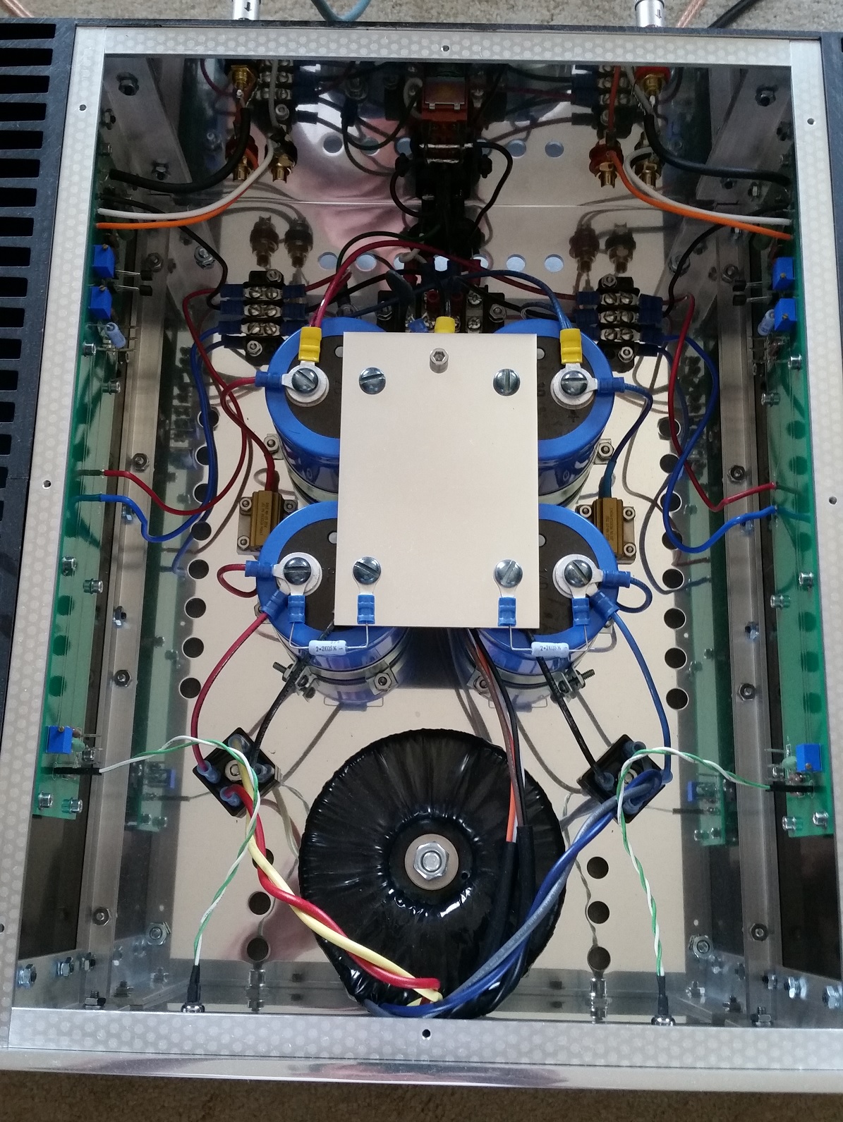

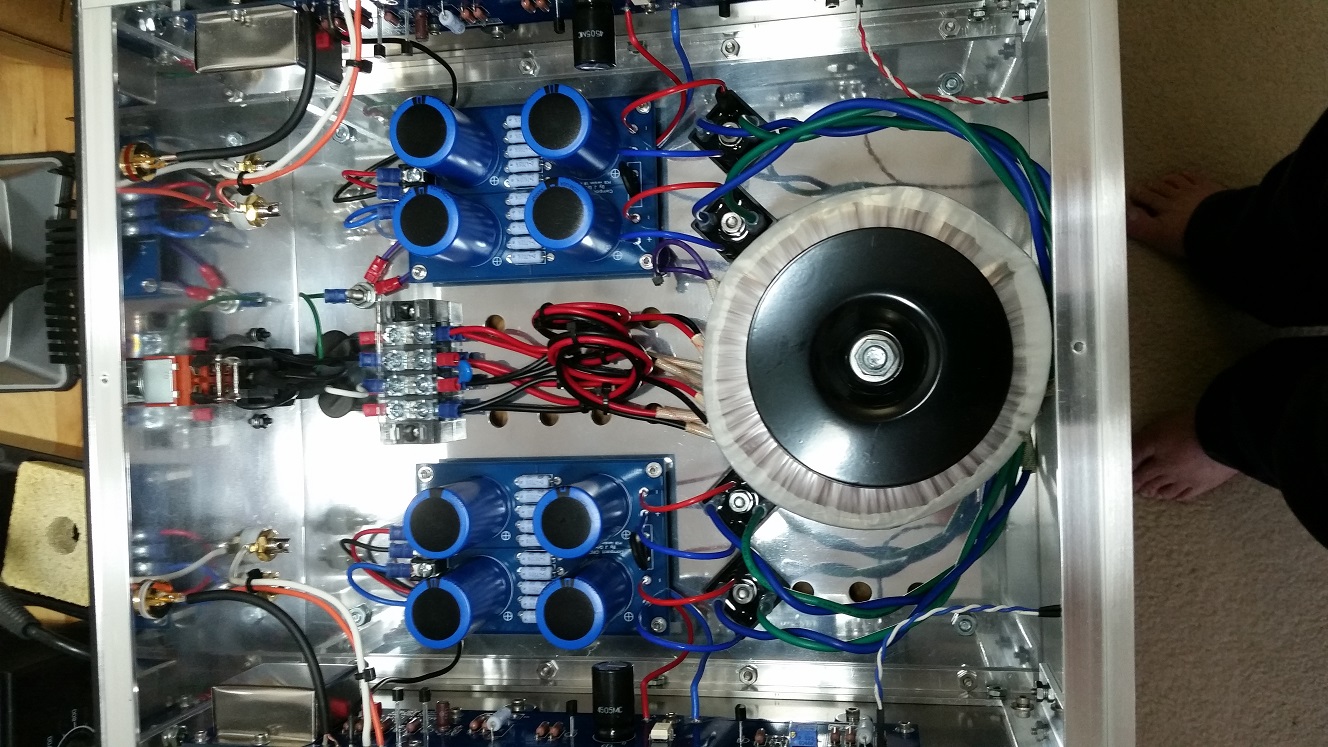

One of the reasons I use terminal blocks is that, for me, no build is ever final. I always go back in to improve one thing or another.
The number of holes in the bottom plate is adequate for both my M2 and F6 builds, which have identical cases. That was not the case for the first version of my KSA-50 clone cases, which I built as passively cooled monoblocks. I had to take them apart and add additional holes to the bottom plate. Sheva (unofficial F7) got enough holes first time around.

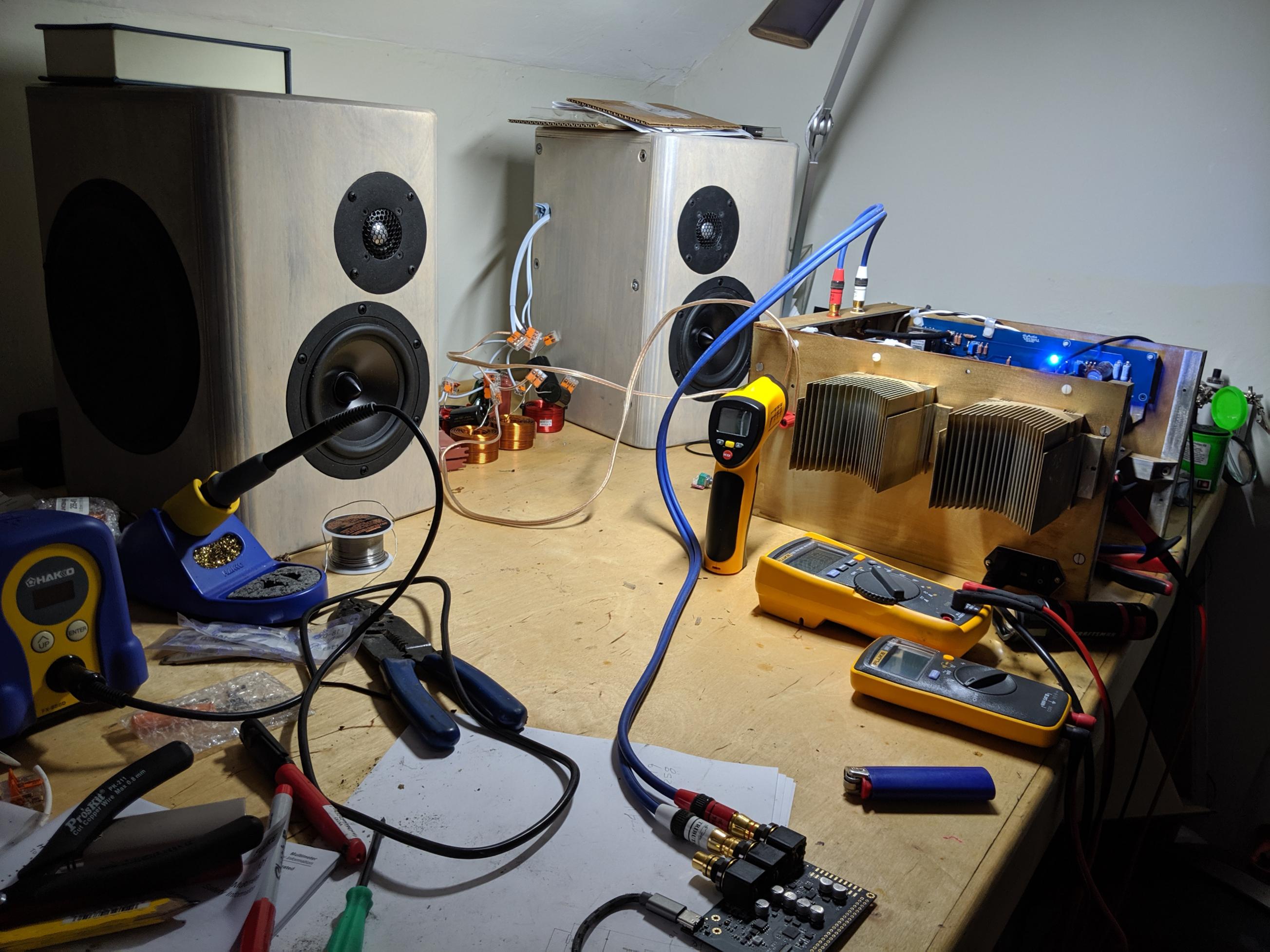

After fixing a backwards led, have been edging the bias up between listening sessions. [PC-Khadas Tone Board, no preamp]
At the moment I have .460v across R2, offset less than .005v, and heatsink centers at 40-41C. Amp has been on for several hours, it got up to 45C when I turned the AC off (83 ambient).
Not sure I have something to check pin2 of the jfet. I think I can get to .5v without fans, but will see. [if I go that way, was thinking of 40mm or so fans on the ends of the heatsinks blowing in, with a pair of 67F050P Sensata / AIRPAX Bimetal Disc Thermostats to turn them on at 50C]. Dead silent between tracks.
I've thrown a variety of music at it, and it just sounds terrific - solid fast bass, musical in all ranges. Will take it downstairs and try it on the bigger speakers [Jon Marsh's Modula MTM tower version] once I get it enclosed.
I saw John Mayall live a few nights ago, so I cued up his 2019 Album "Nobody Told Me" and apart from the better production values of the album, they sounded very close. At 85, John has a little experience in getting the house rockin -
Please excuse the crossovers on my small speaker project, need to take some measurements to see how close I got to the xsim, and get a couple bigger caps to replace my cobbled together versions before I wire them up right and stick them inside. They sound darn good to my ear, with solid low bass, and typical Seas metal dome upper end. (the bass partly due to the PR, part to where they are sitting on a large desk in an attic room.
I think some form of a preamp might be next. Thank you to NP, the very helpful guide creators, and all here.
