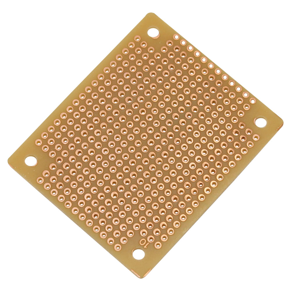

I just missed out on the PC board purchase. I can wait for the next batch. Or just wire it up on a terminal strip, building it like an old-fashioned tube amplifier, with a perf board used for the smaller components.
http://www.tubeampdoctor.com/images/products/HR9207.jpg
http://www.circuitspecialists.com/content/111731/64-8932-0.jpg

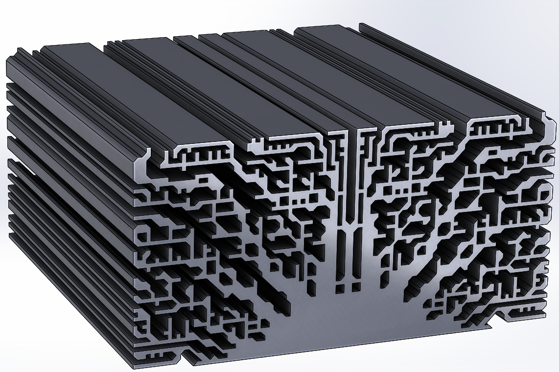

One suggestion I have regarding using a PC board or not using it: I prefer having shorter wires throughout the amp. To do that, I want to put each output transistor on its own heat sink. That lets me put all the components within a 2"x2"x2" cube, except for the power supply filter caps, even if wired on a terminal strip instead of a PC board. The filter caps can go underneath this cube.
I will build it in a mono block configuration, so there will only be two large heat sinks per chassis.
I wish mega heat sinks like the following are commercially available:
https://blogs.mentor.com/robinborno...mi-therm-31-dolly-the-heatsink-and-much-more/
