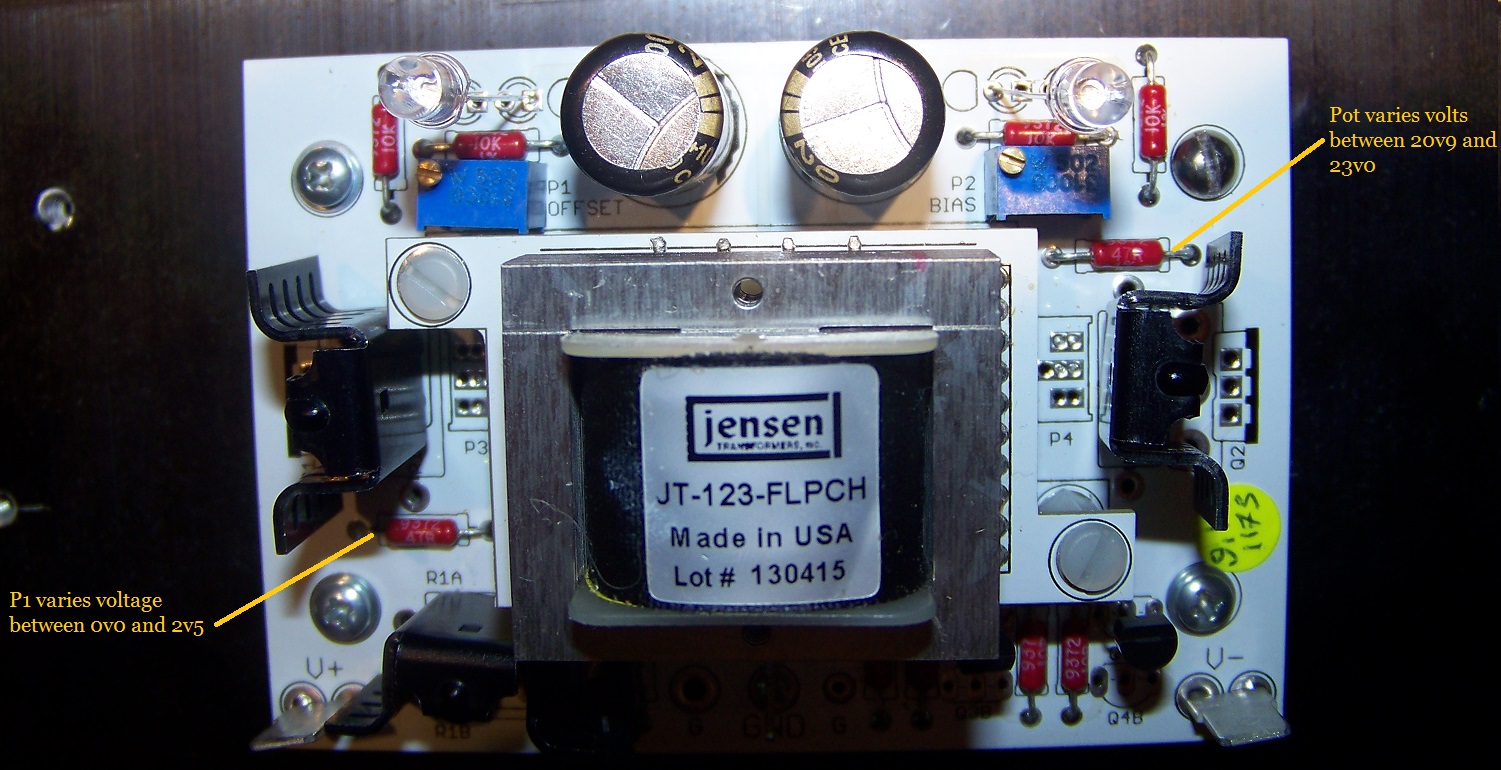

I built up the white converter pcbs of teabags with all resistors, caps, pots, input jfets, one blue led & the transformer, output SSJFets not installed.
So, I powered up and leds light up, PS volts +-23V.
Check the voltage between ground and R7, and pot P1 varies volts from 0v0 and 2v5.
Check the voltage between ground and R8, and pot P2 varies volts from 20v9 and 23v0 ???
Any ideas?

it seems you forgot "minus" somewhere
and you also forgot to put reference to schematic , hopefully one with SS outputs .......
read, please .
when we are talking of your amp , it is necessary that one with thinking cap is you , not someone else
lower bias is properly measured between neg PSU rail and pot wiper (if you needlessly measure it ref. to gnd , voltage is neg (minus) just because black DVM probe is black with reason)
upper bias voltage is measured between gnd and pot wiper

OK, that works better. 😉 Thanks.

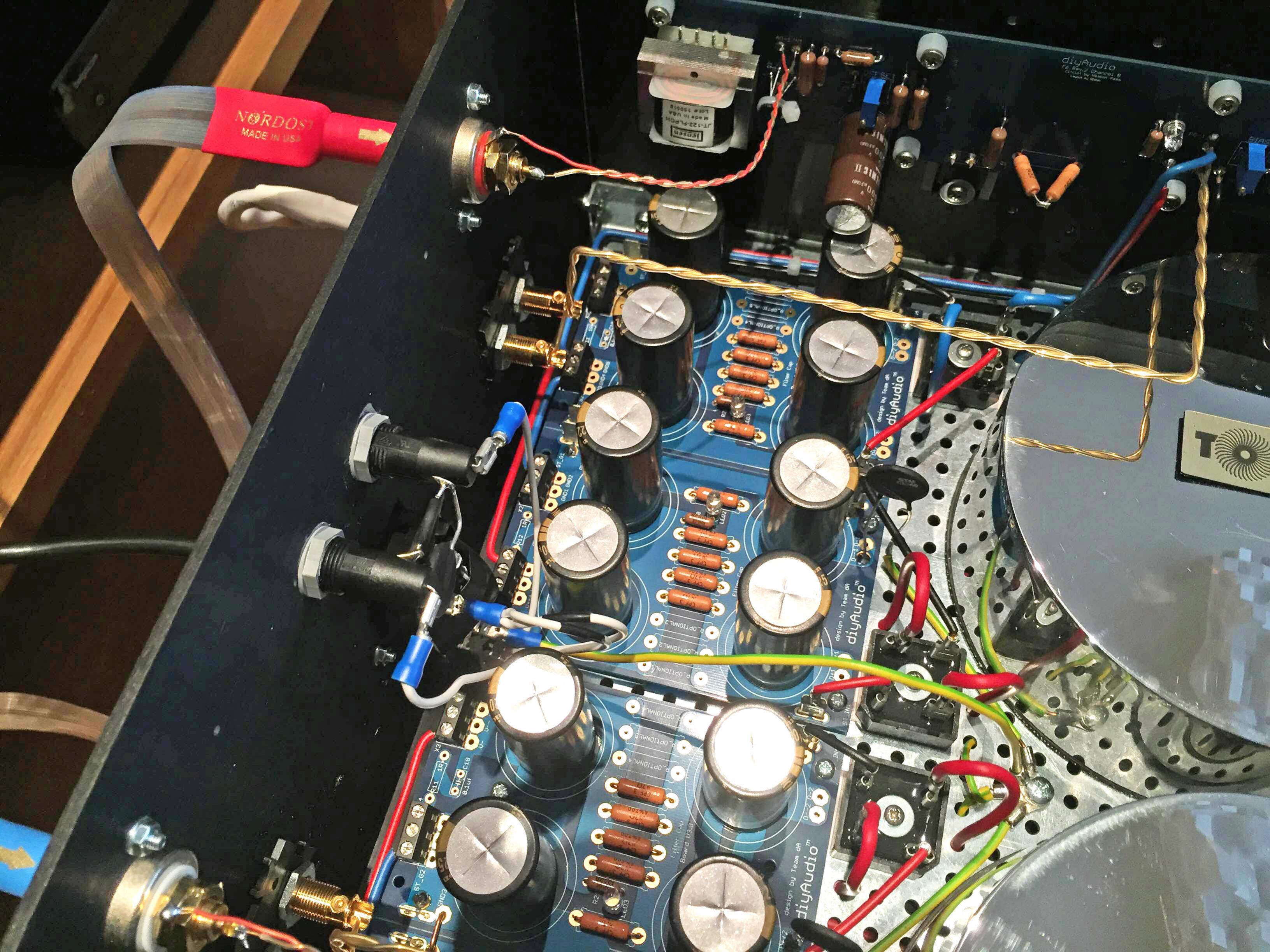

Day 3 with the new F6. Last night I noticed a low level hum/noise coming from the right speaker, only really noticeable when putting my ear up against the tweeter and woofer - wasn't bothersome. Last night I left the amp on overnight for the first time to get things to break in a bit. This morning I am getting significant noise on that same right channel. It is even noticeable while playing music. The left channel is dead quiet.
I powered down the amp for 30min, and when powering back up it is still there.
What are some potential causes of this and things I can check with the DMM to try to isolate the problem?
I have attached an image of the grounding scheme as this might help. What is odd is that the left channel is dead quiet and L and R are wired the same. The middle GND of both PSU boards are connected in 4 separate locations.

It's possible you might be experience this issue, your speakers are quite sensitive.
Get rid of the 9.1V Zener.
Any chance you have connected different source equipment to the amp?
same source, I have only 1
