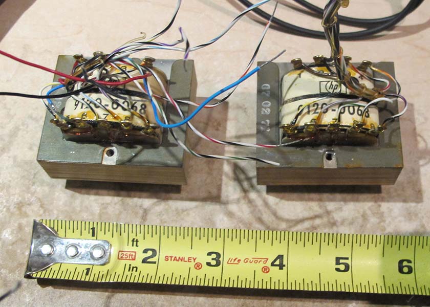

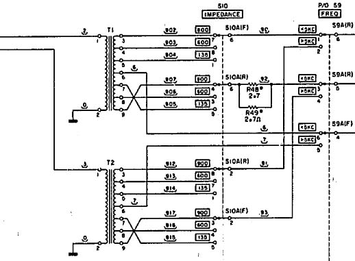

I have a pair of line transformers from an HP 353C patch panel -- should work in the F6 -- you can see the schematic on page 26 of the manual from Agilent's website. I measured them and they are flat from 20Hz to 200kHz. Will send them out, US only, for the price of postage. (Should be $6 w PP fee).

PM sent.
