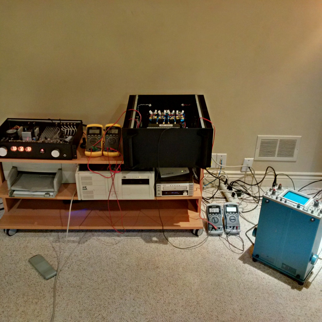

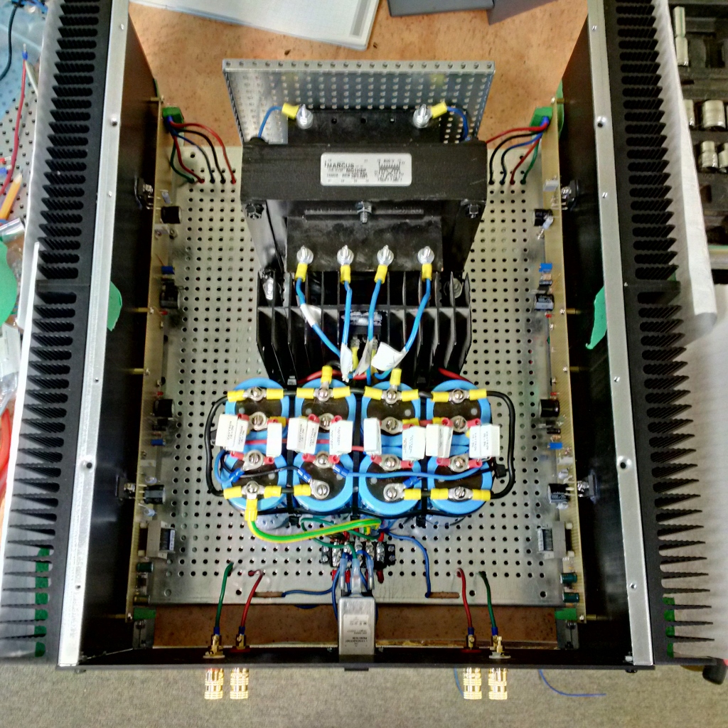

Finally finished the F6 with the Crees biased up nicely approx 975mA. 0V offset running slightly higher voltage do not want to cook them yet.
Burning in as we speak! The sound stage is fantastic thank you Nelson!View attachment 508212View attachment 508213

Congratulations on your successful Cree output F6 startup! I am really liking the amp I built using them. Nice pictures..... Is that a Tektronix 456 B I see? Happy listening!

mikegranger thank you and yes it is indeed a Tectronix scope

I have now rebiased the F6 and took the current up in baby steps at 1.2 Amps the F6 came alive louder and wider sound stage. I'm currently running at 1.425 Amps and the heatsinks are warm but not hot. Takes about an hour for the F6 to come up to this current from cold but very stable. This is where she will stay for the time being as I'm going to just enjoy listening.
