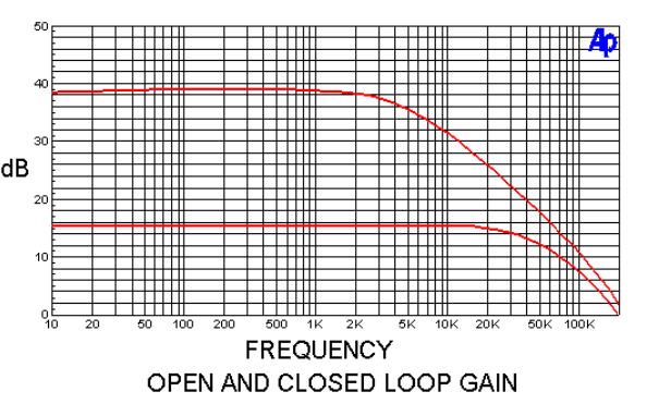

nashbap I had built the prototype with the IRF's and then when testing the frequency response was a little low or so I thought. Nelson explained and showed the frequency response in his article and it matched perfectly.
Then of course Greedy Boyz always want more so when someone mentioned the Crees had lower input capacitance I had to try them to see if would change things. The frequency response stayed the same so a bit more investigating and it turned out as Nelson again said the transformer is the limiting factor.
The Crees also had a lower Rds ON 130mOhm versus 180mOhm and a slightly high current capability.
At the end of the day is how it sounds and to be quite honest there is not that much and I did compare them side by side my opinion was a bit more punch from the Crees but the IRF's had more gain again not enough to cause me to put them in the final F6, the Crees are here to stay!
Seeing needtubes comment after your post the transformer is definitely the limiting factor for frequency response but the F6 sounds so good I'm not going to bother. I now need to build a phono amp.

The frequency response is governed by the transformer not the output devices.
If you want to create something different you'd be better off making a turbo front end. ZenMod and I discussed this already.
If you already have 2sk1530 then use them. Use what you have.

nashbap here is the response from Nelsons article as 2 picoDumbs mentioned the transformer is the limiting factor.
