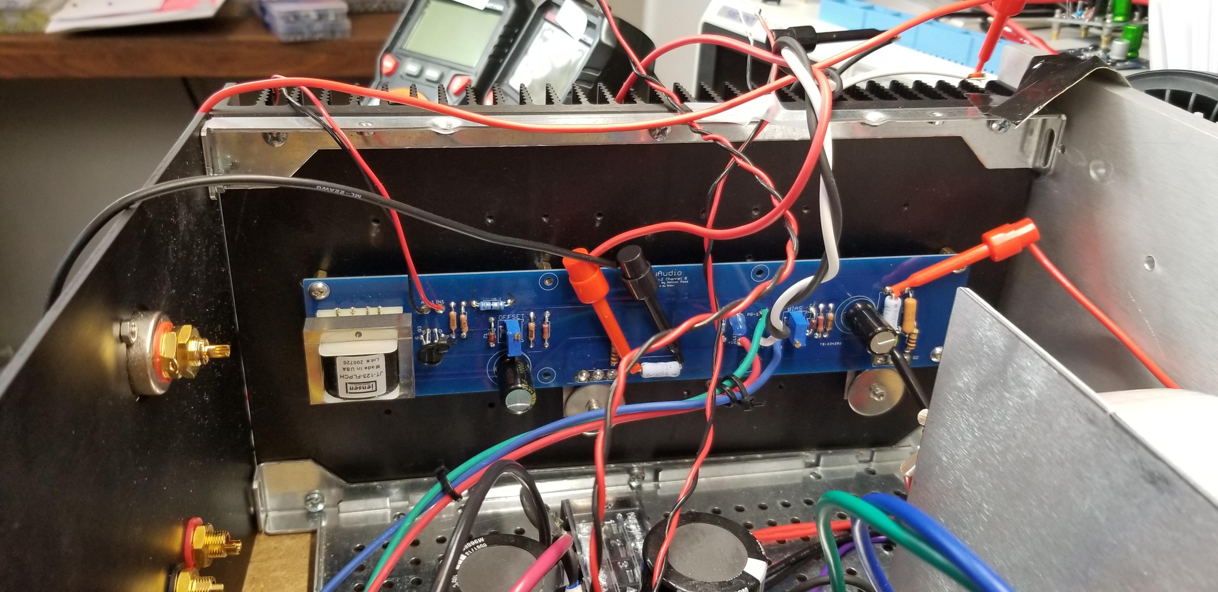

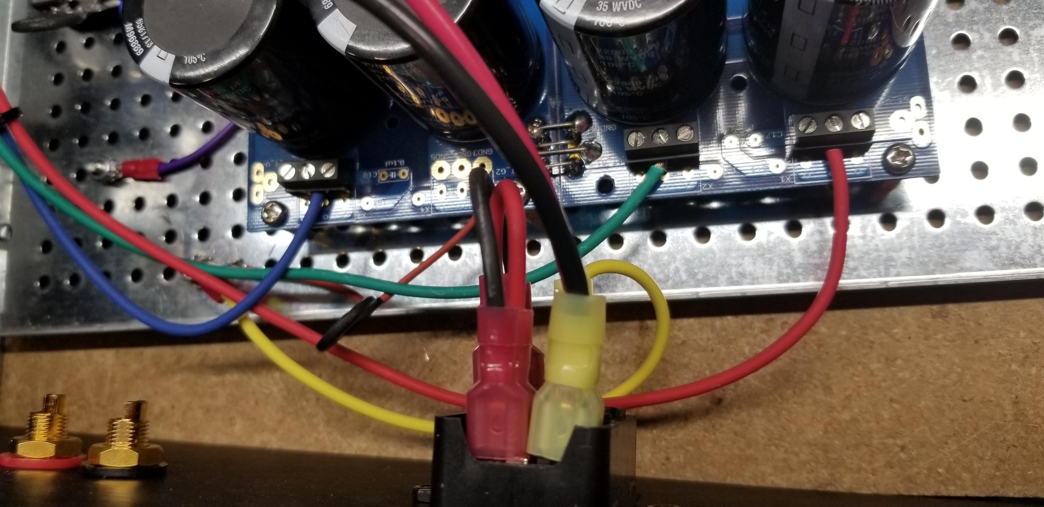

Per the input I received I:
Changed R6 to 47K
Checked all parts
No solder issues with JFets
Checked Mosfets for continuity
Turned on with dim bulb, it faded, but R4 smoked
My readings today:
Bias 0.00 mV
Offset 223.0 mV
R1 46.5 mV
Researching this forum I turned up PJN who reported a smoked R4 in one channel after using the amp for five months. He ended up replacing the JFets as the consensus was they were blown due to high offset voltage. [#500 thru #521].
ZenMod concluded high output offset and suggested to check the JFets out of circuit. It could be that when I first turned on the amp the output trimmer was set way too high and that is when I toasted the JFets? Working hypothesis given the 223.0 mV output reading today the pot is still set way too high?
I can test the JFets and replace as needed.
Is there anything else I should consider?
Thanks for the help as always.

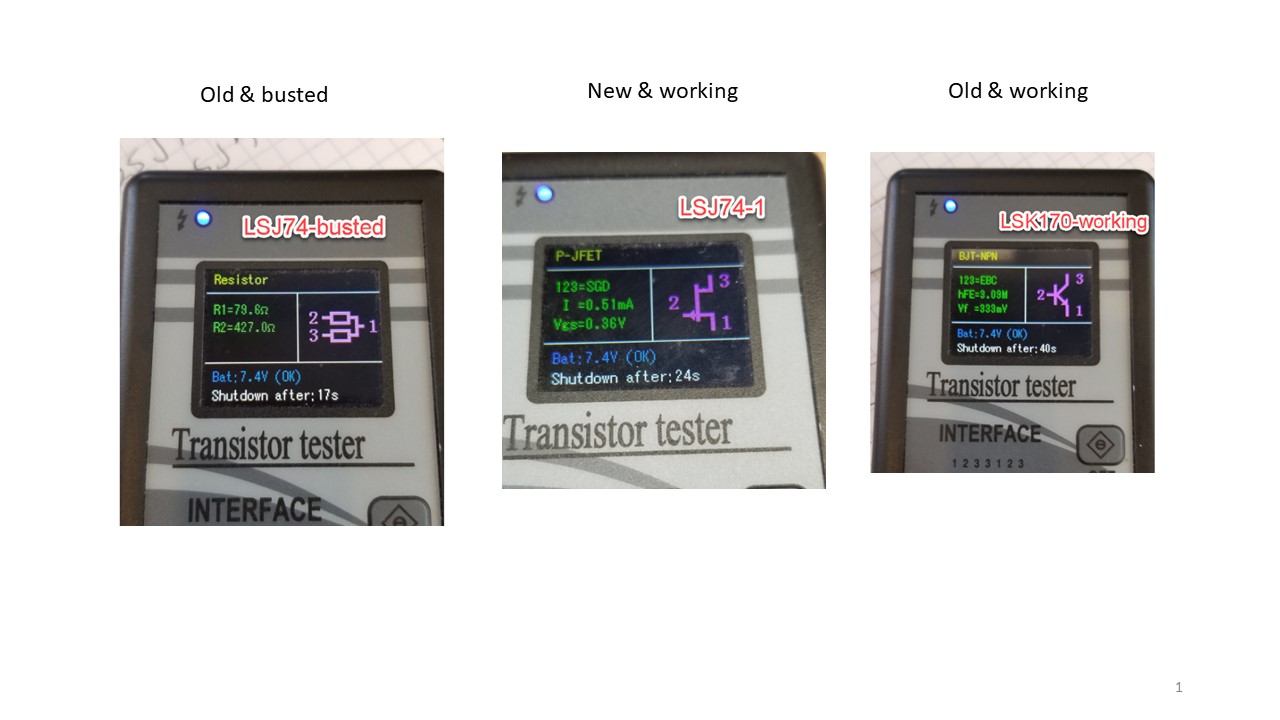

Saturday Update:
I removed the JFets and found one not working properly. See attachment.
I replaced the R4 resistor [again.]
I will put a new set of Jfets in.
And make sure my trimmer pots are set around 1.50 ohms. Is that low enough? Once burned, or twice burned makes me cautious.

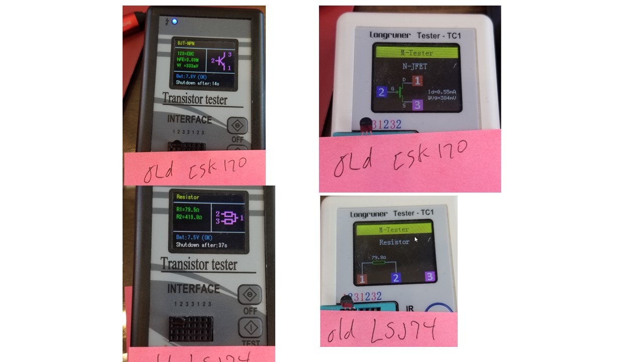

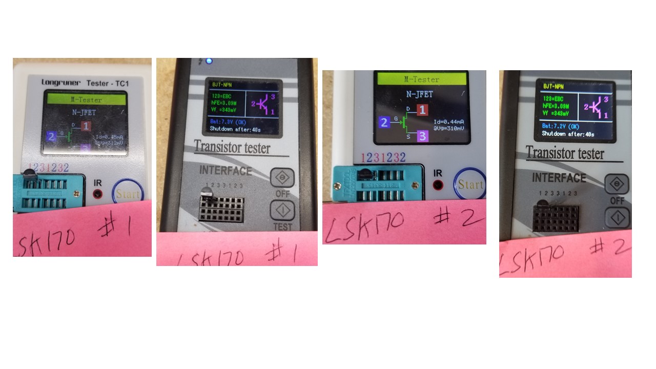

Thanks for pointing that out
Zen Mod,
Is BJT-NPN incorrect for identifying a LSK170 Jfet?
I went back and tested the two JFets with two testers.
The Longrunner tester identifies the LSK as a NJFet. The transistor tester identifies it as as BJT-NPN. Is this tester wrong? I'm confused, as BJT-NPN shows up in searches for the LSK170. I also noticed that the D - G - S are shown reversed in the two testers? Is the transistor tester not accurate?
The same pattern shows for two new LSK170s I tested.
They both miss identify the old LSJ74 as a resistor which suggests that it is bad.

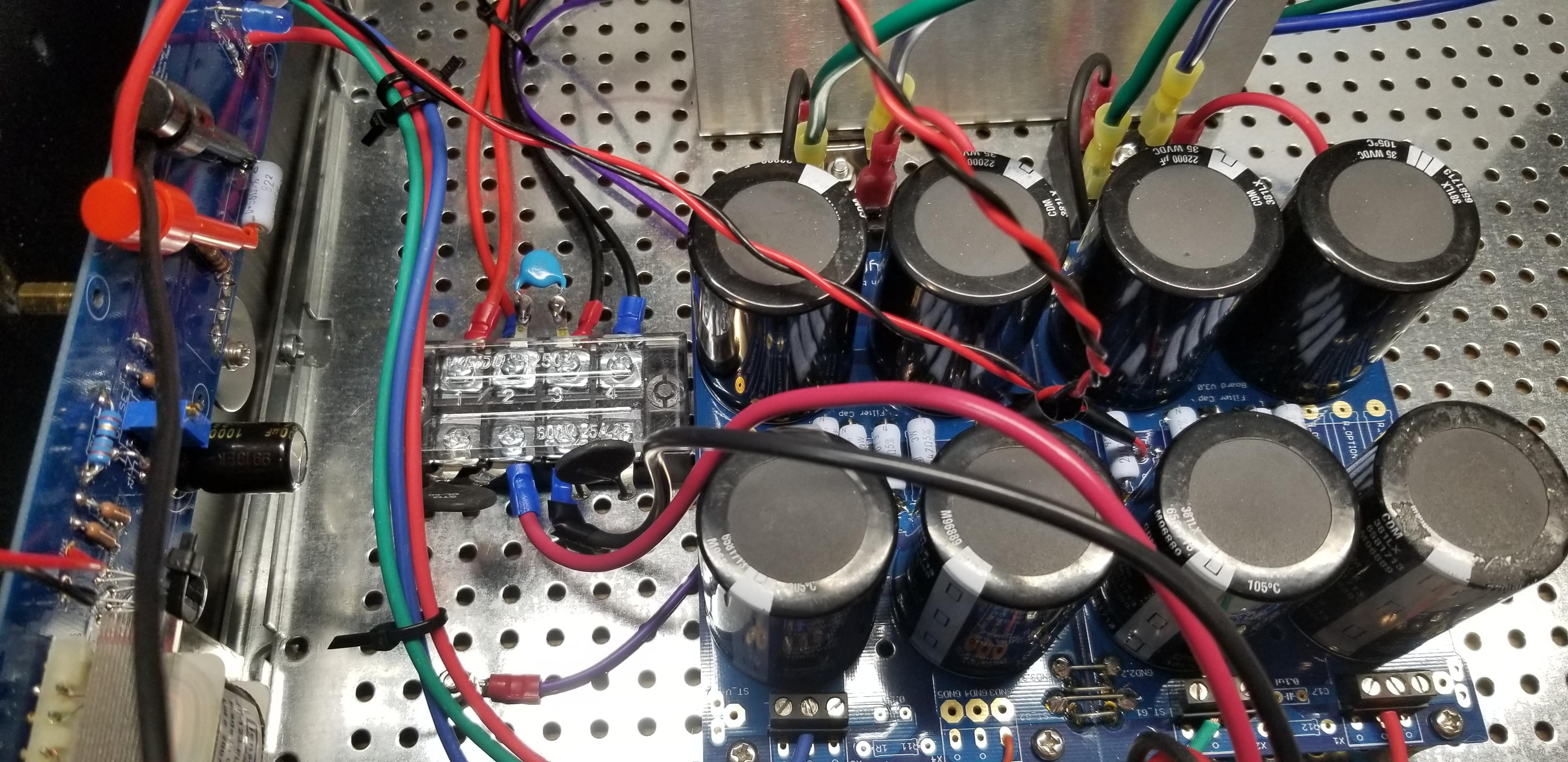

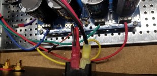

ok. To recap:
I turned on the right channel with a 100 watt dim bulb in place.
The bulb dimmed.
And then R4 smoked.
I fried Q4.
I also had a 47R instead of a 47K resistor in R6.
I think this happened because I had P1 set way too high.
I have now replaced all three pieces and set P1 to 1.145k ohms
and P2 to 1.86 k ohms, so I should not overload Q4.
Before I start up, is there anything else I should consider?
